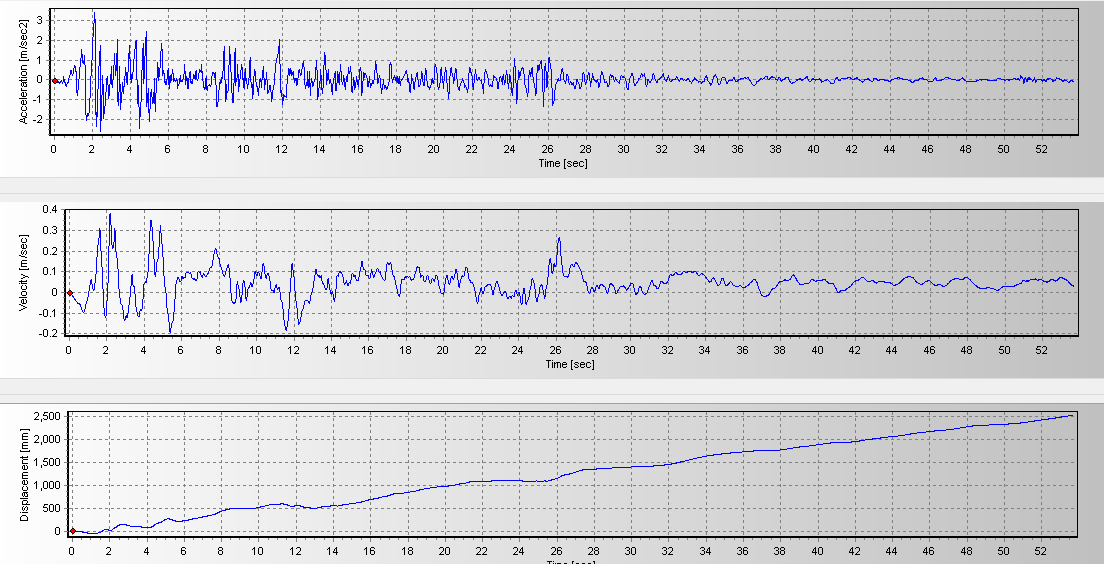

Subscriber,nI used seismosignal software to convert the acceleration data to displacement data as I could not implement matlab code. It gives me different displacement data compared to your displacement data which provided in the previous zipped file. Can you settle this. Please can you tell me how you did the matlab coding and it would be great help if you could send it to me as I need to clarify it. It would be a great help. nAs you can see in the figure highest displacement is around 2500mm. n

SubscribernAnalog signals exhibit offset and drift, which must be corrected in the data.nOffsets are corrected by subtracting the mean from the data.nDrifts are corrected by subtracting the least squares line from the data.nYou can do nothing, offset, drift or both before each integration.nThere are two integrations, so there are 8 choices, and then you can make four more choices after the second integration.nThat is what the vibrationdata GUI makes easy to try out different combinations to get the best result, which is generally that the displacement at the beginning and end of the seismic event is zero.nI did that, but I forgot to type a zero in for the displacement at T=0 in the zip file I gave you. I forgot that Explicit Dynamics chokes on a non-zero value. A different strategy is to use the velocity data as the input to the simulation, because you are allowed to have a nonzero velocity at T=0.nJanuary 29, 2021 at 3:42 pmharsf
