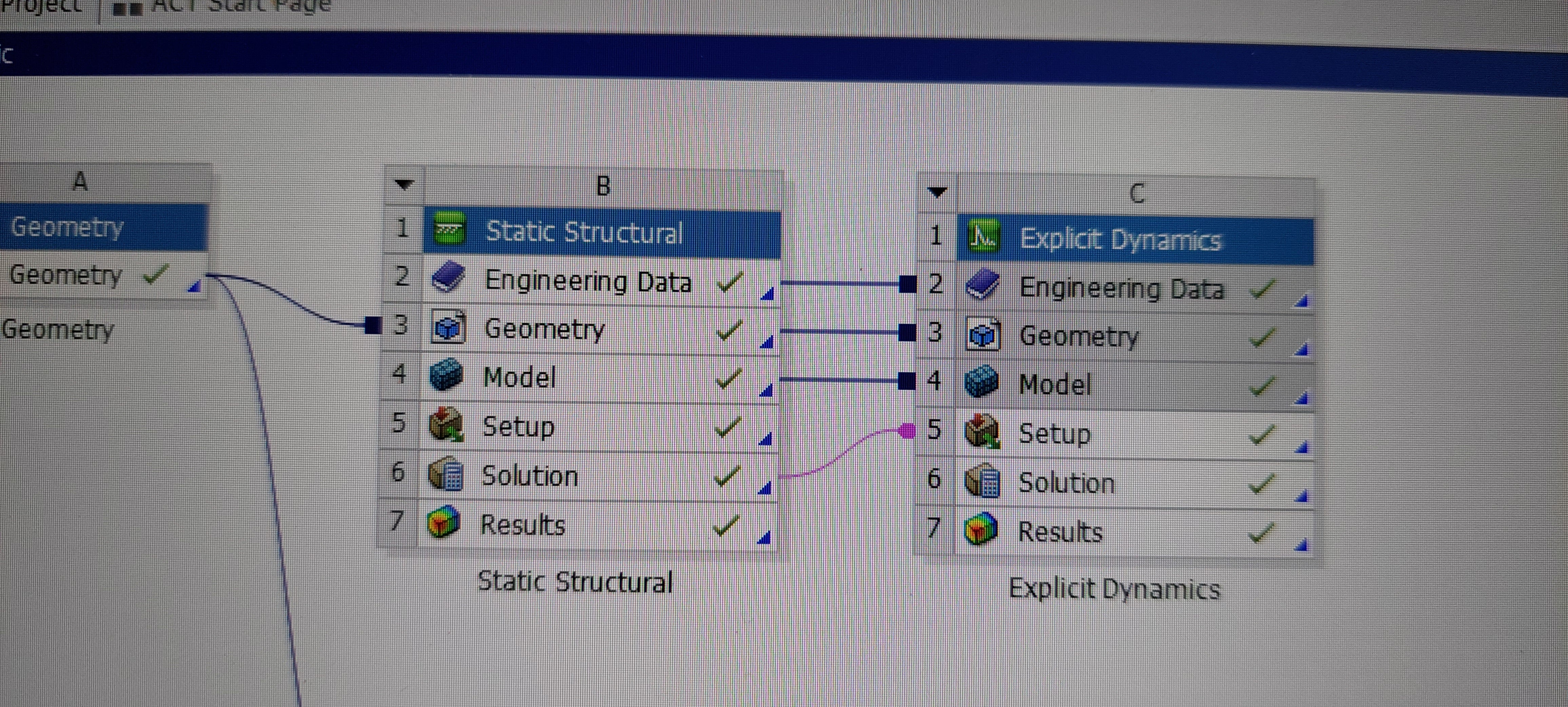

To be frank, my heart is broken trying to set up this analysis.
In am attempting to look at rotary (wobble) broaching in explicit dynamics. Its a machining process that requires complex tool movement. As in, the entire tool moves linearly Z while the shank of the tool runs a circular pattern (not rotation) around Z while the face is fixed along Z. Apologies, my description is poor enough, it may be worth a quick YouTube view.
I slowly mocked it up in explicit dynamics, adding velocity, fixed support etc, but once I add the displacement of the tool shank (to create that circular pattern), it flags a "Could not transfer loads and constraints to the solve" error.
In short, my question is, is it possible. (I assume it is but Ive just not spotted my error)

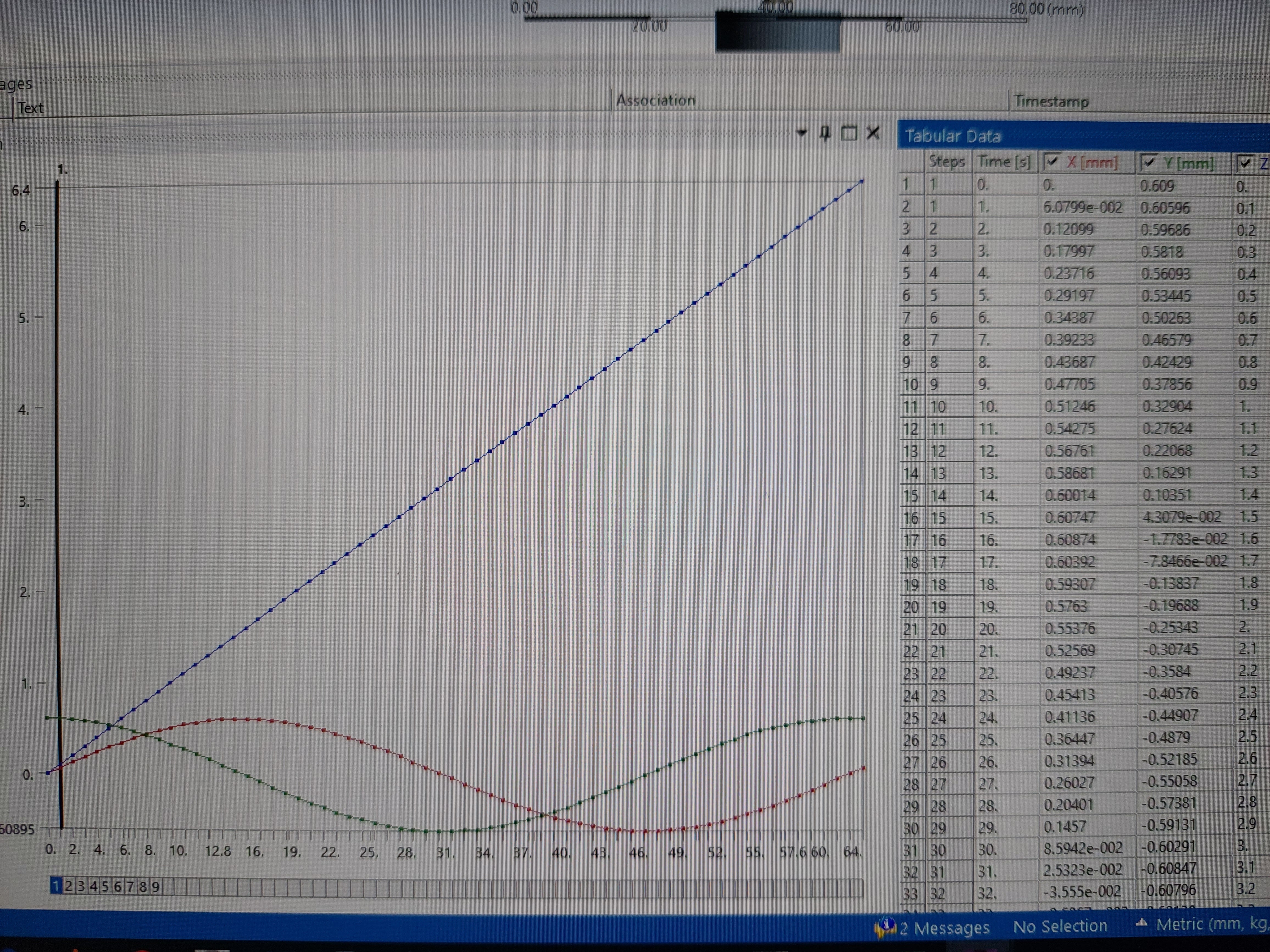

May 28, 2021 at 2:37 pmCJSmith
SubscriberApologies for the vague question. The above is my tool displacement plot, with an additional displacement holding the tool face in Z. It moves perfectly in static structural mock up, but when I bring it into the explicit dynamic space. No joy.
If anyone has any insights, i would be greatly appreciated.
All the best C

June 7, 2021 at 9:45 pmChris Quan
Ansys EmployeeFor the same geometry entity, only one displacement/velocity boundary condition can be applied.
Suggest you using a single Velocity or Displacement boundary condition to describe the tool motion. Tabular data or Functions can be used in the definition of the boundary condition to describe such motion.
For example, you can add the tool displacement in X/Y/Z of all boundary conditions together from the solution of the Static Structural system and then apply them in Explicit Dynamics system as Tabular Data.

June 8, 2021 at 5:29 pmJune 10, 2021 at 3:49 pmChris Quan
Ansys EmployeeSince you mentioned that two displacement BCs work in Static Structural system, you can plot the total displacement of the tool and export the displacement to an excel sheet.
Then in Explicit Dynamics system, you can create a single displacement BC and apply it to the tool, then copy the X/Y/Z displacements from the excel sheet to the displacement (tabular) BC.
