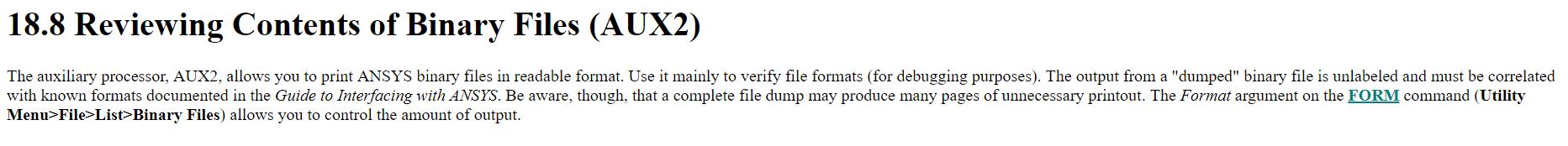

    • Rana Nasser
      I tried to oped the results file, but I couldn't do this because these files are binary files. Then I found the command in the following pic., but I don't know how to use it. Could any one help?
      As I understood from sandeep Sir reply I need to read the results file and then decide which file I want to show its results, is this correct or I have missed his idea?!
