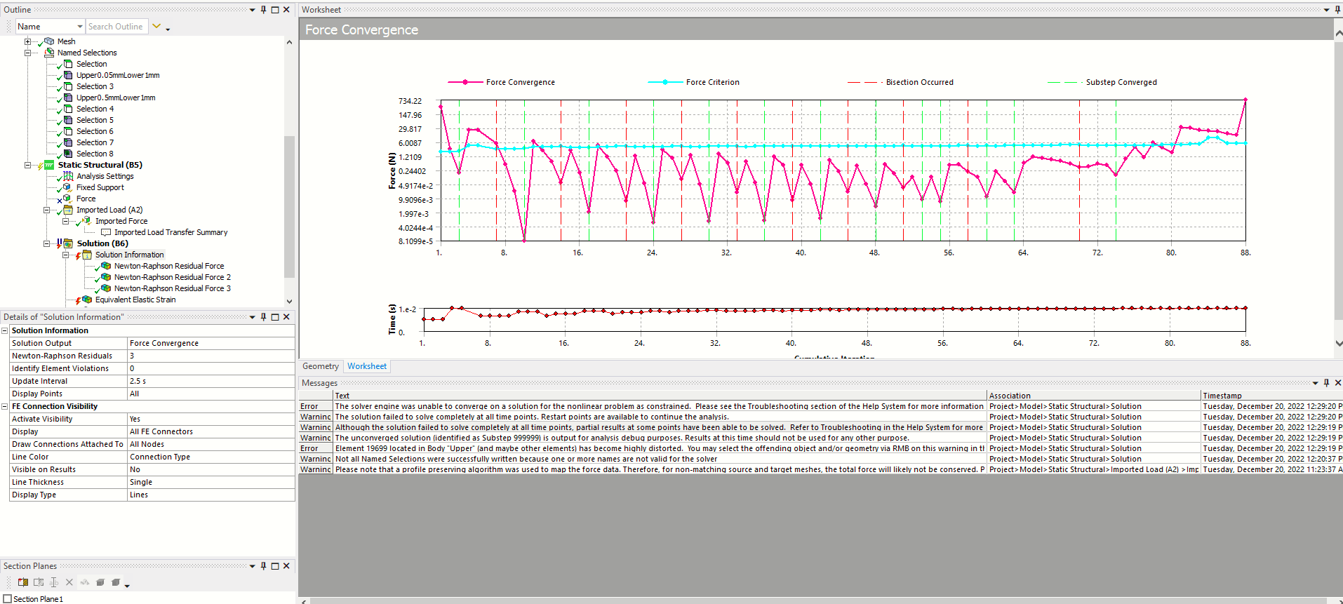

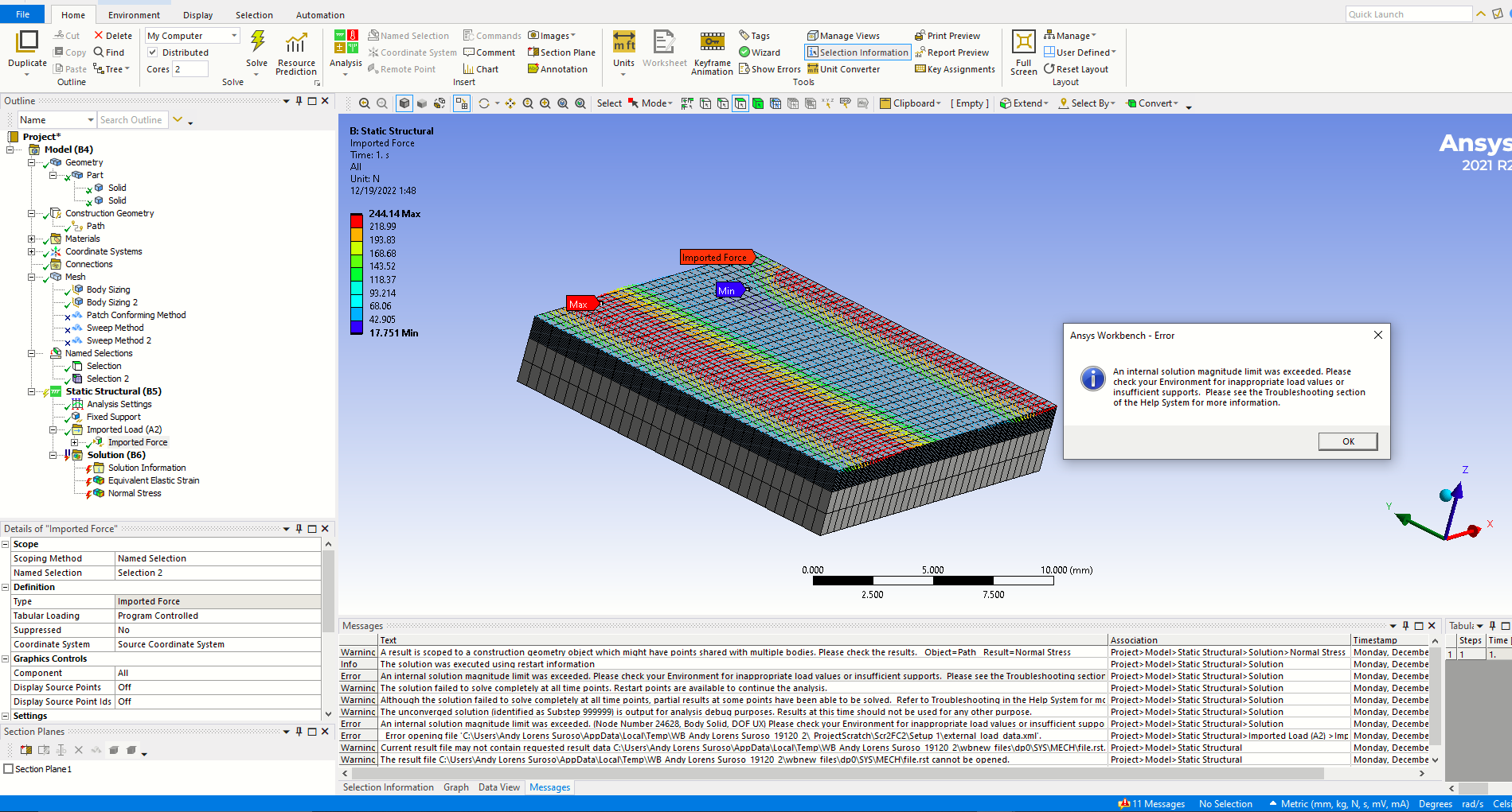

      due to performance im trying to make the meshing of my workpiece become simpler. I tried to make separate mesh  for two different solid bodies combined as one part using shared topology. To the nodes on the surface  i applied some imported force loads. But now when i solve the solution it will come with this error:

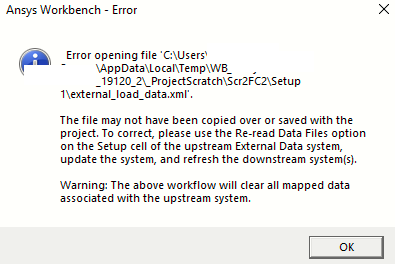

      Seems it's not reading inputs from xml file. Will you please check it;s defined correctly.

        the only xml. data that i have for the project is for adding the material. Could it be a problem from using the shared topology, i formed 2 solid bodies into one part and i use shared topology for combining it. I dont think i need to give another "contact" between the two bodies. For the imported  force load, i exported the nodes number and location from the face to .xls file. Firstly i select the face as named selection and then i used this function "Create  Nodal Selection" from the named selection. I added two force in X and Y for each nodes and then import it again to Ansys using the External data in .csv file.

      The error message indicate at node number 24628 has very high value for UX. This might be an indication of ill-conditioned stiffness matrix and can be due to insufficient boundary condition or improper load defined. Does the analysis runs successfully if you suppress the imported load and apply some other load type, just in case to check whether the isssue with load or contact definition. Does the same model runs fine if you use structural steel from the engineering data library in order to check if it is the issue with material modeling. You can also try with unshare topology option in spaceclaim and see if with automatic bonded contact creation runs fine with imported load.

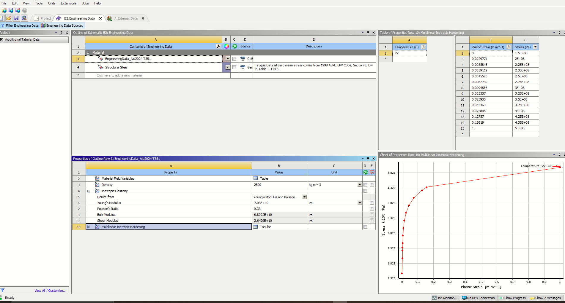

        I setup the initiap substep=200, min substep=25, max substep=10000; Large deflection = On;

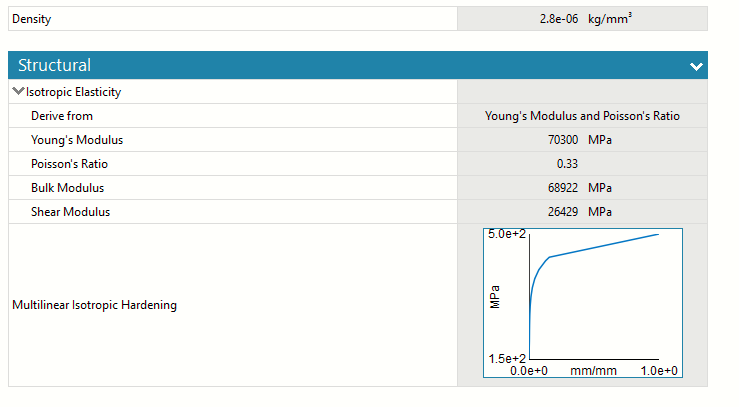

        Here is some data of the alu that i use:

      one of the error message tells that element 19699 from upper body is having high distortion. Will you please check how is mesh over there. My initial suspect is either material modelling/ meshing issue (Upper body part).
