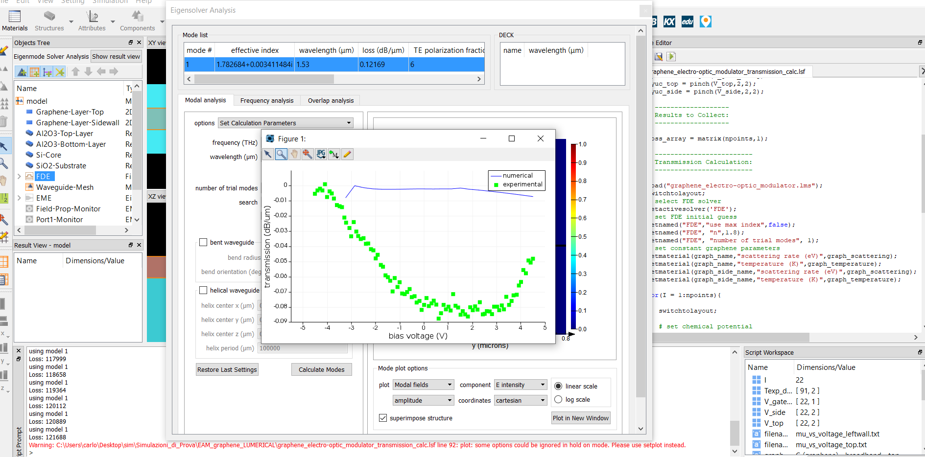

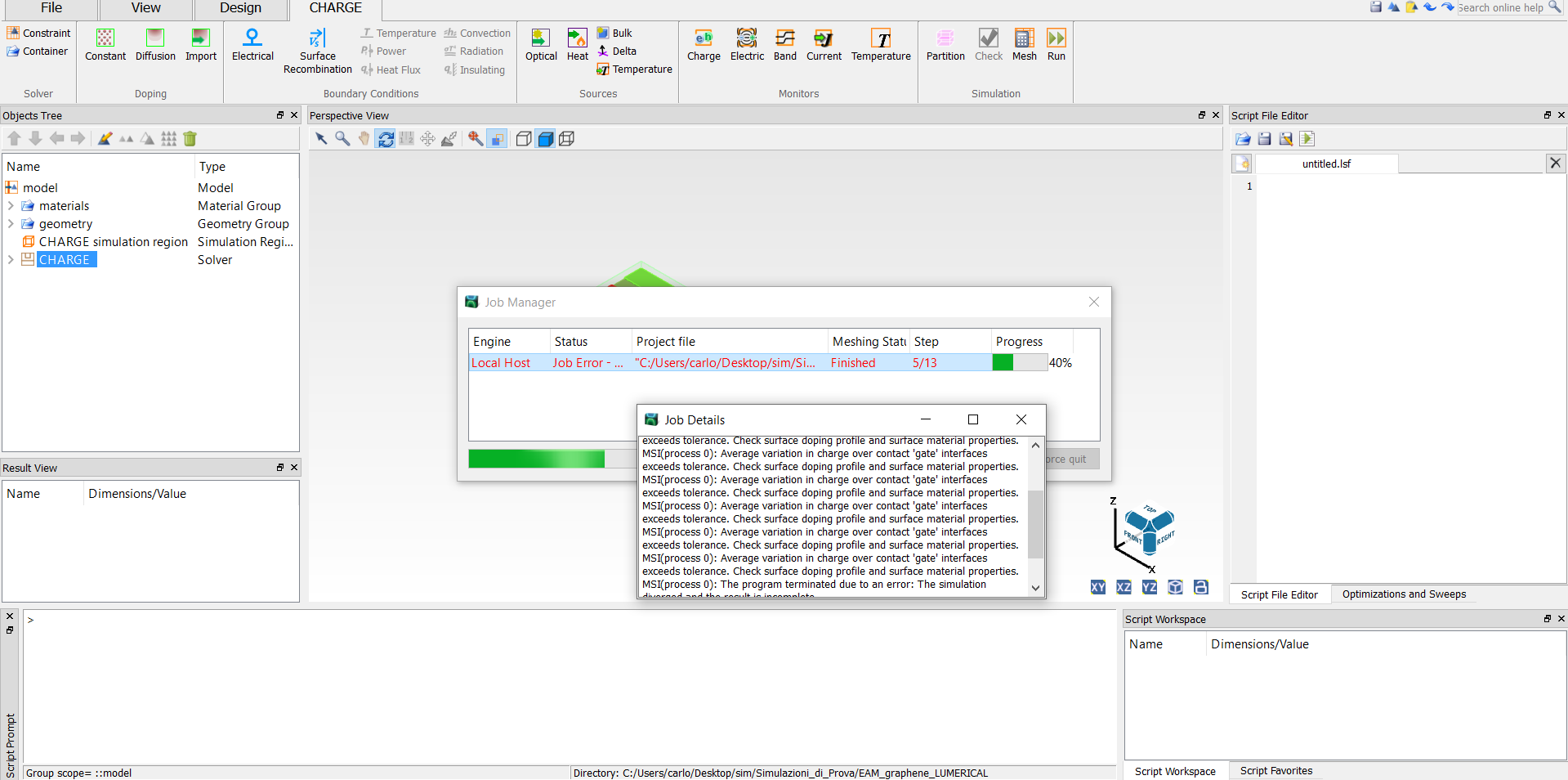

      Yes sir. When I run the code graphene_electro-optic_modulator_1, I have the following error:

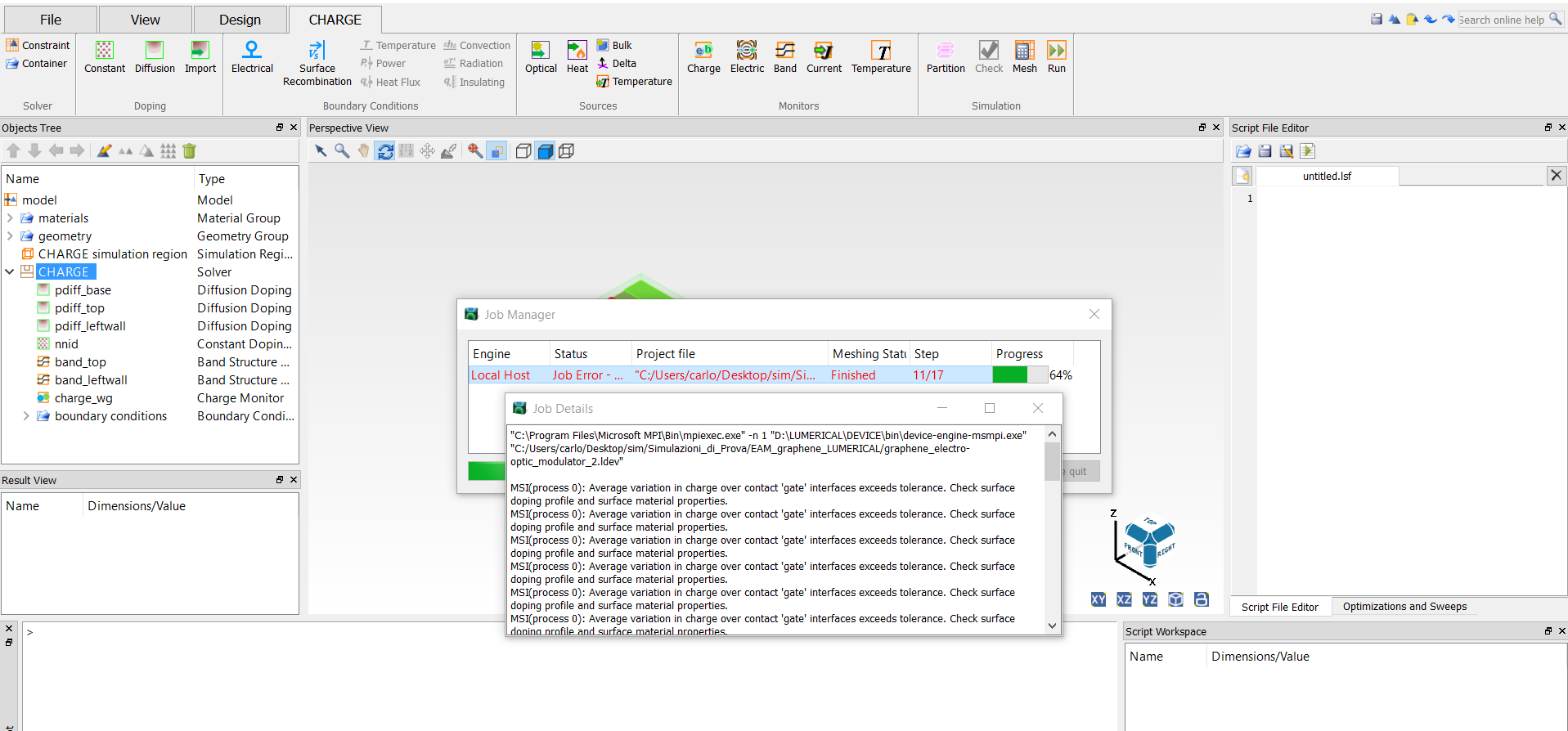

      When I run graphene_electro-optic_modulator_2, I have the following error:
      The same of the first one. After getting the simulation data using script get_top_Ef_data.lsf and get_leftwall_Ef_data.lsf, running code graphene_electro-optic_modulator_transmission_calc.lsf I get the following result:
      Simply put, I can't get your results.

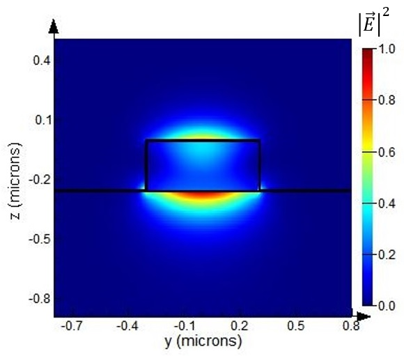

      Moreover in the article it is stated that the guide is single mode, but actually performing the simulation with FDE more modes appear. How is this possible?

      Thanks for posting this. I tested the example and can confirm thereÔÇÖs a geometry creating issue in the version 2021 R2.1 when running the CHARGE project files. We recommend downgrading to previous major release 2021 R1.x. I tested the example in 2021 R1 and it works in that version. Sorry for the inconvenience.

      Regarding the mode, we indicate the mode that the device has been intended to operate for:
      This is the mode the consequent calculations and derivation of transmission is based on.

      I tried to do what you said, but I still have the same error:
      "average variation in charge over contact 'gate' interfaces exceeds tolerance. check surface doping profile and surface material properties "
      By changing the thickness of the graphene and varying the fit parameters, I still have the same error, but the simulation tends to go little further
