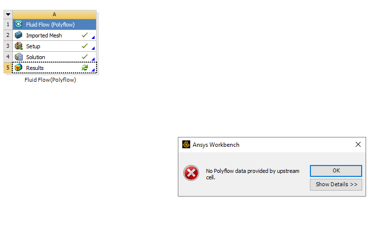

      I am doing example 38 of the ansys polyflow learning.
      I am getting this error message even after following all the steps
    • Nikhil N
      Please expand the error message by clicking on 'Show Details' and share the screenshot here.
      Meanwhile, you can try this: Add a stand-alone 'Results' component and connect the 'Solution' cell to the newly created 'Results' cell. See if that works.
      Thanks!
      Nikhil
    • jishnu94.deu
      adding a new result cell worked ! thank you
