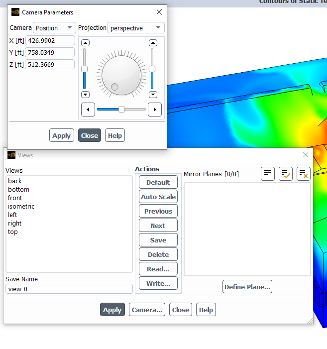

      I am trying to get the exact same screenshot between 2 models. The geometry is the same except a few different parts. I tried using camera parameters and copying the exact coordinates between the 2 models but the the image is always slightly off. The screen I am using is the same, is there something I am missing?
    • Keyur Kanade
      Here select Save. It will save view-0 under views. Then Write this view as user.view.
      Then in second Fluent session Read this user.view.
      Regards Keyur
    • lnez
      Thank you, worked perfectly!
