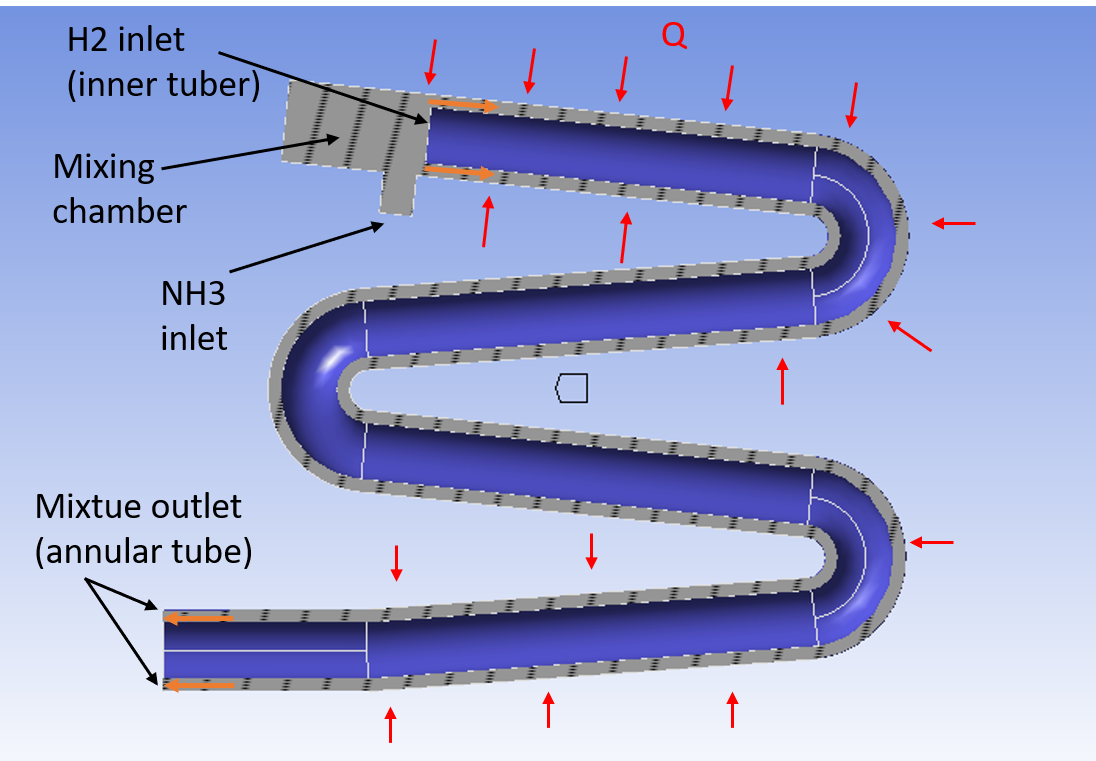

      Hi everyone, I am trying to simulate the evaporation of Ammonia (Nh3). A tube-in-tube evaporator was designed for this simulation with 2 inlets and an outlet, where ammonia liquid enters the expansion chamber and mixing with hydrogen. I choose the mixture model with 3 phases as multiphase model upon the details providing by Ansys theory guide.

      P_total = 25bar
      Boundary conditions:
      Nh3 inlet: Velocity inelt 1m/s, T= -33C
      H2 inlet: Velocity inlet 5m/s, T=-5C
      mixture outlet: Outflow
      Wall: Convection: 20 W/m^2.K, T=10C
      Time step size: t=0.0001s
      Number of time steps: 250
      Max iterations/time step: 10
