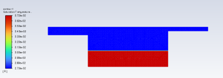

I have written a UDF to calculate the saturation temperature of water vapour for use with the Lee model of evaporation and condensation.

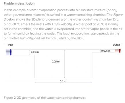

The problem I am testing the UDF on is:
The primary phase is a mixture of water vapour and air (initialised to mass_fraction_air = 1 at inlet), and the secondary phase is liquid water, patched into the tank as indicated by the region with t_sat = 372K in the image below.
The saturation temperature (and therefore the UDF) appears to be appropriate at all points in the domain upon Initialisation:

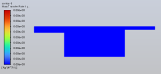

However! I am not observing any mass transfer, and for the life of me can't figure out what's amiss. Even with significant run-time (the simulation is, of course, transient), the saturation temperature throughout the domain remains unchanged, reinforcing the fact that no mass transfer of water vapour has occured!

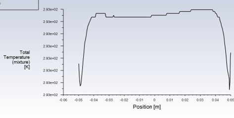

On a physical basis, there should be evaporation in the interface region from the get-go. The entire problem domain is initialised to 20degC (293.15K), and there are cells in the interface region with a non-zero volume fraction of liquid water (secondary phase) at this temperature which is above the saturation temperature in those cells.

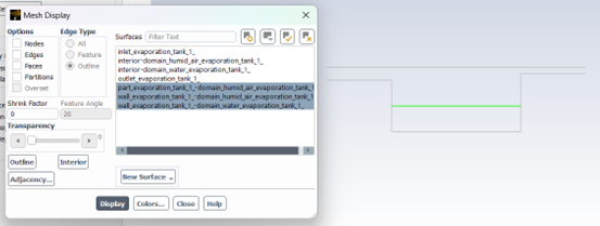

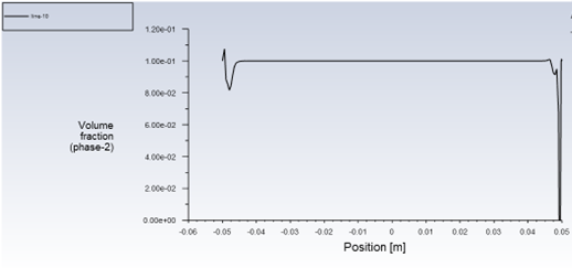

To demonstrate, along a horizontal line near the top of the interface region, the volume fraction of water is ~0.1,
the saturation temperature is ~283K,
and the total temperature (mixture) is 293K
yet there is no mass transfer!

Forum ModeratorIf you add the phase change values into a User Defined Memory: what values do you see?Â

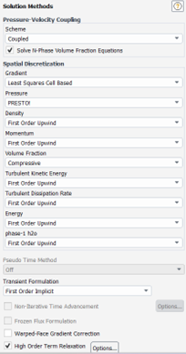

SubscriberThese are my solver settings:
I have also experimented with adjusting bubble diameter of the secondary phase, and ensured that the phase and species IDs match up with those specified in the UDF.
I have checked that the simulation works when using t_sat=constant (373K) with sufficiently hot inflowing air. There is still no evaporation (mass transfer coefficient zero), even after significant run time. This is suggesting there is no heat transfer taking place between the primary and secondary phases.
Only when I intitialise the entire domain at 383K, with saturation temperature constant (i.e. no UDF hooked), is there evaporation at the interface!

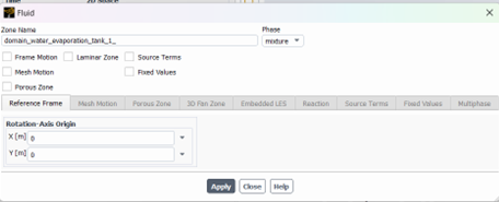

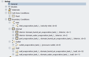

Forum ModeratorI think there's a mass transfer value somewhere, so you can see mass evaporated/condensed in a step. With UDFs there are a few places you can go wrong, so it's possible the UDF is trying to move mass from one phase to the other (according to your model) but the hook up isn't correct so nothing happens.Â
If you need that high a temperature, check material properties. Also, please confirm what boundaries you have inside the domain: how many fluid zones are there?

Forum ModeratorNo interface or wall & wall:shadow pairs so that's good. Â
