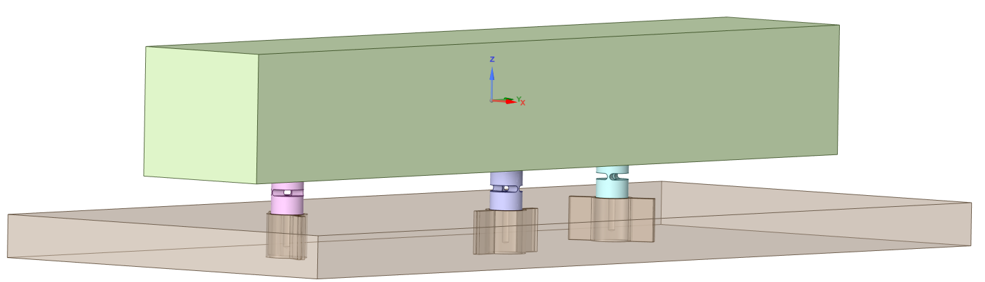

First of all, I want to say that I am a beginner in FEA and in ANSYS, and also that I could not find an answer in the forum, and that is why I am posting.
So, I have an assembly which consists in a Silicon block attached to a Aluminum frame with some hinged pads in between. The block is submitted to a Heat Flow that will heat it up, and the frame has flexures in the contact region to accommodate the block expansion (pictures below).

I managed now to represent the free expansion of the silicon block solely, excluding the other parts from the model. So I guess that my error is somehow in the contacts and/or the boundary conditions, but I have tried a few different options here and still no success.

April 27, 2022 at 11:25 pmpeteroznewman
SubscriberYou can apply a uniform temperature to the silicon block in a Static Structural analysis, you don't need Steady State Thermal to apply this load, though when you are studying heat flow through the flexures you will want that.
Please show the material properties for the silicon material. What value have you used for the Secant Thermal Expansion coefficient?
From what I can see in the image, there are three hinge flexures. That is not an ideal flexure system to have a practically strain-free expansion of the silicon block, as you will see when you get the Static Structural model working.

Oh, I didn't know that I could apply a thermal condition directly in Static Structural, but now I saw this option indeed. Is there any difference in applying Temperature loads in Static Structural instead of in Steady State Thermal?
And I am so embarrassed now, because I didn't have enter the expansion for the Silicon material, for some reason I thought that Workbench had this information already. I added a tabular data from literature for a quite large range of temperatures now, and the simulation started to behave as I was expecting. I guess now it's a matter of refinement. I am so sorry to bother you guys with such a rookie mistake!
Also, regarding the design, the flexures that are supposed to handle the thermal expansion are those in the Aluminum frame. They won't allow free expansion of the Silicon body, but they are oriented in a way that should keep one specific point in one of the faces in position while the rest of the body deforms. The hinged pads (cylindrical parts) are actually to compensate any machining errors between the parts (and to a certain extent it emulates a spherical joint when combined with the flexures in the frame). But if you have suggestions you would like to make, please feel free to do it.
