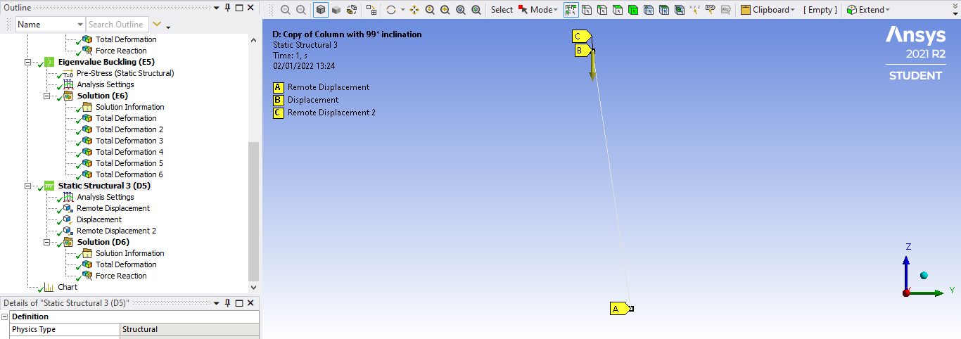

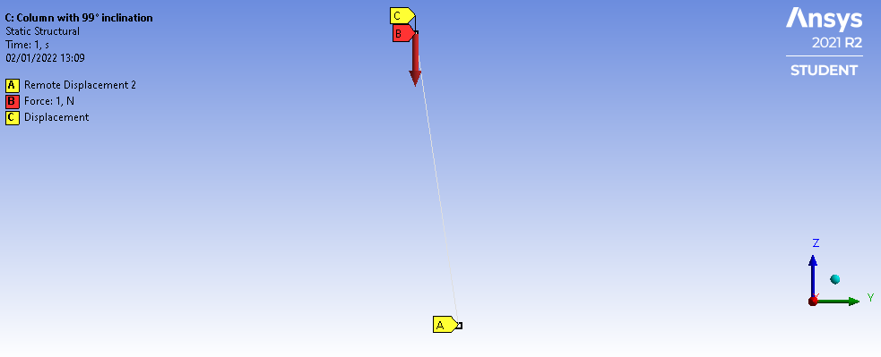

Subscriber- Linear buckling analysis is done.
Model Setup: Column as beam element. Pinned condition both ends.
January 2, 2022 at 10:51 pmpeteroznewman
SubscriberWhen comparing a Linear Buckling model with a Hand Calculation, the Force should act along the center of the beam. This model shows an angle between the force and the beam axis. If you make the force along the beam axis, you should see the ANSYS result match the Hand Calculation value exactly.
In the nonlinear model, the knee in the displacement plot is the time at which buckling occurred. Match the Reaction Force at that time to report the Buckling Force.

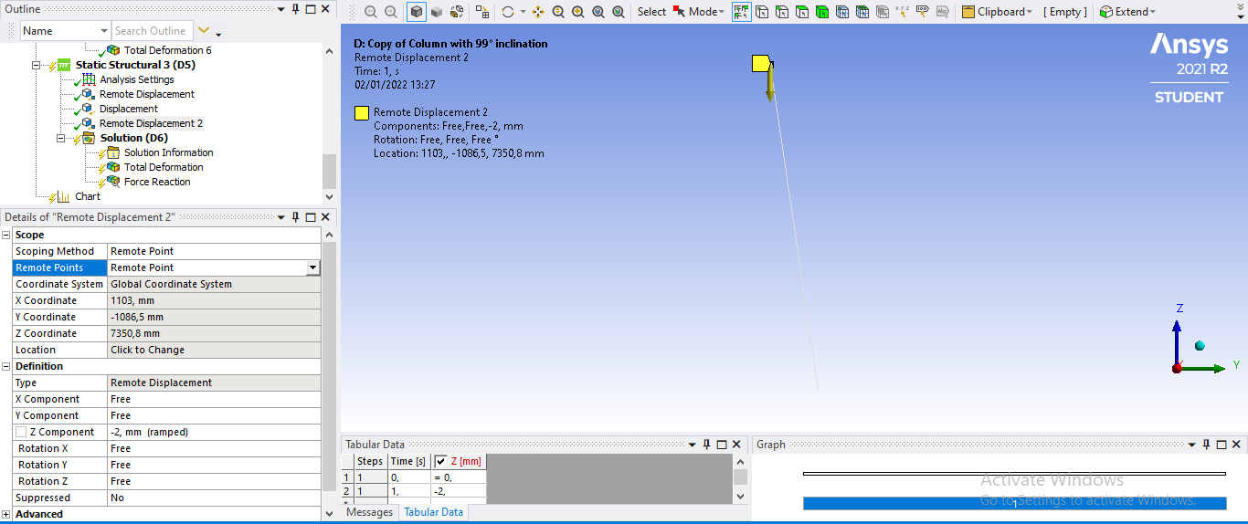

In the nonlinear static analysis, what is the purpose of applying 2mm vertical remote displacement in the y-direction? 1mm offset is provided in the x-direction for imperfection. I get this point.

I have applied the same thing in my Non-linear analysis setup: But I am not sure about the purpose of applying the 2mm vertical displacement.
Why not apply 1mm displacement.?
Why not apply the buckling load ( force * load multiplier ) which is obtained from eigenvalue buckling analysis. ?

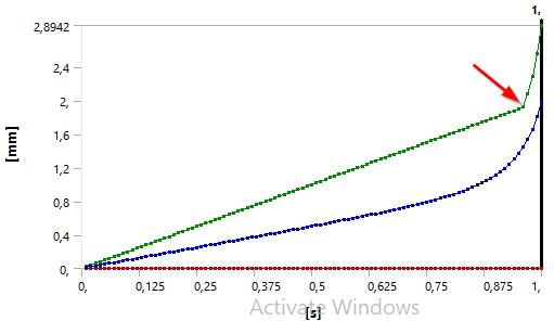

In this result, in the nonlinear model, the knee in the displacement plot is the time at which buckling occurred.
The knee is representing that after this time the displacement will be non-linear? i.e the column will buckle.

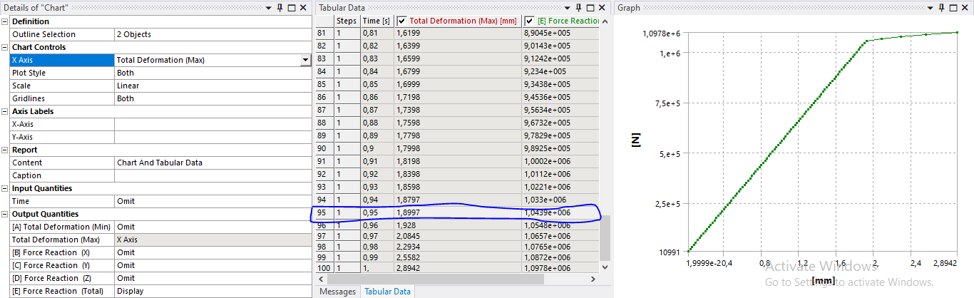

I have created a chart between displacement and force reaction. according to this chart, the buckling load will be 1,0439e+006 N?
From my understanding, the displacement is increasing rapidly after this time. That is the reason it is a buckling point. Is this reason?
Eigenvalue critical buckling load =1,1781e+006 N
Nonlinear buckling load = 1,0439e+006 N
The difference in the result is big. Is this a reasonable result?

SubscriberApplying displacement instead of force provides easy convergence and so long as no additional constraints were used is equivalent to the force.
2 mm is appropriate for that model and seems to be good for your model also. At 1 mm of compression, the column has not buckled.
Around 2 mm of compression, there is a sudden increase in the rate of lateral deformation, which is the definition of buckling.
The nonlinear buckling load should be less than the Eigenvalue critical buckling load and the difference is only 12%, which sounds reasonable to me.
I expect if you cut the 1mm eccentricity in half, the nonlinear buckling might go a little higher, but you will have to pack in lots more output points to catch it precisely.
