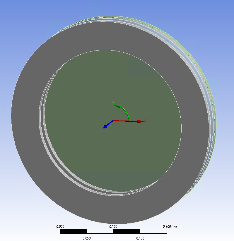

You could insert a normal strain result and then change the coordinate system to the cylindrical one. Then you change the axis to Y and you will get the strain in tangential direction. I hope this is what you want to do? Also you can choose nodes(cntrl+N) at the desired location, right click>named selection and scope the normal strain result object to this named selection. This way you get the normal strains in tangential direction only at the selected nodes.
Regards Ishan.
May 6, 2021 at 8:43 amfilipjohansson
SubscriberHey Ishan thank you kindly for your reply.
the combination with named selection at the cylindrical "global" coordinate system is exactly what I was trying to accomplish.
The average values in 5-10 surroundingnodes get close to my strains in the x-direction from the 10 different coordinate systems so both methods seem to work. I do, however, still not get the results I was expecting, so I might need to look into my boundary conditions and the way I apply the forces.
Again, thank you. Now I know my method of finding the results wasn't useless.
