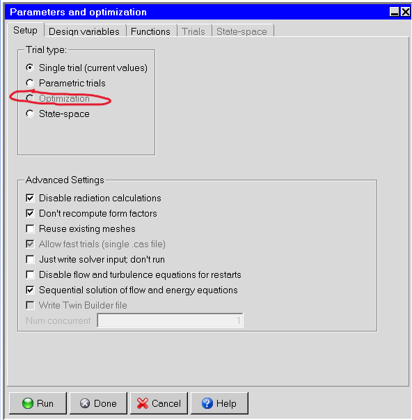

      We're seeing some issues with students unable to use Anysys ICEPACK. We're either seeing an error like Warning: you don't have an "ice-opt" license feature-disabling optimization or and we're seeing the optimization button in the parameters greyed out like in this screenshot.
      Are any adjustments or special configuration instructions users may need to use it or is it that our campus license doesn't support this tool?

      Good morning, this is the first thing users see in the bottom left pane when in the icepak tool
      ice-opt license issue
      the issue they're facing is optimization is greyed out in Solve > Paremeters and Optimization
      I then found this KB https://ansys13.ansys.com/KnowledgeArticles/Phase-3/2052070/2052070.pdf which states Optimization is an ADD-ON feature for ANSYS Icepak as well as for Design Exploration within Workbench. To use any of these optimizations option an additional license feature is needed. However, the same ADDON feature will work for both Icepak and Design of Exploration. I'm trying to figure out if University of Texas at Arlington Licensing supports this feature so I was hoping to speak with our account rep, who I also emailed but haven't gotten a response.

      Hi Kyle,
      What's the name of your AM/AR, I don't see any "ice-opt" increments over here ProductToFeatureMap-2025-03-10.pdf ?
