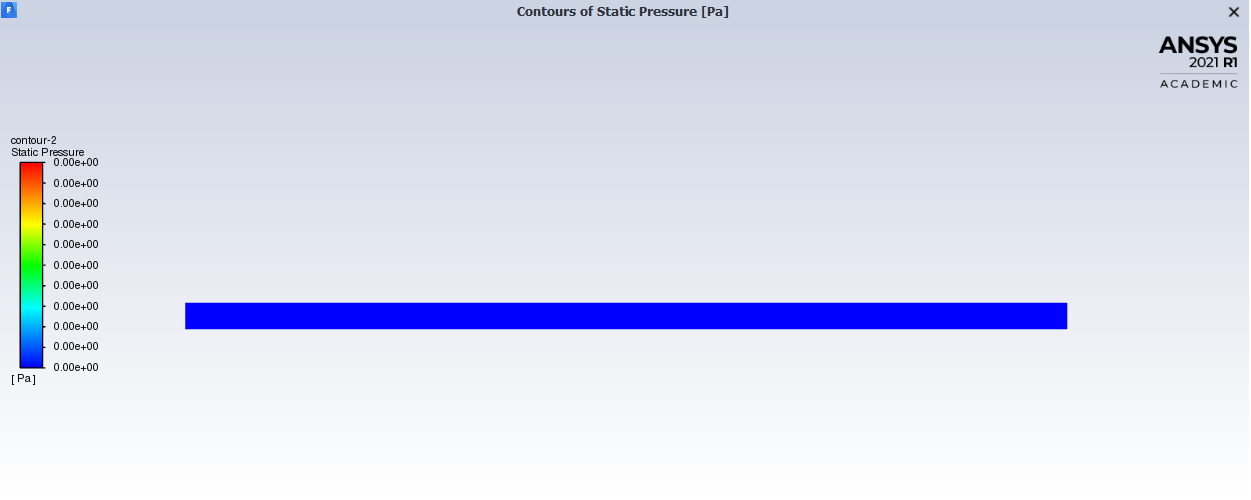

I performed the Sod shock tube simulation and the simulation worked successfully, but by checking the contour it comes empty as illustrated below:

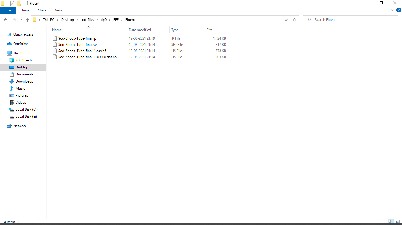

Can you please check in the WB folder to see if Fluent is writing out the necessary files and let us know? Thanks.

AdministratorHello It also looks like your simulation diverged. Please double-check your model set-up.

August 13, 2021 at 5:16 amAbubakar
SubscriberI did not modify the setup I directly ran the setup (final_case_setup) provided in the Ansys innovation course.

August 17, 2021 at 12:54 amKarthik Remella
AdministratorHello Start from the initial case & data file and try running the simulation. This is a transient simulation and it would only have the data from that time-step. Please re-run the simulation from t = 0.
Hope that helps.
