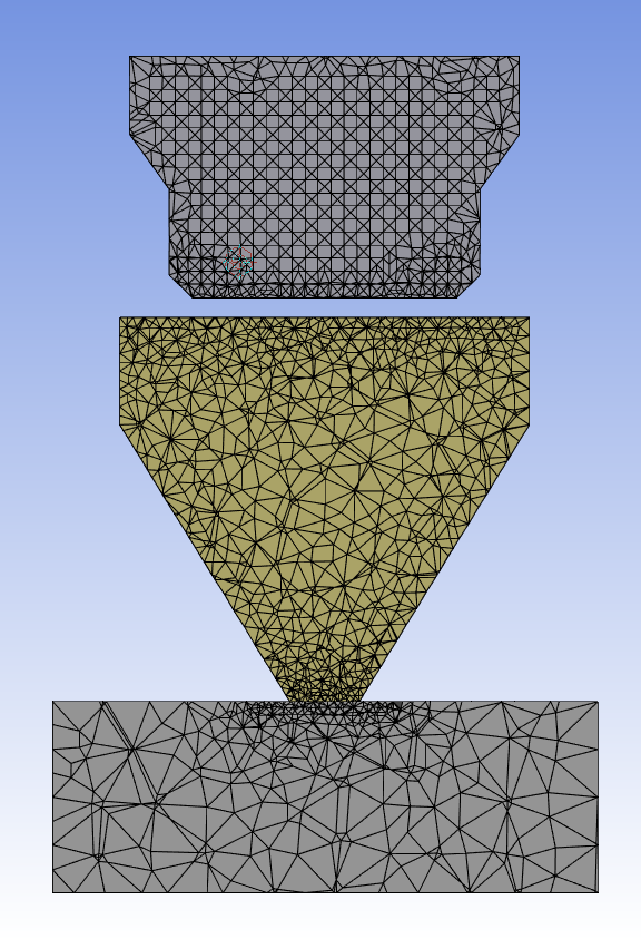

      I created a mesh in Ls_dyna's WORKBENK and imported it into the prepost.
      I created a mesh of Patch Independent tetrahedrons.

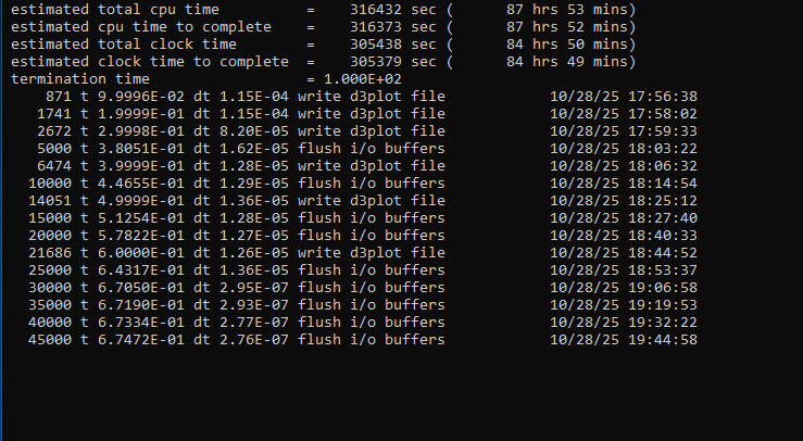

      Now if my bodies have SECTION ELFORM=1, I get an infinite division of timesteps:
      Is it because of the mesh?
      If I set ELFORM=10, it starts working on some models. And on some, everything also goes into endless division.

      It seems currently there are some issues with SPG and or contacts etc. at the moment (you have opened up many posts in a couple of days) – it is hard to fully resolve these without looking at a model and the settings used.
      We would like to help so please send the licence number or TECS nr., together with a NON export controlled model, via a support ticket (ACCS system), or if you are supported by a channel partner in your region send it to them, so we can help you with this issue.
      Alternatively if your have an academic licence let us know (say which University it is related to and department) and so we can try and help further here.
