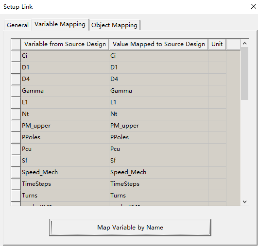

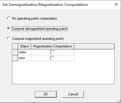

      I have two models, in the 1st one I set demagnetization calculation as below.

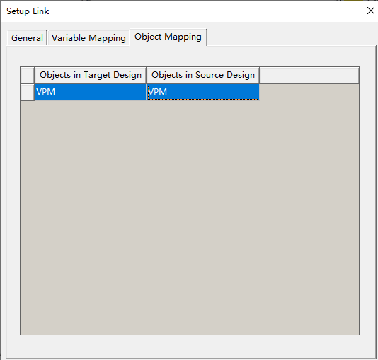

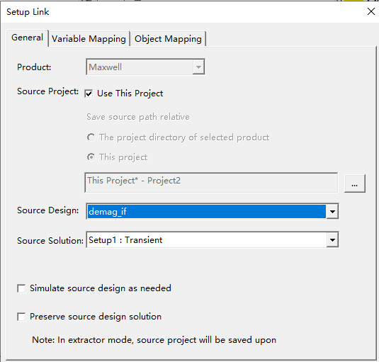

      In the 2nd one, I wanna link portion of my PMs with the 1st one, I used object-based permanet magnet field, but it didnt work, as below.
      Error said like this:

             1). Please do not use Onedrive (like document folder, etc.) or other shared network to save project file, and save the model to a local drive.
             2). Do not use a long name or lonag path as the project name.
             3). Please check if 1st model is solved.
             Thanks.
