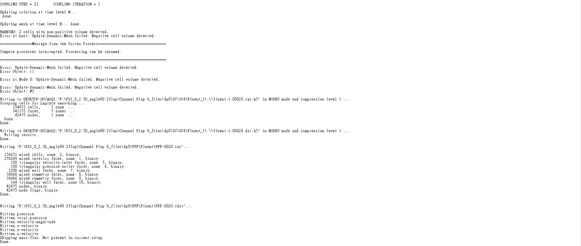

Ansys EmployeeHi, Please check the transcript file (.trn) to get more clues
April 23, 2025 at 11:00 am
April 23, 2025 at 11:57 am
abhishek.roy

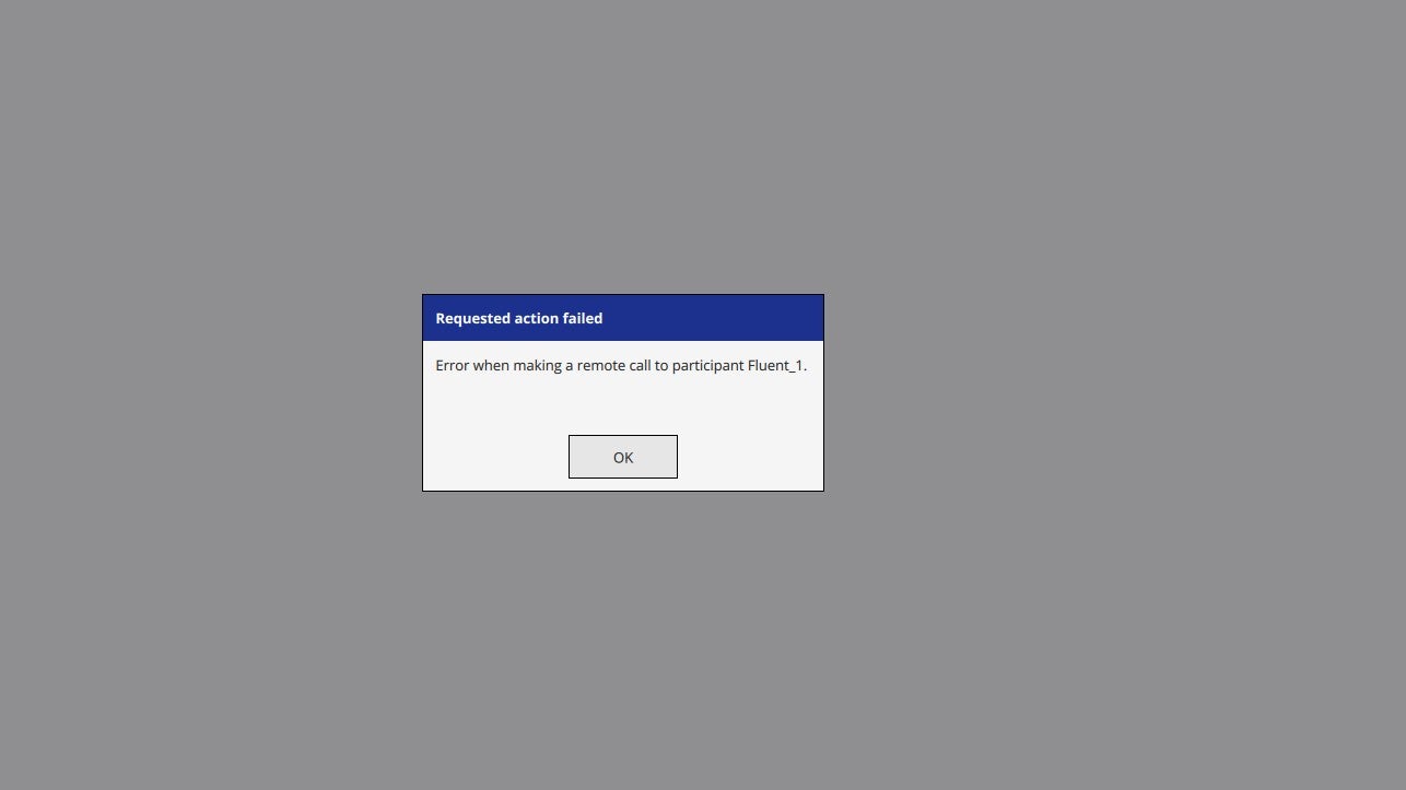

Ansys EmployeeI can see the error: Update-Dynamic-Mesh failed. Negative cell volume detected. Check your dynamic mesh setup. Try reducing the time step
April 26, 2025 at 11:01 am
jimbo
SubscriberI have confirmed that the dynamic mesh settings smoothing and remeshing are both turned on, but the time step size still has negative volume. It often gets stuck at coupling interval3 and convergence fails. I wonder if there are other settings that can solve this problem. Thank you.
