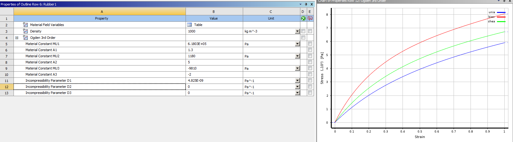

When I use the Rubber 1 material (As seen below) given in Engineering Data Sources the model runs without any errors. It is a third order Ogden material.Â

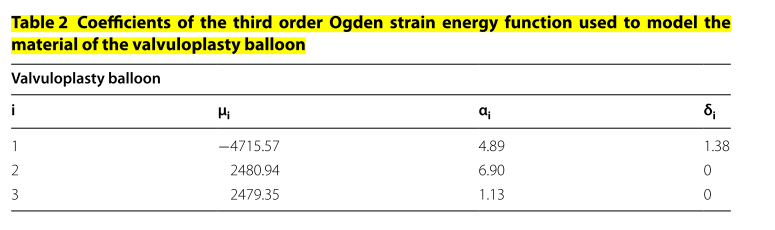

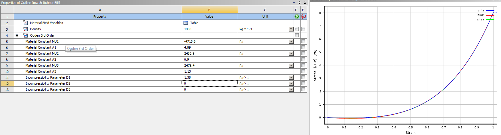

But I want to run the model with values from a paper I am referencing. The material properties are seen below. This is also a third order Ogden material.Â
But when I change the coefficients to the ones in the table above I get an error.Â
Error MAT 2 is not found. Am I inputting the coefficients incorrectly?

I am a little confused by your reply. When I run with the material Rubber 1 from Engineering Data Sources the simulation completes with no errors.Â
Rubber 1 is a third order ogden model.Â
So why does the simulation not run when I change the parameters of the ogden model?Â

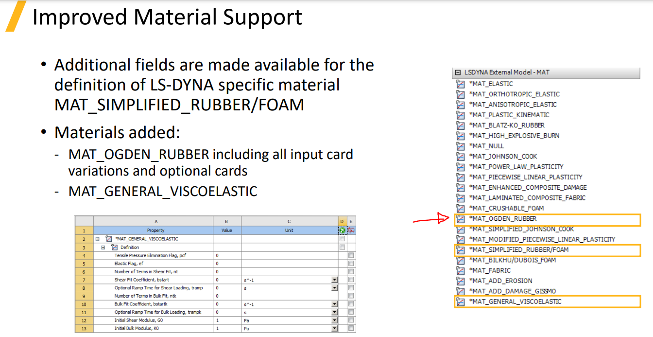

Have you tried using the *MAT_OGDEN_RUBBER from the LSDYNA External Model - MAT in Engineering Data?Â
Also, Ansys 2022R2 is now available and now supports all cards for the above keyword. So, I recommend you download and install the latest version:
https://download.ansys.com/Current%20Release
https://support.ansys.com/Components/DownloadFile?file=/WhatsNew/2022R2/2022R2-Mechanical.pdf
