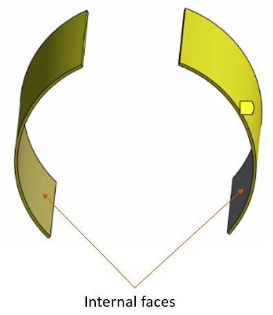

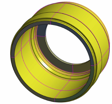

      Hello @danielshaw,
      As shown in above image, the yellow marked surfaces are considered for convective heat transfer for brakedrum and brakepads. The annular ring portion of the brakedrum and the internal faces of brakepad on right are not considered for convection. Two elements are maintained across thickness of the pad in mesh. The film coefficient data was not available so standard value was considered of stagnant air. The units are consistent with other model units [Metric (mm, kg, N, s, mV, mA)].
      Rohan.
    • danielshaw
      I cannot debug your model's BCs from those images.  Does your model rely on contact to transfer heat between bodies?  If so, are the contacts engaged?  Maybe the model has an open contact pair and heat is input into the body on one side of the contact but cannot be conducted to the body on the other side..  Did you try to run a very short transient and post-process the thermal results?  The best debugging approach is probably to obtain a converged solution (even for tiny time step) and review the results to see if the heat is being conducted and dissipated as expected.

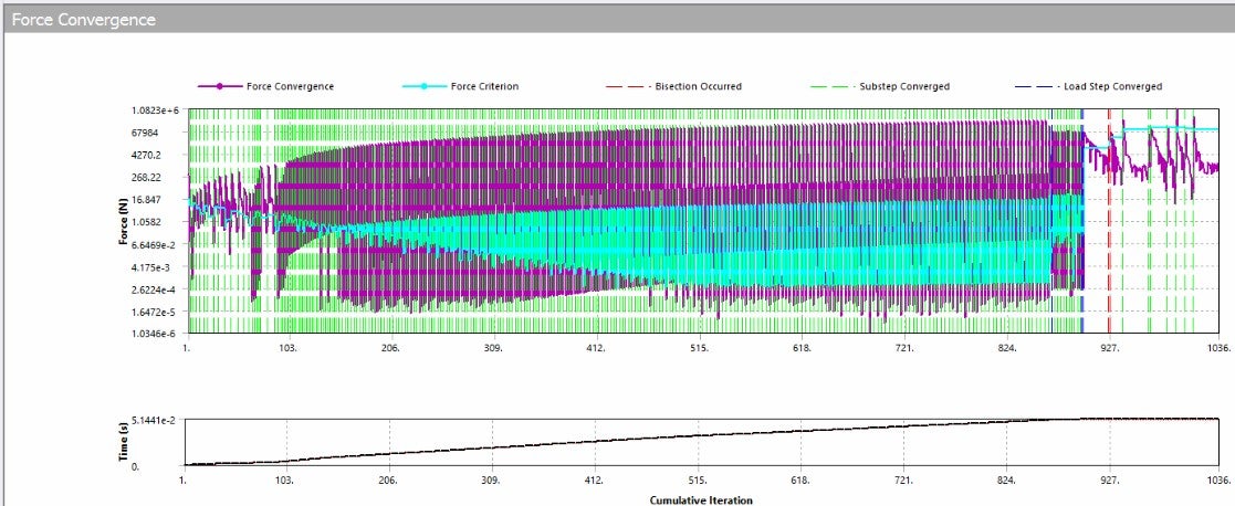

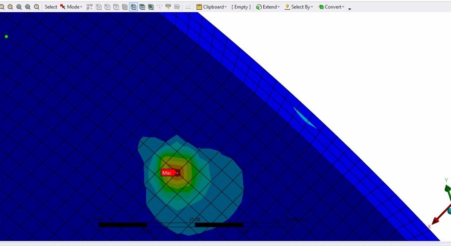

      As per the previous discussion I have done the coupled field analysis of the brakedrum and now I don't get the error of TEMP dof since I changed the material assignment (previously the density of the material assigned to the brakepad and brakeshoe was 1kg/m^3 so assigned default material of structural steel). However, when the load step of brake force starts, the solution stops and I have some N-R residuals as shown below,
      1) Force convergence plot,
      2) 1st N-R residual,
      3) 2nd N-R residual,
      4) 3rd N-R residual,
      The force imbalance location for 1st and 3rd N-R residual is same.
      From the residual plots, we can see the convergence value is well below the convergence criterion but still why the solution does not continue solving and terminates? I had previously applied the initial minimum and maximum substeps to be 1000, 750, 1500 resp., but I changed it to 2000, 1500, 4000 resp, but still the same issue of N-R residuals occurs where criterion > value is seen. How to troubleshoot this issue and make sure the solution doesn't stop even when convergence value is well below criterion.

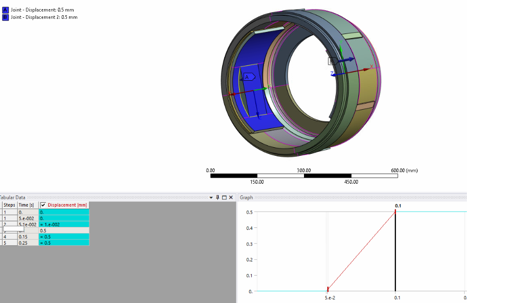

    • engr.rohan7
      Hello @danielshaw,
      In addition to above post, I forgot to mention that the interface treatment for frictional contacts is Add Offset, no ramping with offset value equal to the gap value mentioned in the initial info of Contact tool. The contact status is closed for the frictional contacts. I have also attached the following image where a joint displacement is applied to move the brakepad into contact with the brakedrum surface during the corresponding loadstep as shown below during which the convergence issue occurs at the start of this load step as mentioned in previous post. In the next load step, the brakeforce is applied. I would like to know whether the load applied is correct or any changes need to be made?
      Rohan.

      Did you review the solve.out file?  Did it issue any error or warning messages indicating why the solution stopped?
      • engr.rohan7
        Yes I reviewed the solve.out file and one error message of “Solution failed to converge at time… Run terminated” was seen. As mentioned above, the solver plotted the N-R residuals and stopped the solution from proceeding. How to proceed with the solution?
