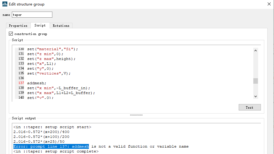

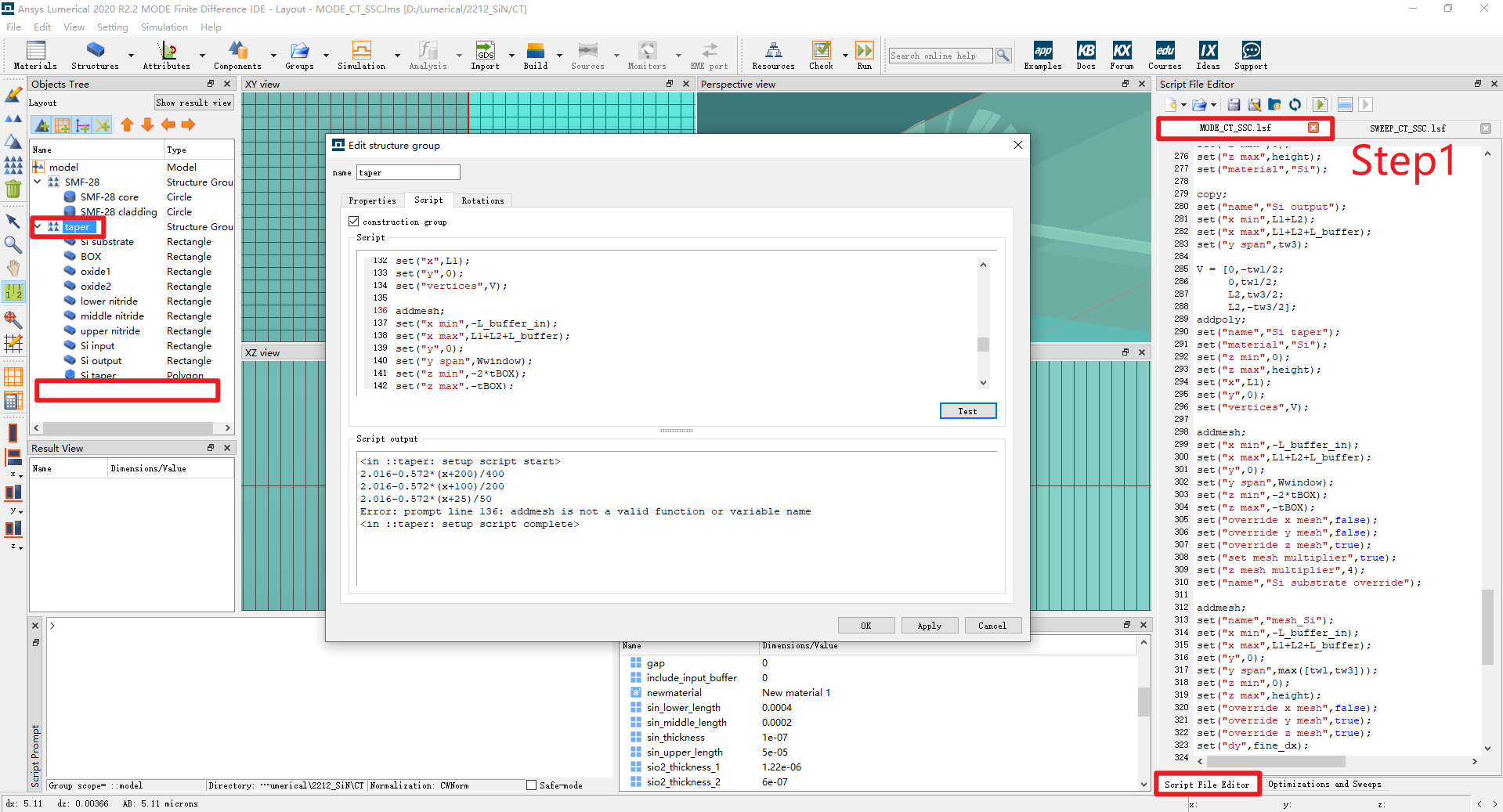

      Today, I am trying to modify the example "Edge Coupler" through all-script-way to build all structures.
      Here is the link of "Edge Coupler":  https://optics.ansys.com/hc/en-us/articles/360042305354-Edge-coupler
      However, when I trying to use addmesh command in script tab of structure group window, error reported as showing followed:
      I am wondering, if it is a bug or I did something wrong? addmesh should be a normal command which is frequently used in simulations.
      Thanks for your reading and hope get your replies.
    • ouyangxin
    • Guilin Sun
      Not every script can work in a group or in "model". In particular, the structure group can only set physical geometry (geometry plus material). FDTD and Override mesh can only be in an analysis group. You can use analysis group to contain and setup the structure group.
      • ouyangxin
        Thank you, Dr. Sun. It works, thanks for your explanation.
