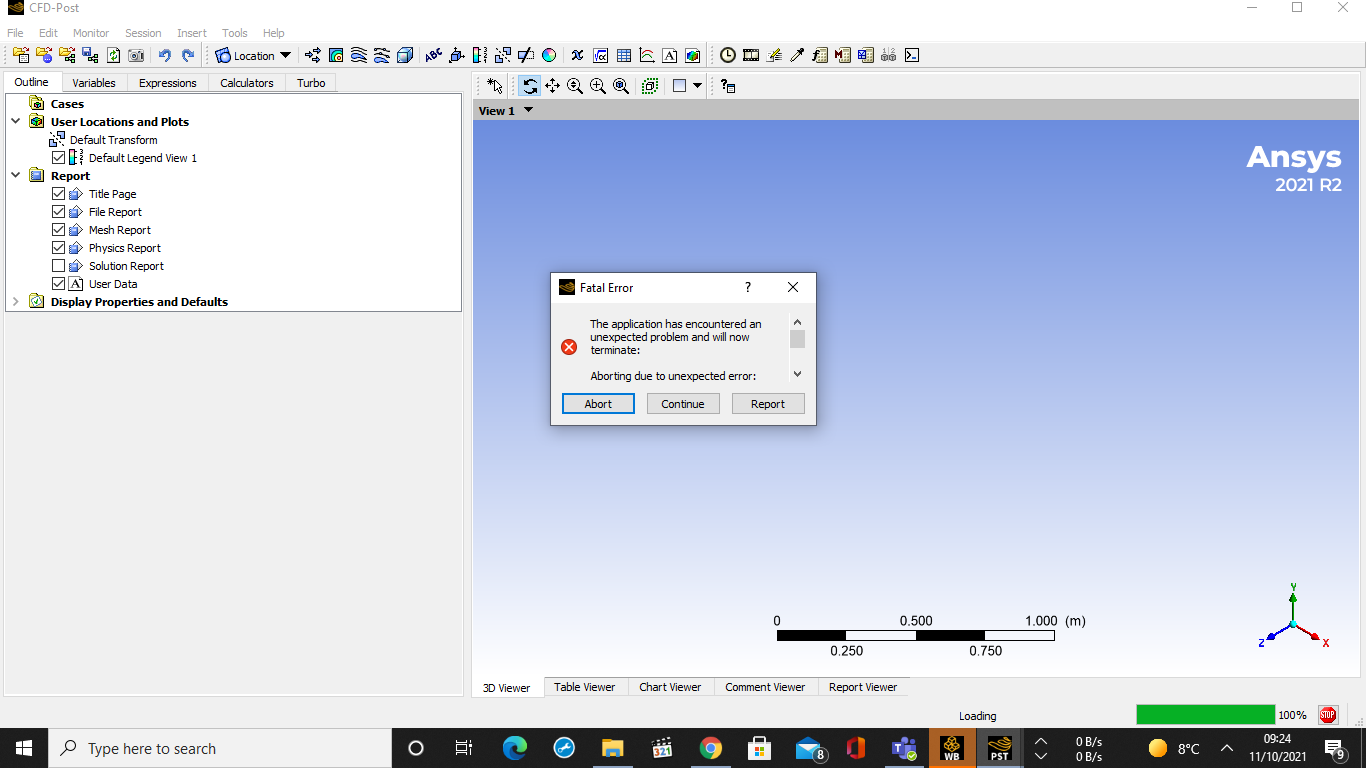

October 20, 2020 at 1:36 pmkelto
SubscriberI've tried several things to handle this issue on a local virtual machine.
For me adding the environment variable fixed the 3D-VIewer in CFD-Pre but lead to the error "Application has terminated before command could be sent." when trying to start CFD-Post.
Host: Fedora 33 + Gnome Boxes
VM: Win 10 2004 + ANSYS 2020 R2
Black window in 3D-viewer of CFD-Pre and CFD-Post. Added environment variable QT_OPENGL=desktop
Could start CFD-Pre. Error when starting CFD-Post "Application has terminated before command could be sent." via UI. Reinstallation of Visual Studio Redistributables as mentioned in another threat doesn't seem to help.
Activation of group policy as described here (on the windows vm?)
Rename folders for appdata v202 and .cfx but still not able to open CFX-Post.
Output of standalone cfdpost.exe:

C:>Engine state was dumped to C:/Users/win10/.cfx/20.2/cfxpost/dump.cst
Do you have any other ideas how to find fix this error?

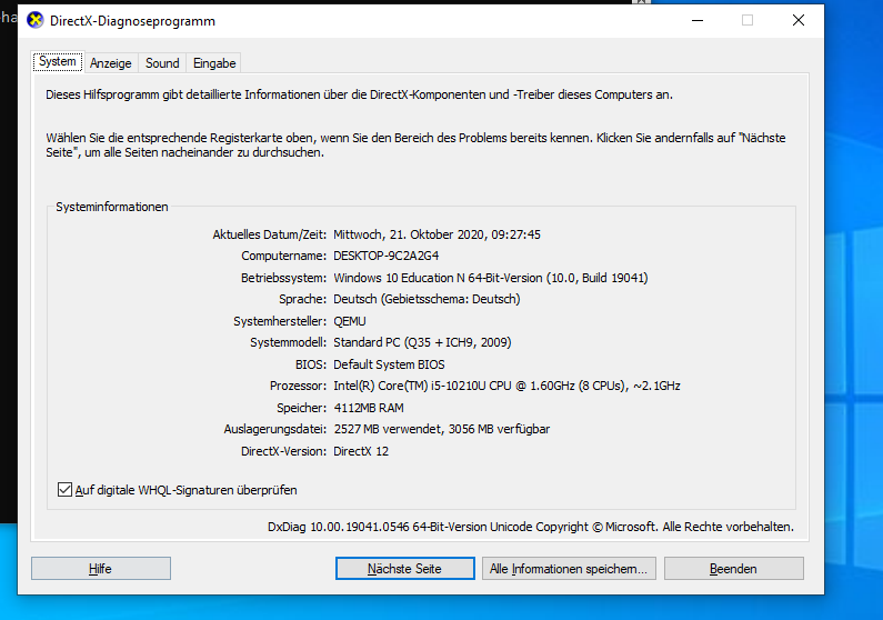

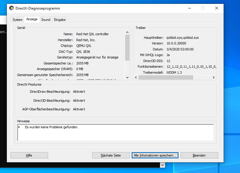

October 20, 2020 at 8:48 pmANSYS_MMadore
Forum ModeratorWhat do you have for graphics card and driver for that machine? Run the command "dxdiag" and share a screenshot of the output.
October 21, 2020 at 7:21 amOctober 21, 2020 at 12:11 pmANSYS_MMadore
Forum ModeratorArray . Please see below and ask your IT folks to assist.

October 22, 2020 at 3:34 pmkelto
SubscriberI didn't really understand your answer but I've found a workaround to start CFD-Post.
With QT_OPENGL=desktop and activated RDP I can start CFD-Post via a RDP connection without getting the error. I Just have to start CFD-Post via the RDP connection and can immediately switch back to my VM in boxes (or virtual Machine Manager)
When CFD-Post is opened via RDP connection I can switch back to the spice/quemu connection.
It seems to be a problem with spice/QUEMU but for me this solution is acceptable.
