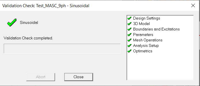

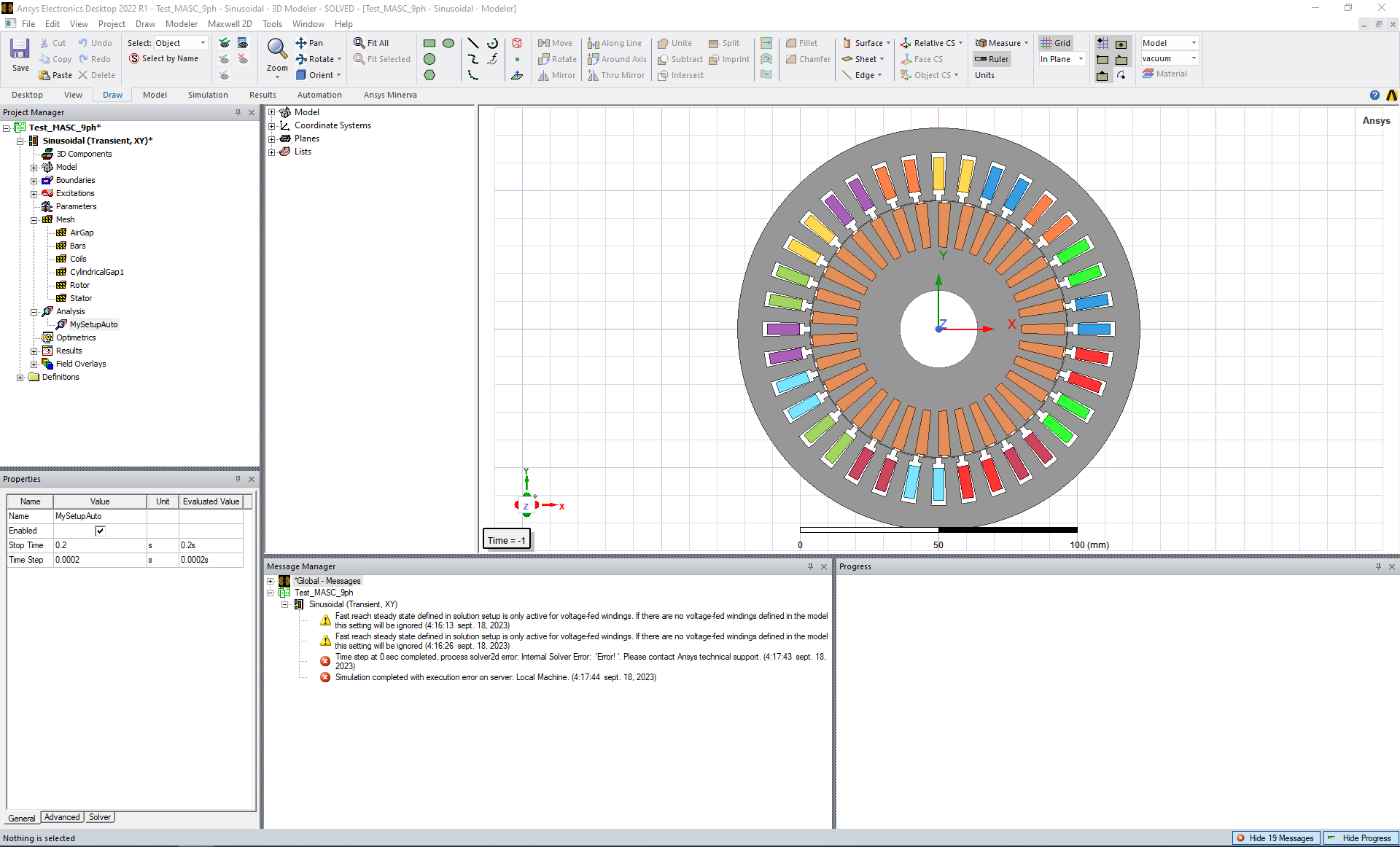

I try to use Ansys Electronics and Maxwell2D to study induction machines. I use a Python scipt and the "pyaedt" library to create a machine (stator/rotor/coils/bars and air gap), supply it, apply boundary condition, mesh the model and solve it.
However, when I analyse it, I got the errors messages "Time step at 0 sec completed, process solver2d error: Internal Solver Error: 'Error!'." and "Simulation completed with execution error on server: Local Machine.".
I got one point on my results graphs (at time 0).
I ran other Ansys Electronic models (created by hand) and everything works fine.
The problem seems to be in the attached model.Do you have any advices or suggestions ?
Thank you
September 19, 2023 at 9:06 pm
DELI
Ansys EmployeeHi, we need more information about your model. Can you try to validate the simulation before analyze? Can you turn off the fast reach steady state and see if the warning message get resolved? -
September 20, 2023 at 6:42 am
Lucas Roux
Subscriber -

SubscriberHi,I eventually managed to solve my problem by rewritting all my Python script (I think it was a mesh problem in very small air spaces that might not be air). But I don't know how to automaticly get a Python script from an existing handmade Ansys model. I can suggess you to manually transcript all the handmade steps into Python command, one by one. That is what I did when I recreated my script from a working Ansys model.
