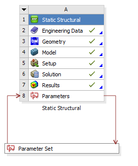

Subscriber (DP 1) The Setup component in Static Structural for Design Point 1 requires user input before it can be updated. For instructions on how to address the cell in its current state, click the blue triangle in the lower right corner of the cell in the Project Schematic. Â
Am having the above error message when am performing a parametric study. I have checked the projetc shematic for the blue arrow as instructed but it says it up to date. see attached project shematicÂ
Please kindly help to sort this issue. Many thanks.

SubscriberSet DP1 to Current in the Parameter Set and open the Model to see what it needs before it will solve.
