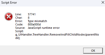

SubscriberI created geometry in design modeler and aved them in spaceclaim and design modeler file format but now when I import them in workbench in Geometry section their the geometry is shown but when I move to next step, i.e., for meshing it shows the error attached in image below. Howcan I get rid of this error.

Forum ModeratorHi Rahul,
Ansys Workbench Mechanical and related applications produce JavaScript Runtime Error Type Mismatch on Windows 11 24H2Q: Ansys Workbench Mechanical and related applications produce JavaScript Runtime Error Type Mismatch on Windows 11 24H2
Issue often occurs when importing geometry into a new analysis. Error may be similar to the following:Script Error
Line: 61871
Char: 8
Error: Type mismatch
Code: 800a000d
Source: JavaScript runtime error
Script: g_UIHandler.TreeHandler.RemoveAndFillChildNodes(parentNode);A: Windows 11 24H2 has begun setting a local policy that, by default, causes applications to use the JScript9Legacy.dll instead of JScript.dll.
Windows 11 24H2 was not available at the time of Ansys 2025R1 release testing and is not officially supported.
A future Ansys 2025R1 Service Pack 2 will address this issue without having to modify the Windows registry as stated here.This issue can be resolved for all previous Ansys versions by changing the default registry key to load the classic jscript.dll instead of the JScript replacement DLL jscript9legacy.dll. The end user should understand any potential risks this may cause.
Search the internet for “JScriptReplacement” or "JScript9Legacy.dll for further information.
To load jscript.dll by default:
- Launch regedit.
- Navigate to: HKEY_LOCAL_MACHINE\SOFTWARE\Policies\Microsoft\Internet Explorer\Main
(Create the folder Keys for Internet Explorer and Main if they do not exist) - Right-click the Main key and select New | DWORD (32-bit) Value.
- Name the new value JScriptReplacement.
- Set the value of JScriptReplacement to 0.
- Reboot the computer
