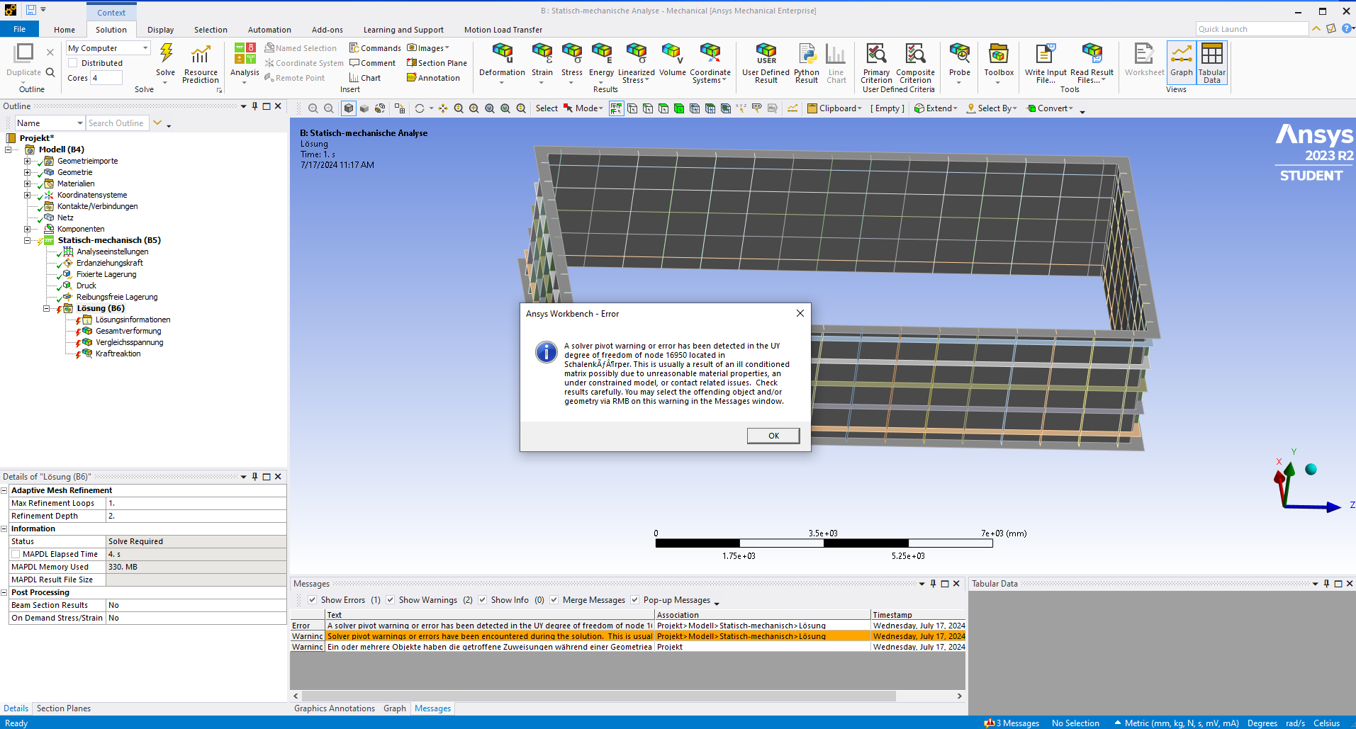

I created a geometry through the Design Modeler and then I retrieved it in Mechanical application, and when I checked the Results, I encountered the following error that I have attached, but can you tell me how I can fix it?
I think that the surface bodies should be considered integrated in a way, because in the geometry part of the mechanical, these bodies are considered separately.Â

Ansys EmployeeThe error essentially says the bodies are not connected.Â
The problem seem to be in DM. Please confirm the surfaces are connected with Shared Topology or Joints. -
July 20, 2024 at 7:09 pm
Gary_S
Ansys EmployeeIn DM, Try to connect just a few pieces.Â
Then, take into Mechanical and do a simple Structural analysis or a Modal analysis.Â
See if you are able to get a successful run.
