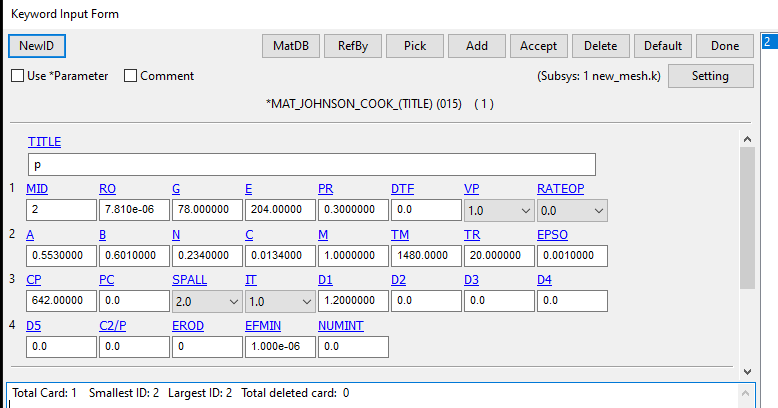

      Hi all.
      I'm modeling metal cutting.
      There are no chips when cutting.
      I am using the Johnson Cook model and ADD_EROSION.

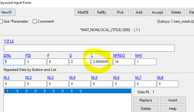

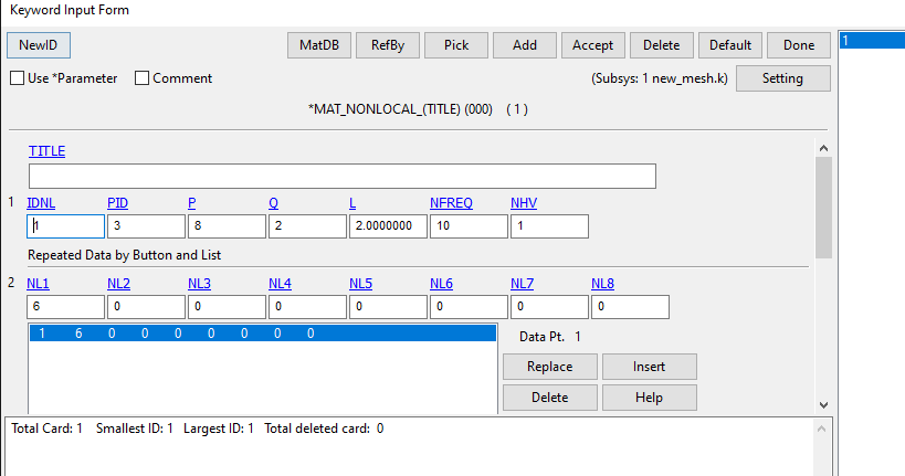

      I want to apply MAT_NONLOCAL map. An error occurs during initialization:
      Why?
      What are the main parameters that must be in order for chips to appear when cutting?

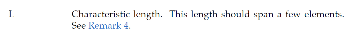

      What is L set to in *MAT_NONLOCAL? It look like you are including 302500 elements in the search which is way too much and this is why you ran out of memory. The L parameter should be set to include only a few elements. Refer to the LS-DYNA user manual for more information:
      Also, your elements have a high aspect ratio and so the quality could be improved.
      I would simplify the model for now and remvove the *MAT_NONLOCAL. To see chips, you need material failure to occur around a group of elements. If this does not occur, the elements just get deleted when they fail and you never  see chips.

         >>What is L set to in *MAT_NONLOCAL?
        Yes, of course, I read everything and made the standard parameters

      Try setting L to a smaller value and try again. The L value is probably too large compared with the mesh.

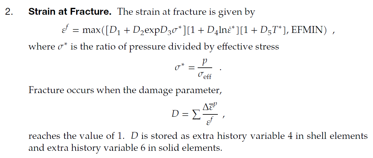

      There are many ways to include failure. Many material models (*MAT_015 included) have material failure built-in. For metal failure, plastic strain at failure is commonly used. In *MAT_015, you can have failure strain a function of triaxiality (state of stress), strain rate, and temperature using the D parameters.
      You don't need to have such a complex failure to begin with. *MAT_024 is commonly used to model metals and you can define a simple plastic strain at failure using the FAIL parameter. Once you get it working, you can add complexities (triaxiality, strain rate, or temperature effects) to be more accurate in your failure prediction. Here is a good video on *MAT_024:

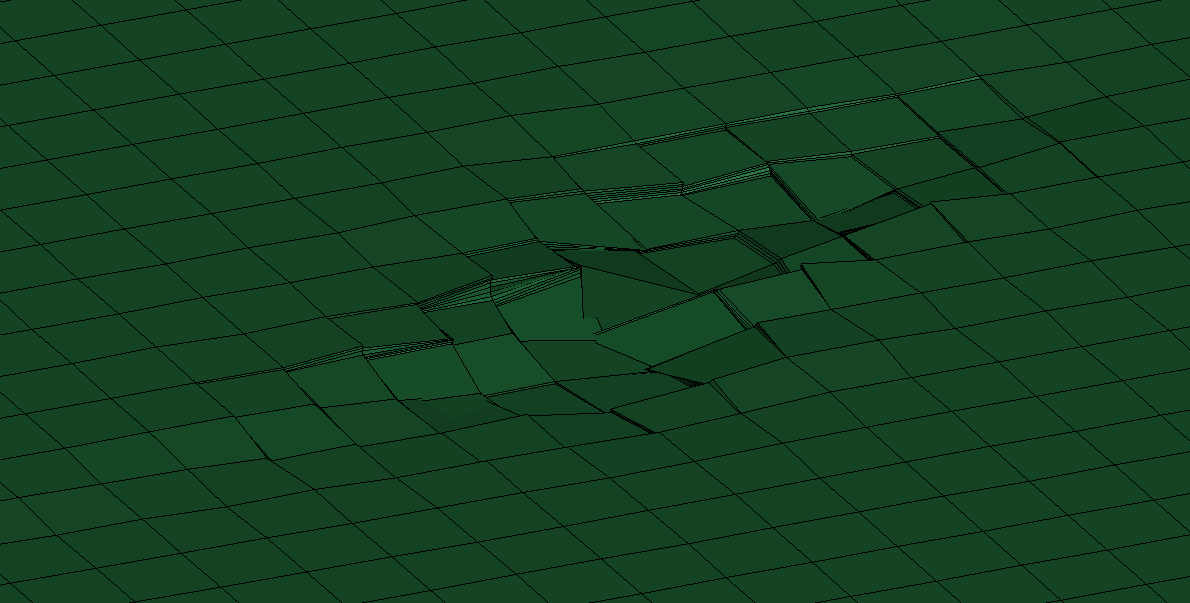

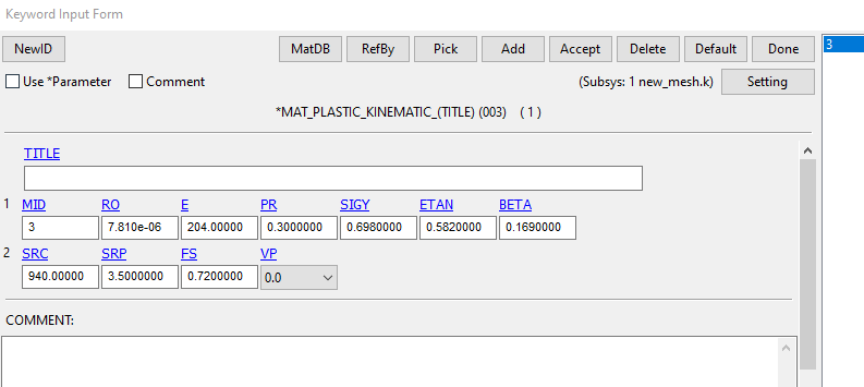

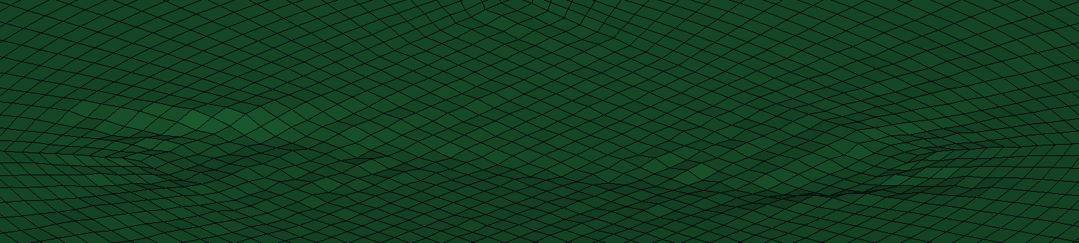

      I did a test with MAT_24, the material is not removed, only crumpled:
      MAT_24:
    • javat33489

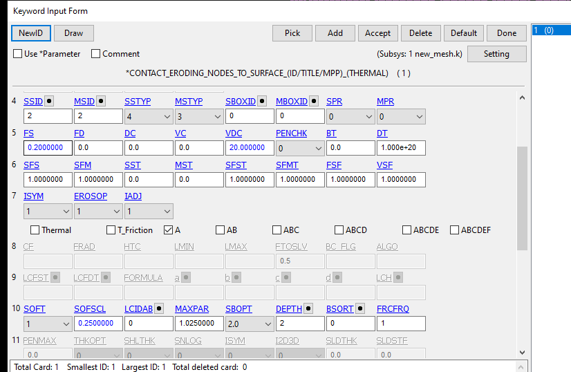

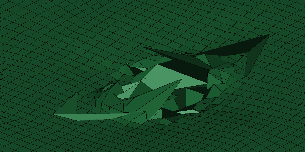

      I tested different options for materials 024, 003, 015, 018. But the material is always removed
    • javat33489
    • javat33489
      Result
      or
    • Reno Genest
      With traditional FEM and failure, the elements get removed. So, most likely you will never see chips being created unless you are lucky and remove big chunks of material at a time. Element will get deleted when material failure occurs, so what you observe is what is expected.
