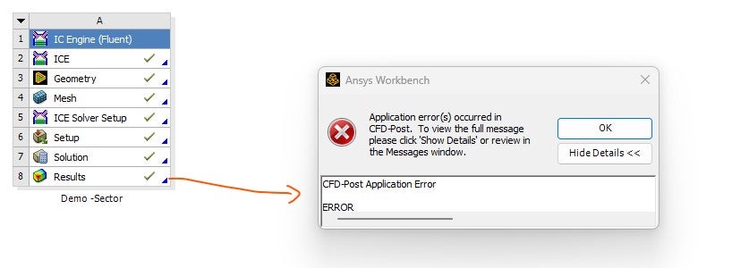

      Hello everyone, im suffering some errors while trying open CFD-Post that does not allow me to analyze correctly my model. The two errors I am having are these:
      - File '\AB000FS0118_DataernoDesktop3D3Dsim_filesdp0FFFFluentFFF.1-3-00033.dat.gz' does not exist or is not readable.
      -CCL parser failed with message:
      invalid parameter value "., \AB000FS0118_DataernoDesktop3D3Dsim_filesuser_files": control character number 8 is not allowed.
      Ive checked that FFF.1-3-00033.dat.gz is in the folder and i can open the case perfectly.
      I am not sure if this information will be enough but if anyone has any tip that will help me to solve this issue, i would be very grateful.
      Thanks in advance.

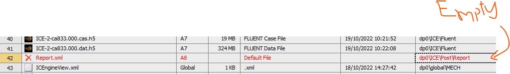

      In addition, the folder for the report  is empty
      Any guide?
