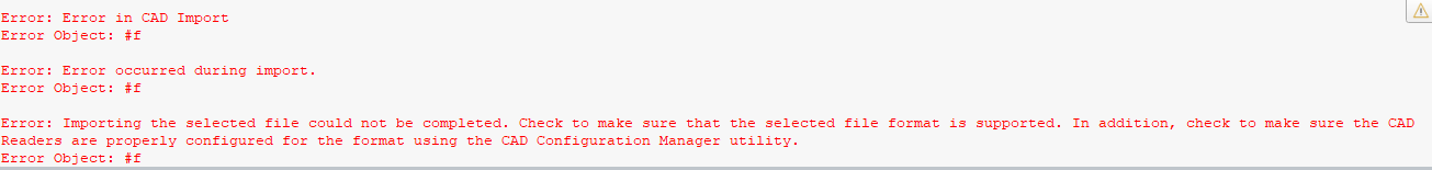

I got an error regarding importing CAD file into Fluent meshing.
hat I did is to make a model using SpaceClaim and imported that file into Fluent meshing so that I could make an appropriate number of meshes and run a simulatison. But, the problem is when I import model file, I got an issue shown below.

January 6, 2022 at 6:03 amKeyur Kanade
Ansys EmployeePlease check geometry in SpaceClaim.
Select geometry in structure tree --> Use right click --> Select Check Geometry. (Or Tools - Fault Detection in DM)
The geometry should be error free to proceed.
If geometry has any errors, please modify/recreate geometry at those places.
The error may be due to CAD configuration is not done correctly.

January 6, 2022 at 9:39 amRob
Forum ModeratorCan you also post the rest of the error message. I've seen a licence problem with SpaceClaim, but Step files import OK.
