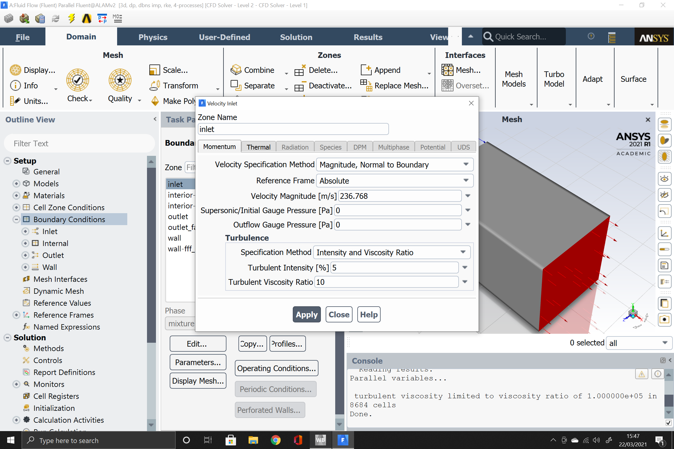

Subscriberhello,nnThank you for your help. I have solved the error by making the outlet fan a wall boundary condition. nI have another question relating to boundary condition. nI know my air flows at velocity 236.768 m/s and put a velocity inlet boundary condition there. However, i am not sure if i am supposed to enter an number in the outflow gauge pressure and supersonic/initial gauge pressure. I do have the inlet static pressure of the flow but i am not sure if i should define it here. (I am modelling a turbofan engine but the main area of focus is at the inlet).nI have also defined the outlet to be pressure outlet = 0, i am assuming this tells fluent that the flow exits here.Regards
March 22, 2021 at 3:58 pmRob
Forum ModeratorIf the material density is pressure dependent then the outlet pressure matters, otherwise it's just a value to set the outlet at. nMarch 22, 2021 at 4:49 pmsyed123

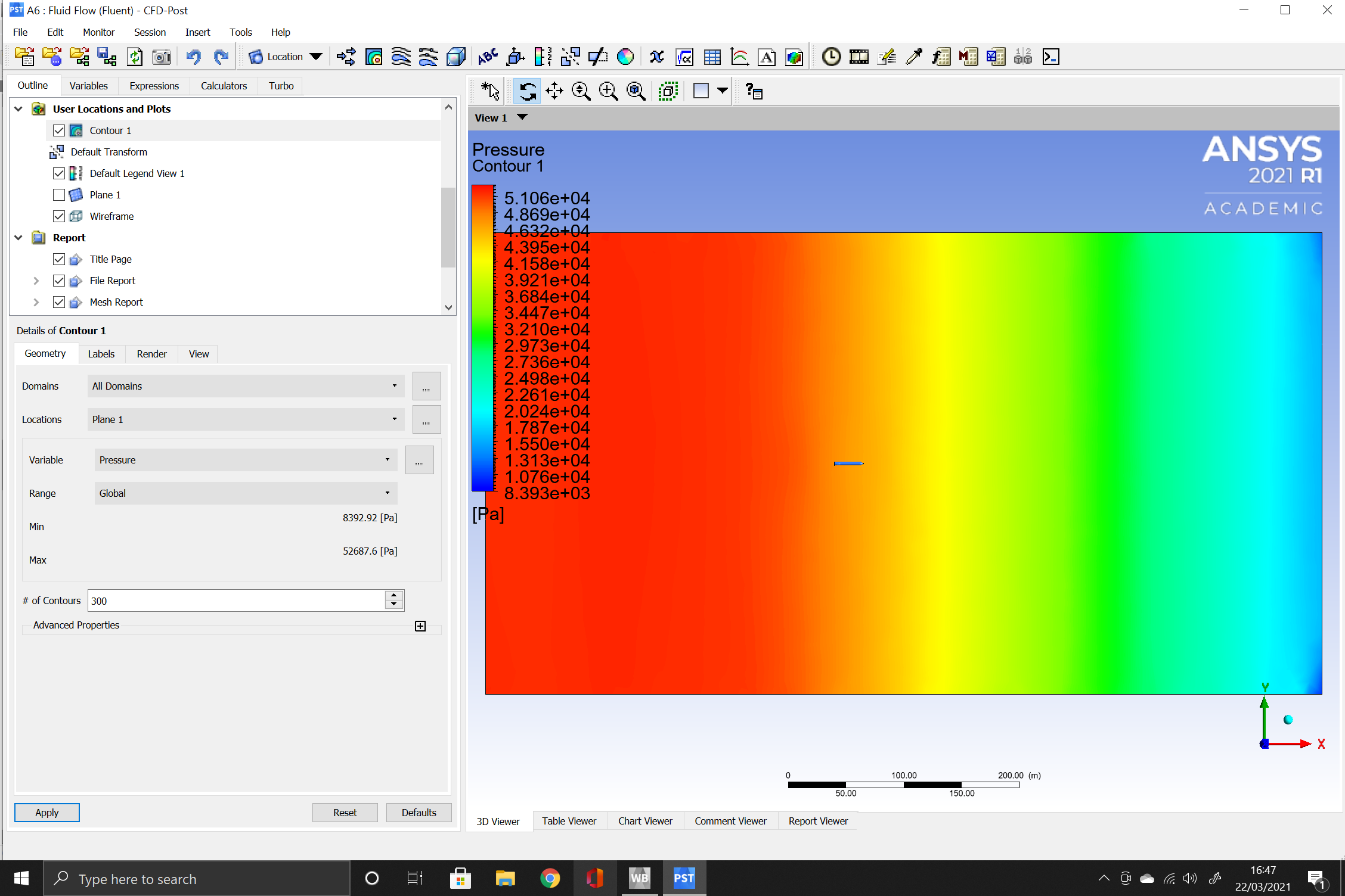

SubscriberHi Rob,nnThe material density is not pressure dependent so i have left the outlet pressure = 0. nWhen Run the simulation i get this result:nnThis does not look right compared to other simulation that were run (The contour plane is at the cross-section of the Nacelle). Surely the pressure should increase towards the fan area and the walls of the Turbofan. Do you think this may be a boundary condition problem or a mesh problem or somthing else that i am not aware of.Regardsn
March 23, 2021 at 12:17 pmKarthik Remella
AdministratorHello,nYour material is air, right? At an inlet velocity of 236 m/s (assuming the speed of sound is 340 m/s), you are already at a Mach number of 0.7. The flow is likely compressible. You should be using the ideal gas law for density.nKarthiknMarch 23, 2021 at 11:37 pmsyed123
SubscriberHello,nnMy turbofan is solid but the control volume is air. I have used ideal gas law for density and Sutherland for viscosity. nBelow shows the contours vector plot. For some reason it does not flow around the Turbofan, i don't know why it doesn't do that. nnHere is the image of the cell zone condition:nn
nHere is the Boundary Condition:nn
nhere is the Inlet BC: n
nand here is the outlet pressure:n
nHere is the mesh:nn
nI know the mesh control volume needs to be increased but for some reason the flow does not recognise that the solid turbofan is there. I really need to just show how the air flows around the nacelle inlet, i have been struggling to do this, any help would be grateful.Regardsnn
