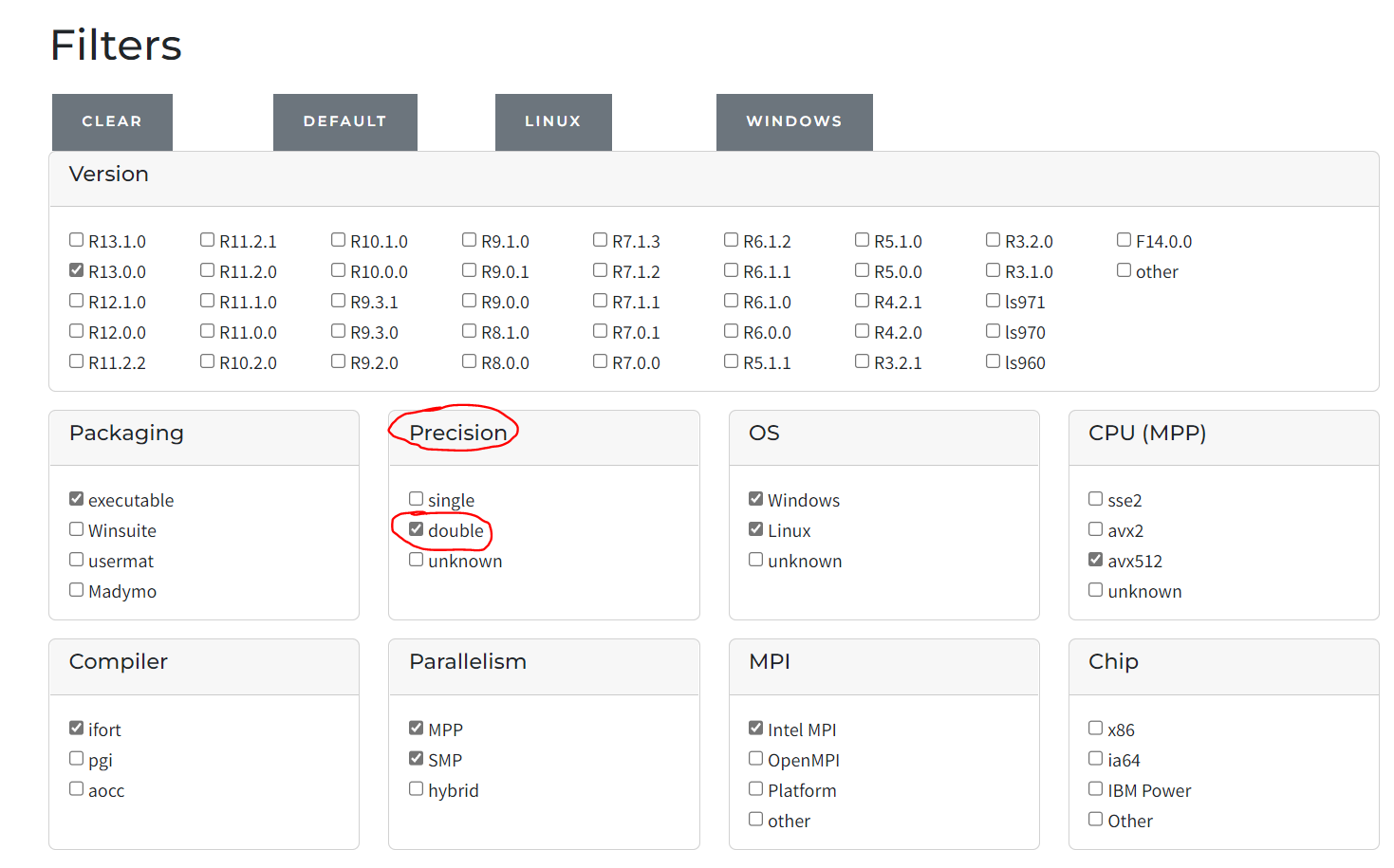

           *  Recommend switching to the REAL*8 version of LS-DYNA

      It looks like you are doing an implicit simulation. AUTOSPC constraints are added to an implicit model to prevent rigid body motion which is not allowed in implicit. Here is what you can try:
      1. Fully constrain the parts in your model so that they don't move as a rigid body. Then run the implicit model again.
      2. Do an explicit simulation. It is okay to have rigid body motion in an explicit simulation.
      Also, the error message recommends to switch to REAL 8 version of LS-DYNA. This means using a double precision solver. You can download one here:
      LSDYNA » Downloader (ansys.com)
