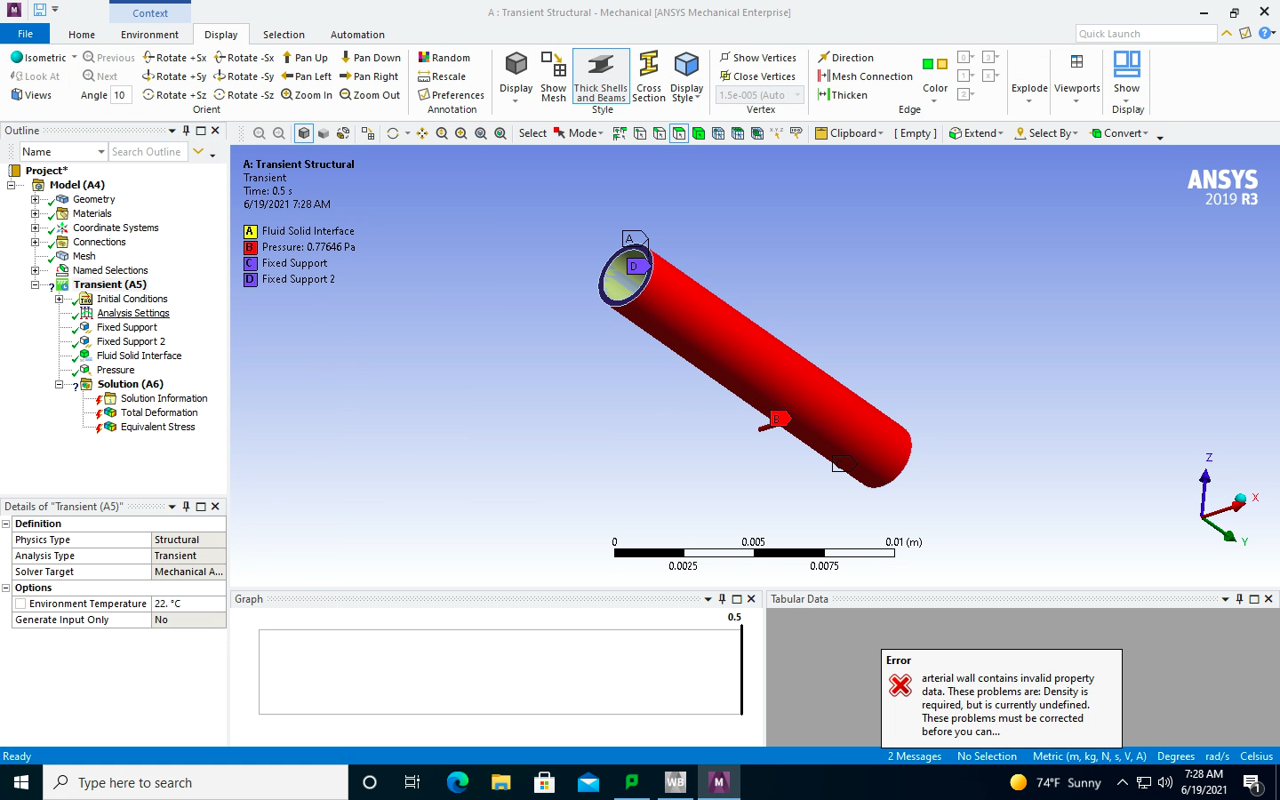

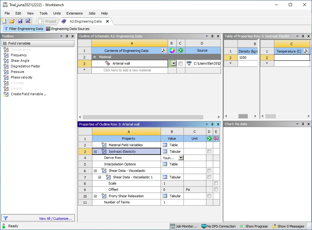

SubscriberI've been trying to run my simulation on transient but every time I try to solve this error pops up ( in the screenshot at the bottom right). I attached a screenshot of how I defined my material and the error.
Please help me figure this out.
Thanks

SubscriberFollow the directions in the error message and add Density to the material in Engineering Data. Density is listed under Physical Properties and you drag and drop it onto your material.
You can't run a Transient analysis on a solid body that has no Density defined, since mass is in the equations and if there is no density, there is no mass.

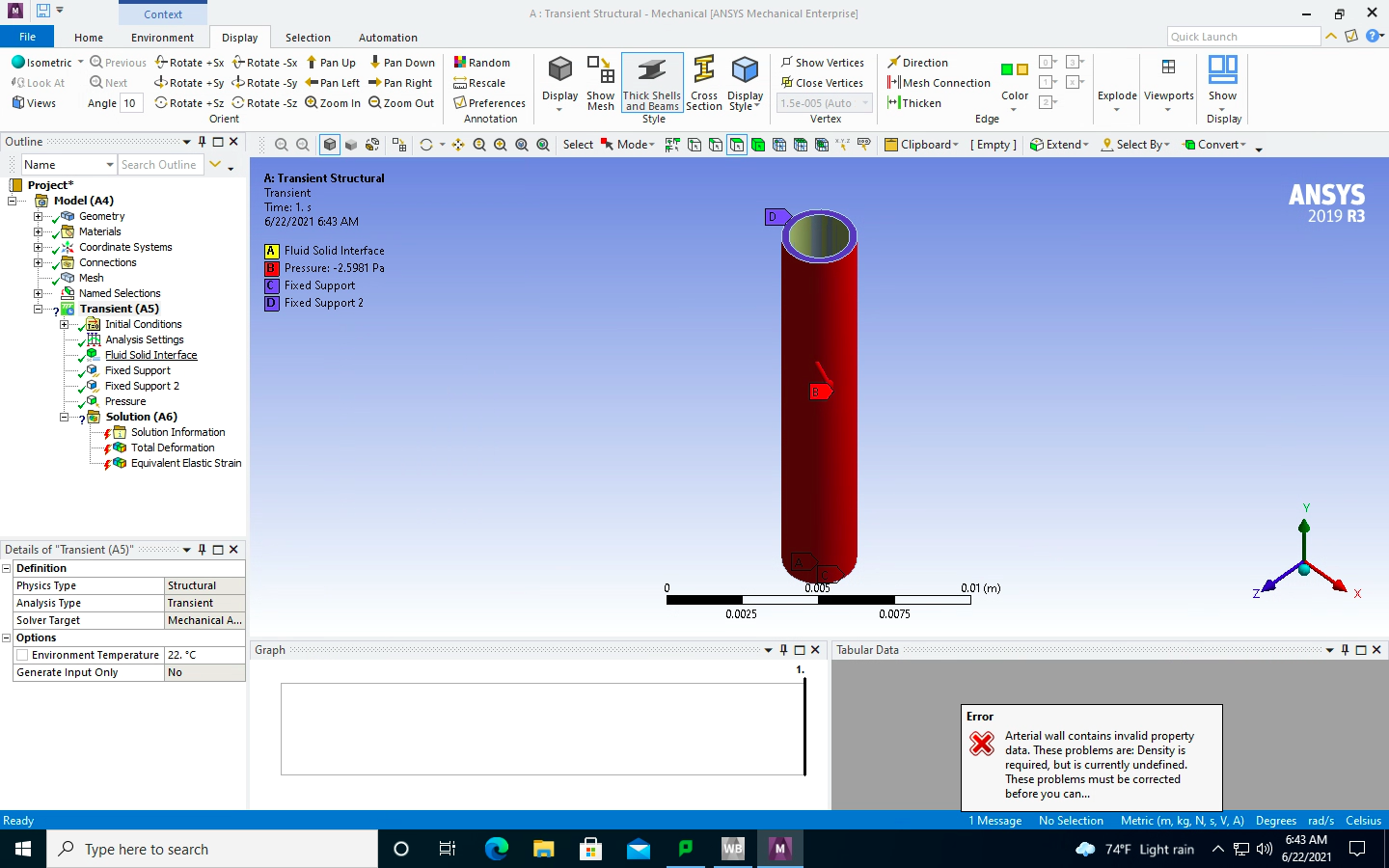

June 21, 2021 at 3:34 amJune 21, 2021 at 10:08 ampeteroznewman
SubscriberPlease insert an image showing the error message.
June 22, 2021 at 3:45 amJune 22, 2021 at 3:52 ampeteroznewman
SubscriberI don't know what is wrong. Someone from ANSYS will have to reply.
