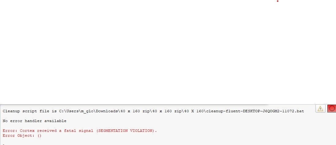

      Hello everyone,
      I downloaded Ansys R1 2021 a month ago. Everything has worked perfectly until yesterday. Since yesterday, fluent has failed to start with this error :
      Is there any text above that?
    • MasonGlocke
      Hi Rob, whenever I try to run a "Setup" after meshing, this message pops up. Tried reinstalling and that did not help.
      Thanks
      Are you launching the solver from inside a zip file? The working path looks a little weird.
      Otherwise, try a clean case (mesh from one of our tutorials) and from c:\users\m_glo\fluent_folder Launch Fluent from the Start menu (or find the executable, /forum/discussion/30904/launching-fluent-in-standalone-mode
