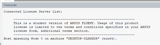

      I am using the Student version 2023R2.

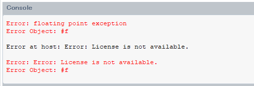

      When I process Solution after Mesh, the error appears as "Error at host: Error: License is not available."
      The error in floating points might cause by mesh configuration, but I concern in license error.
      Please guide me how to fix the license issue in this case?

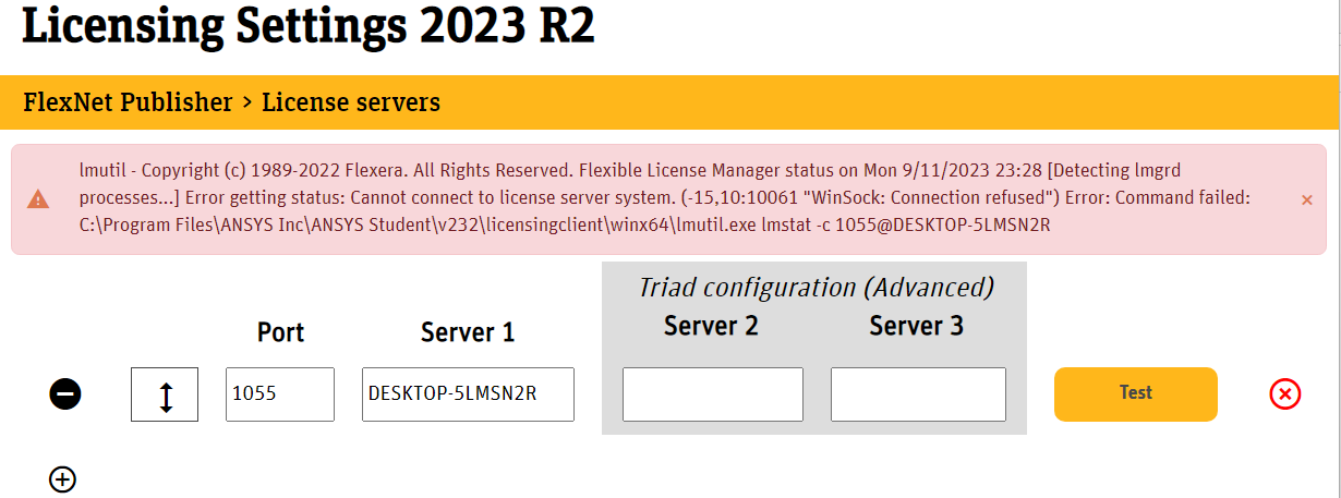

      At your end can you please check and confirm if you are able to ping and telnet the server?
      Go to the start menu --> open the command prompt --> run the commands and send the screenshot of the output:
      • ping servername                        //mention yourservername
      • telnet servername portnumber (bydefault port number is 1055.)
      A blank screen will confirm that you are connected, if you get any other output, please provide a screenshot of the same.
      • To ON telnet service go to start -->search “Turn Windows feature on or off” Ă check box “Telnet Client” and click ok.
      • DUY KHIEM Do
        Hi Jadhav,
        I am thankful for your prompt support.
        Unfortunately, the output is “Could not open connection to the host, on port 1055: Connect failed”.
        Please help me to solve it.
        Thank you very much.
    • Rajeshwari Jadhav
      Hi Duy Khiem Do,
      Just to confirm are you using Ansys Student version or Ansys Academic version?
      Also, if you are using Ansys Student then License file is not required. If you have a license file uploaded on the license manager server then please download the correct fluids package from here: Current Release (ansys.com).
