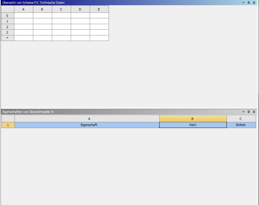

      I had archived a Project as wbpz.- file and now I reopened it and wanted to edit material data. I got the following error message:
      The page doesnt display the Engineering data and looks like this:
      The material properties are still there somehow; at least when I open the modell in Mechanical, I can select different materials I had created before for my modell. I also run a simulation and in the report appears the right material with its properties.
      Have you ever had such an error and how did you solve it?
      Stephan
      PS: Saved the wbpz as ANSYS v191 .wbpz and also using 19.1
    • Sandeep Medikonda
      In what version was the archive file created?
      If the error is repeating for all models you have, it points towards a systems issue. If not, it could be model specific and sometimes resetting your application data can help. Try this.
      Have you tried opening it in a later version such as 2019R1? If not, it wouldn't be a bad idea to try opening your old file in a newer version too.
    • amnteno1
      thanks for your suggestions. Se updated at our University to 19.2 and now everything works fine again.
      Stephan
