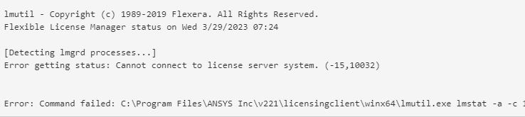

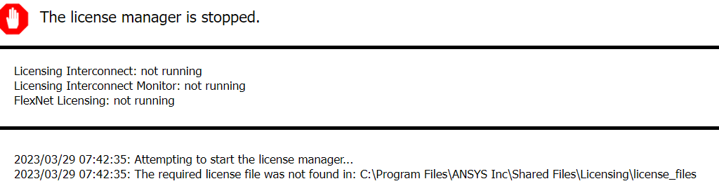

      In the case of no "ansyslmd.lic" appearing in my new student 2022R1 install nor 2023R1 install, what should I do?
    • ANSYS_MMadore
      Ansys Student installs should have no ansyslmd.lic file, and should not result in the error message noted in this thread. Please share a screenshot of the exact errors you are encountering.
    • Zijing.zheng
      This is the error showing right now, and no license file was detected by the License Manager even when I just install student v2031r1.
      The only file in the License file is the backup file.
    • ANSYS_MMadore
      If you are running the Ansys Student product from https://www.ansys.com/academic/students/ansys-student you do not install the license manager. The Student Product has a built-in license and does not require any additional license management. You should remove the license manager if you are using the Ansys Student Product.
