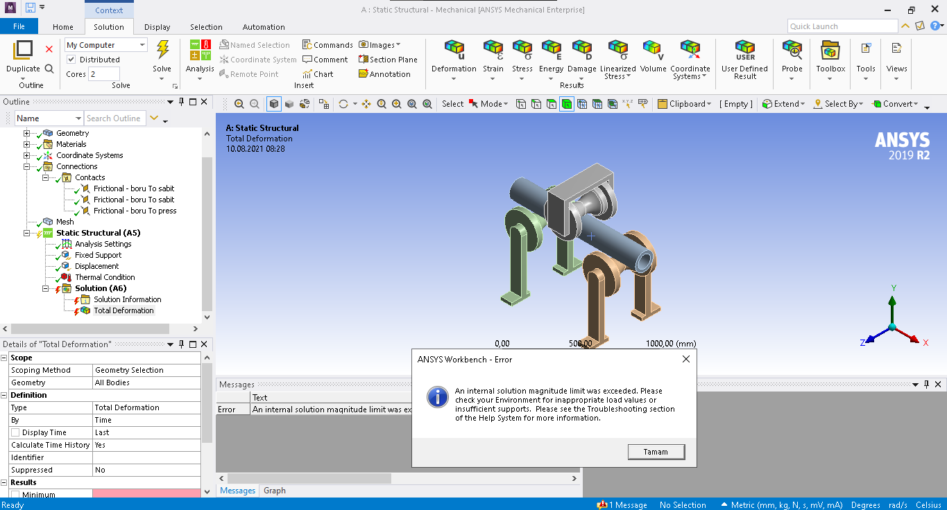

Error: An internal solution magnitude limit was exceeded
    • sonerulger
    • sonerulger
      By the way I tried every way to solve that I mean I read the discussions in forum which about the same problem but I couldn't solve that error.
    • sonerulger
      I tried another solution offer like weak springs on/off, auto time stepping initial substepping 100 etc. but didn't work again. I'm trying to bend the pipe for a while and see the spring-bak effects.

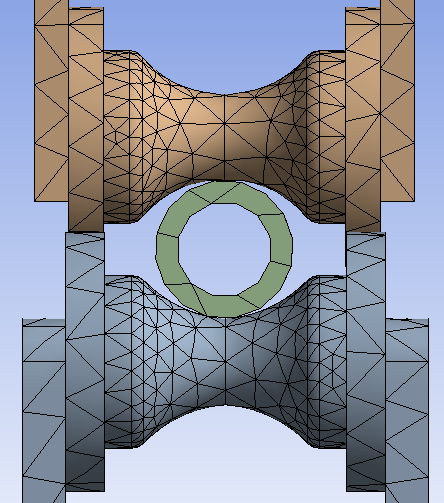

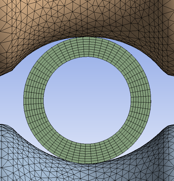

      When you mesh the pipe, you need at least 8 linear elements through the thickness. You have one.
      You want to set the rollers to Rigid so you don't fill them with elements, you just mesh the surfaces that make contact.

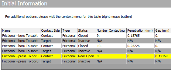

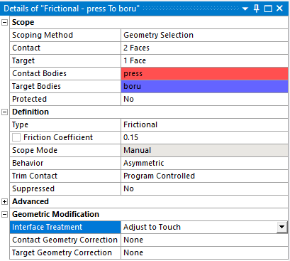

      Whenever you do Frictional Contact, you must insert a Contact Tool and make sure all the contacts are closed. In the example below, this will fail to solve.
      The corrective action is to change the Interface Treatment to Adjust to Touch.

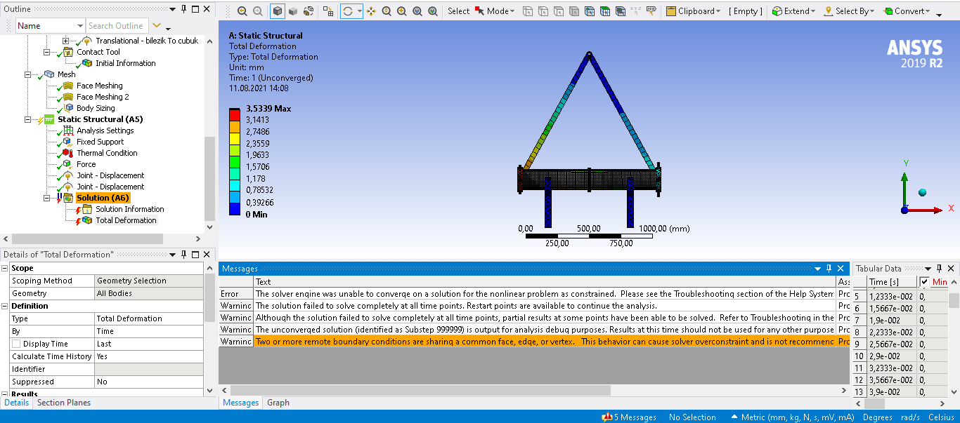

      Unfortuntely I got the same error again. I tried to make more basic the design. I need to see the all results of the pipe so I can't seperate the design. But I checked contacts via contact tool to make sure all the contacts are closed as you said. Also I added two rings to the pipe outlets. And added bars to those rings so I can remove them when the end of the process. But as you see I got errors again. This time there is no deformation on the plastic pipe. When you have time maybe you want to look at it. Thank you.
