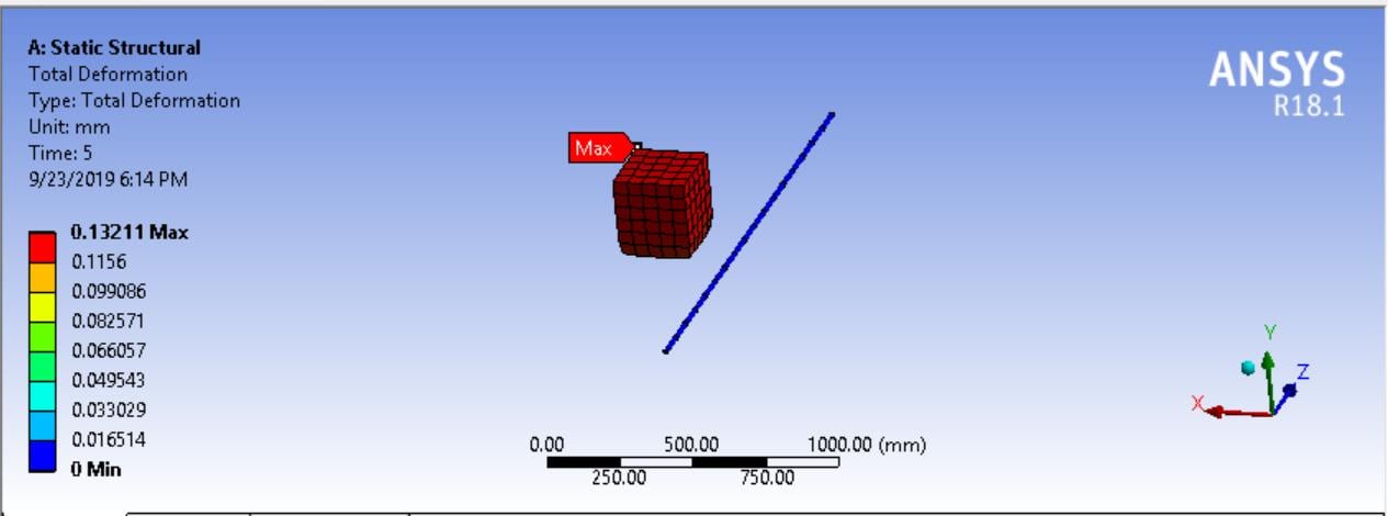

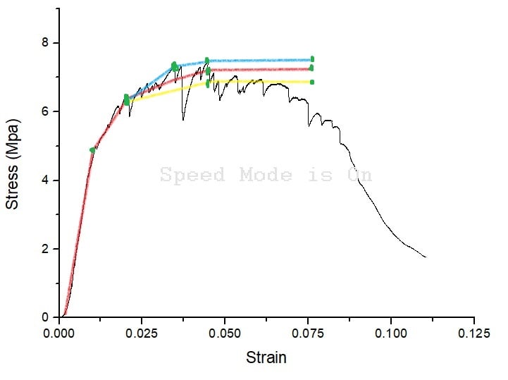

      I intend to model the non-linear behavior of reinforced concrete in ANSYS workbench. I have seen some discussions and videos regarding this and have some confusion and problems which I would like to clarify. From the experimental results I had the load-displacement values which I later converted to flexural stress and flexural strain. According to the discussion (Multilinear Kinematic Plasticity created from a stress-strain graph), the engineering stress and engineering strain should be converted to true stress and true strain before entering the values for a material in Engineering Data. I followed the calculation in that discussion but I am getting the both Engineering stress-strain and True stress-strain curves almost similar. I also checked the plastic strain with and without offsetting, plotted with true stress but still had some issue, had almost the same curve.
      Another discussion (Non-Linear Analysis_Multilinear Theory), the user input the values of Raw true stresses and True plastic strains for multi-linear theory (Multi-linear isotropic hardening MISO). Can someone please comment on the calculations are correct or not? Also, as mentioned here that should not have the negative slope on the True Stress vs Plastic Strain curve in a multilinear plasticity material model. How can I correct it for my case?
      I assume that for entering material non-linearity and inputing the values of experimental results we only need to input the true-stress and plastic strain values. From hereafter, I will be referring these two as stress-strain only. If there have some exception, specially related to concrete, then please correct me. Also some researchers have only mentioned the stress-strain values were input, but they didn't mention whether be engineering or true stress strain or plastic strain with true stress. From what I have searched so far I think it is understood to use the plastic strain with true stress as an input.
      Some of the articles I read have used MISO for entering the stress-strain curve or values for the material used along with SOLID65. However, some have mentioned the usage of Drucker-Prager or Menetrey-Willam models for the input of stress-strain values for concrete. I would like to ask if I only input the MISO will it be enough to define the non-linear behavior instead of defining the Drucker-Prager or Menetrey-Willam models. In addition, these models require compression and tension results which I do not have and also I am trying to simulate the bending only.
      In Abaqus, I read some articles only defined concrete damage plasticity and didn't need to physically design the reinforcements and successfully ran the simulation. In Ansys workbench, as an alternate, I suppose we have the Drucker and Willam model. Could this also be done by defining the MISO only?
      I intend to model the cracking as well in my static structural model. SOLID65 element is famous for showing the cracking in simulation. However, experts have suggested in some discussion using the SOLID18X elements. Are the SOLID18X able to have the cracking behavior as well? So far what I have searched I think they can not simulate the cracking behavior. If not, then is there any workaround in workbench for modeling the cracking or I shall use SOLID65 only?
      Also, in some articles, they have skipped the ANSYS models instead have used the Multilinear elasticity (MELAS) to simulate the non-linear concrete. How can I define the Multilinear elasticity (MELAS) in workbench?

      Multilinear Kinematic Plasticity is ideal for ductile metals. Below is an image of the uniaxial test data in Engineering Stress and Strain.
      You can only use Engineering Stress-Strain data from a Uniaxial Tensile Test up to the point when necking begins at the Ultimate Stress. After that, a key assumption is violated and the equations that convert Engineering Stress-Strain to True Stress-Strain are invalid.
      The True Stress - True Strain curve keeps increasing after necking, but you can't use the Engineering Stress-Engineering Strain to obtain the curve. What you can do is guess what it might be and run a model with that guess. The model will simulate necking and create a Force - Displacement curve. Obtain the error between the Force - Displacement curve from the experiment and the simulation to inform a revised guess for the True Stress - True Strain curve. Iterate until the two curves have better agreement in the post-necking portion of the curve.

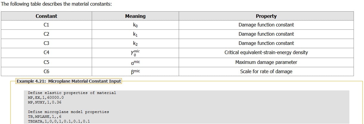

      For the Microplane model,
      1. Do I only need to input the parameters shown in the image below (taken from the Technology Guide file which you shared in your reply) ? Although the table doesn't mention the input of stress-strain curve(or points), but for confirmation do I have to input the stress-strain points or only the parameters are enough when using the microplane model for concrete? Also in the video the user only mentioned the parameters not the stress-strain input values in microplane model.

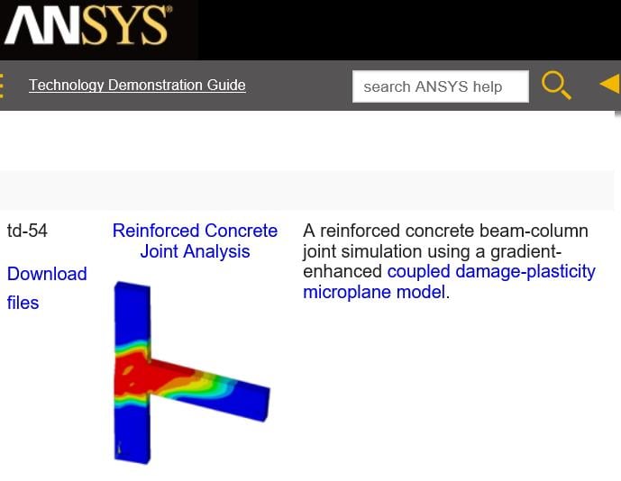

      To get the files for the Technology Demo, use the ANSYS Help system to go to this page:
      https://ansyshelp.ansys.com/account/secured?returnurl=/Views/Secured/corp/v192/ans_tec/tecintro.html
      On that page, scroll to the end and you will find td-54, where you can download the files that are used to run the reinforced concrete microplane model.
      With those files, the guide and some experimentation, you should be able to answer many of your questions yourself. I don't have the answers.
      By guess, do you mean something like shown in figure with red, yellow and blue (colored) curves to match the required curve (shown in black). The input points are marked roughly with green dots on the curves. Keeping in mind that the input entry for MISO do not support negative slope so I have not included any decrease in the stress values of the colored curves. I shall to run the simulation with all of the colored curves one by one (or maybe more) until I get the required/desired result to match the black one.
      Jack,
      MISO is good for ductile metals. I don't know that it is suitable for concrete. For example, a tensile test of a metal sample will exhibit necking, while a tensile test of a concrete sample will not exhibit necking.
      If you have a ductile metal, you can guess a True Stress vs True Strain curve, create a simulation of the Uniaxial Tensile Test, and generate a Force-Displacement curve, then compare that with experimental data from a Uniaxial Tensile Test and update the guess for the curve. I don't know if you can take experimental data from a bending test and compare that with simulation data from a bending model.  The MISO data is based on Uniaxial Tensile Tests, so I don't know if making corrections to those curves from bending tests is going to work out.

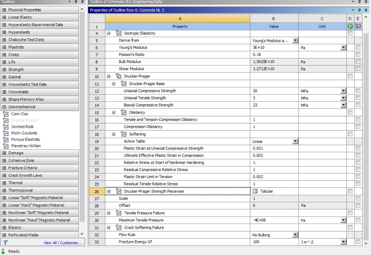

    • jackhero
      Thank you for the references @sujitbhandari. The Drucker Prager model is also available in Engineering Data in workbench.

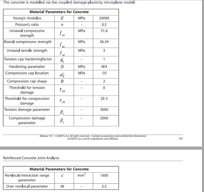

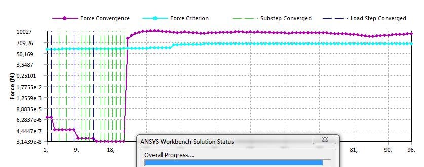

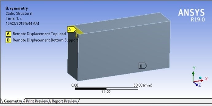

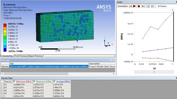

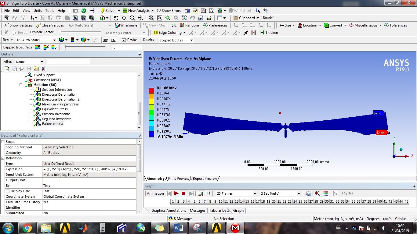

      I designed the symmetry model for three point bending of concrete for non-linear behavior using the microplane model. Experimentally I have the bending test result which I intend to verify using FEA. I calculated the microplane parameters, as was mentioned in the help section by using the tensile test experimental result and calculated some of the parameters via equations. The unknown parameters I kept same as are mentioned in (A gradient enhanced plasticity---damage microplane model for concrete). The boundary conditions are as following;
      Top load is -0.5mm in y direction and all other components and rotations were zero. Whereas, the bottom support have zero in y-component and free for other components and rotations.
      The resulted stress values are too low as shown below;
      I also tried altering other parameters and changing the applied boundary conditions value but the results are almost same. Most of the times the resulting image was not homogeneous, the image was somewhat similar to what @FlaviaGelatti has shown in his post here. Although the resultant values are normal in @FlaviaGelatti attached pdf model but for my case the resultant values are too low and also had the unordinary image of the beam at the end of the simulation. I applied remote displacement as the load on the top whereas i think in @FlaviaGelatti model remote force was applied as a load on top.
      I entered the microplane parameters as following ;
      ET,MATID,215
      KEYO,MATID,18,2
      MP,EX,MATID,25000 ! Define Elasticity Modulus (enter a value for E)
      MP,NUXY,MATID,0.2 ! Define Poisson's ratio
      TB,MPLA,1,,,DPC                    !Define Drucker-Prager
      TBDATA,1,31.368,36.074,3,1,7e4,-24.049   !fuc,fbc,fut,Rt,D,sigVc
      TBDATA,7,2,0,2e-5,5.5e3,3e3         !R,gamt0,gamc0,betat,betac
      TB,MPLA,1,,,NLOCAL
      TBDATA,1,1600,2
      I followed the discussion Remote Displacement - Beam model between @jj77 and @FlaviaGelatti. Although they sort out the issue at the end, but I still can not figure out the problem in my case.
    • sujitbhandari
      Just looking at your code, I think you have made a error in defining MP. I guess, it should be TB,MPLA,MATID,,,DPC and so on. You may want to correct that and have a go. I guess, you are defining the MP model for material 1, which I don't think is what you intended. I am also working on microplane right now, and am not getting the results as expected. Getting the right parameters for your model can be quite tricky, I guess. But, the following papers might have something useful. Have a go:
      Jiang, H., J. Zhao. "Calibration of the Continuous Surface Cap Model for Concrete." Finite Elements in Analysis and Design. 97 (2015)
      Zreid, I., M. Kaliske. "An Implicit Gradient Formulation for Microplane Drucker-Prager Plasticity." International Journal of Plasticity
      But, I am finding it very hard to define parameters for microplane, I have to admit, especially for masonry when you haven't got much data on cyclic loading.
      That's all I could help for now. Best wishes,

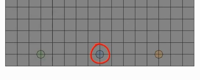

      1) Solid65 Model
      There are some recommendations on the Solid65 model that are interesting.
      - Mesh: The external nodes (corner nodes) of the hex elements must superimpose the nodes of the beam elements (used to model the steel reinforcement). This guarantee that the deformations of steel and concrete are compatible.

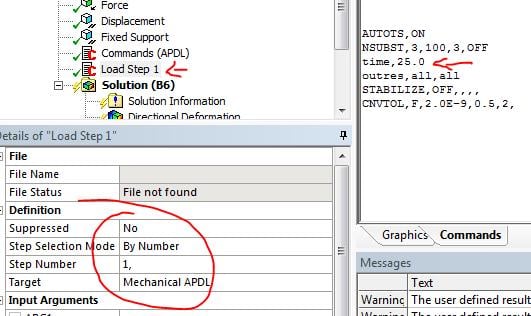

      - Solution Control: Here we have the APDL commands to controls Solid65 model solution. Most of these commands you guys probably know, and they are easy to find in the online documentation.
      NLGEOM,OFF
      SOLCONTROL,ON,OFF,NOPL
      NROPT,UNSYM !Here we set the Newton-Raphson as unsymmetric option. This option is good to help convergence, because the cracking create matrix asymmetry.
      PRED,OFF,,OFF
      LNSRCH,OFF
      NEQIT,100
      KBC,0
      cutcontrol,plslimit,0.2
      cutcontrol,cutbackfactor,0.25
      cutcontrol,noshape,1
      SHPP,WARN
      pirchek,off
      - Equation Solver Control: These are the APDL commands to solve the system equation.
      EQSLV,SPARSE,1.0E-8,3.0,,
      BCSOPTION,,INCORE,16000,,,OFF
      - Output Control and Convergence criteria: There commands define de number of substeps and the convergence control. There are 2 load steps, so there are 2 APDL commands – one for each load step. It is also important in the window Details of each APDL go in Step Selection Mode and chose “by Number”, and then in Step Number “1” for load step 1 and “2” for load step 2.
      Load Step 1:
      AUTOTS,ON
      NSUBST,3,100,3,OFF
      time,25.0
      outres,all,all
      STABILIZE,OFF,,,,
      CNVTOL,F,2.0E-9,0.5,2,
      Load Step 2:
      AUTOTS,ON
      NSUBST,20,1000,20,OFF
      time,35.0
      outres,all,all
      STABILIZE,OFF,,,,
      CNVTOL,F,,0.5,2,1.0E-3

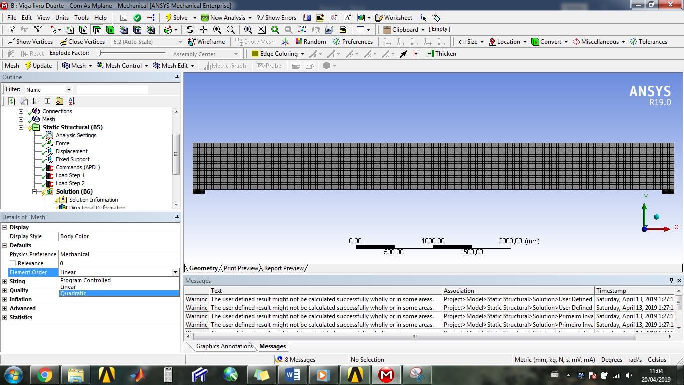

      - Mesh: Microplane support quadratic behavior of elements, this means that in Mesh you can use the quadratic option in Element Order. This one of the best advantages of Microplane model.
      - Solution Control: Now we use full Newton-Raphson. Before we had “nropt,unsym” and now we have “nropt,full”. This is because the Microplane model is a Damage Model with matrix symmetry, and the failure is considered in a much more elegante way than the abrupt way of WW in Solid65.

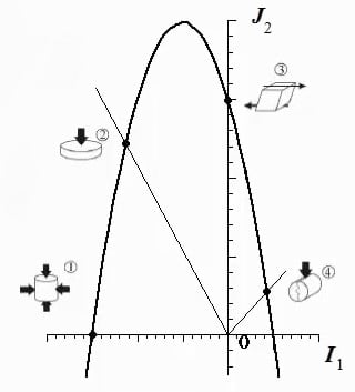

      Now the great difference comes in use of the constitutive model. A great difficulty in the use of the Microplane model comes from the fact that its parameters does not correspond directly to any mechanical characteristic or material resistance. They are numerical parameters of a numerical model.
      It’s convenient to remember that the Mplane is coupled with a Isotropic Damage Model [1], so some of the parameters are necessary to define what is called a Damage Function – a function responsible for representation of the damage on the material (i.e. cracking). The 3 parameters are γ, α and β, and they define when the damage begin, how it will evolve and how much damage the material can stand.
      As for the rest of the parameters, it’s also convenient to know that the Damage Function must be written in terms of Equivalent Strain, which is a function of the Invariants of the Strain Tensor (I1 and J2), and this Equivalent Strain is a scalar measure that controls de damage. There are many ways to define this E.S., but here is used the modified Von Mises definition:
      This Isotropic Damage Model does not take into account the different behavior of concrete under tension and compression. So the K0, K1 and K2 parameters are the result of the adaptation of the model to the different response of the material under tension and compression [2]. k is a model parameter that sets the ratio between the uniaxial compressive strength fc and uniaxial tensile strength ft.
      After all these brief comments, it’s interesting to note that the experimental data are important to define the input data of the Microplane model. Four experimental data of the concrete correspond to four point in a graph, the surface created is the limit of the elastic domain, beyond this limit we have a damage in the material. The trick is to correspond the experimental data with the graph domain.

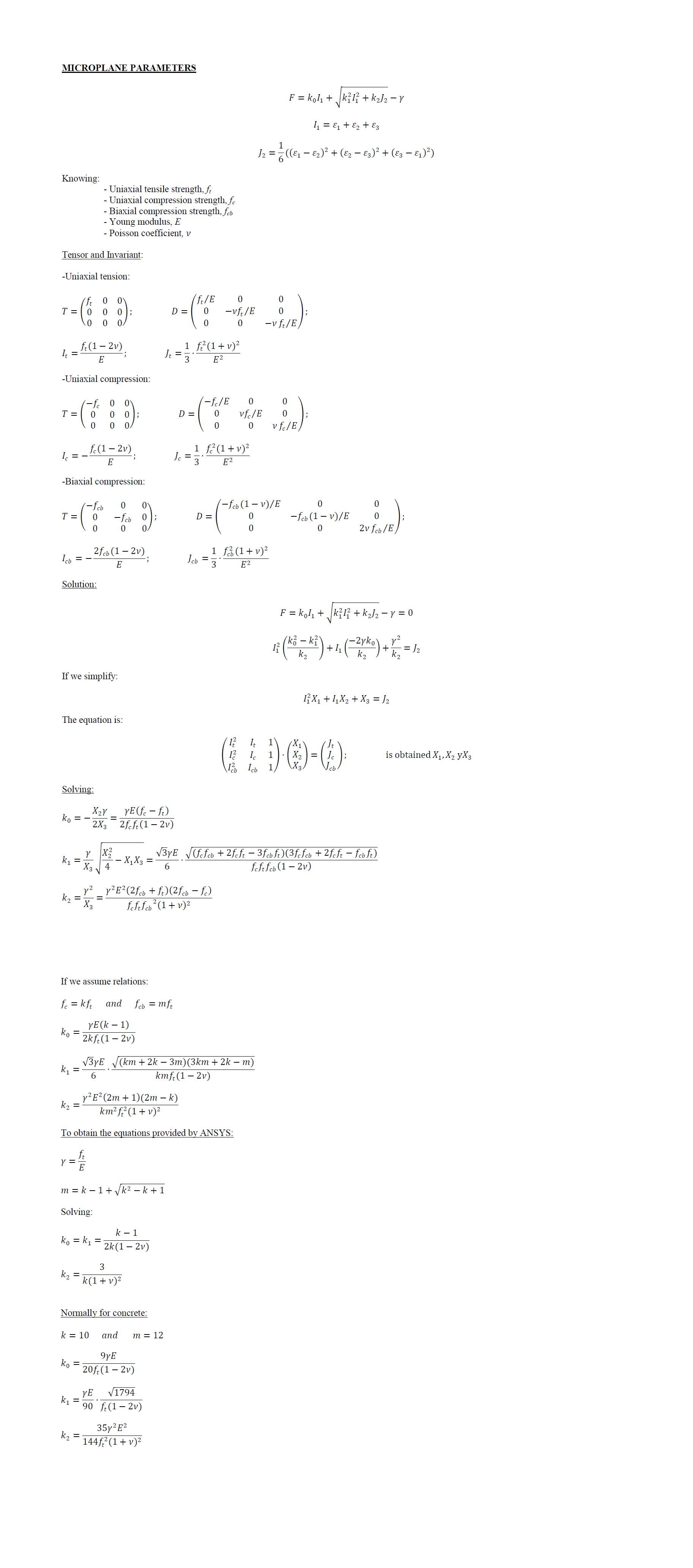

      - Microplane parameters values: There are 6 parameters to be defined. The 3 parameters related to the Equivalent Strain can be calculated using experimental data as input values (see the video and the Excel worksheet). The other 3 parameters are related to the Damage Function, and they must be adjusted according with each problem.
      Now, you can define the k0, k1 and k2 with simple equations:
      But they will provide slightly different values for the parameters. They can be used if you don’t have all the experimental data.
      - Viewing the damage: Although with Microplane/Solid185 you can’t see the cracking and crushing of the material, you can insert a User Defined Result under the Solution branch. The Expression must the Damage Criteria:
      And it should look like this:
      So you can see the elements that suffer with an Equivalent Strain greater than the Îł (Critical Equivalent strain energy), or the value that correspond to the beginning of damage.
      Note that there are 3 User Defined Result, one for the First Invariant I1, one for the Second Deviatoric Invariant J2 and one for the failure criteria itself (see figure above).
      References for the theory:
      [1] – HOFSTETTER and MESCHKE. NUMERICAL MODELING OF CONCRETE CRACKING. 2011
      [2] - Groot et al. Failure stress criteria for composite resin. 1987
      I hope this can help
      Regards
      Flávia

    • Yato
      I did a small study to obtain the microplane parameters. In case someone helps:
      Parameters microplane

      Is there a way to view the damage using APDL language?
    • FlaviaGelatti
      Hi, Antony
      I don't think so.
      The damage shown in the picture of the beam (the not visible elements ) is a result of a failure criteria defined on the WB interface by the User. I tried to export the APDL file of the structure (Tools > Write Input File)  to check if Ansys would transcript the criteria to APDL language, but he ignores it.
      I didn't explore it, but maybe you can try the coding below. It uses a FAIL criteria and you can write in APDL. This print is from the book Finite Element Analysis of Composite Materials Using ANSYS® by Ever J. Barbero

    • FlaviaGelatti
      Hi
      There is no way my model with Beam188 can converge. I checked and our commands are the same.
      The result of the solver looks like this, and It looks to me that both elements (solid65 and Beam188) are not working together when the nonllinearity begins. I don't know if that is the result you are getting... But if I were to guess, I think we should be using the Table Points to define the nonlinear behavior of the concrete (concrete 2 APDL of the tutortial).
      I created the model with solid185 and link180 to, and the results are much more stable.
