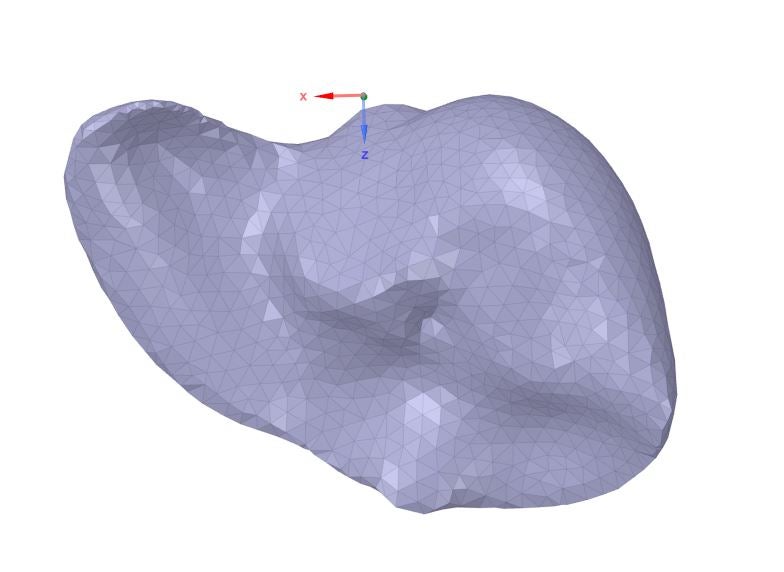

SubscriberI'm working on an irregular object and implementing a kinematic mount. Due to the irregular shape of the object the nodes don't fall on the plane. Is there a way to ensure the mesh nodes are created on the plane (and the surface of the body - check image for reference)
I came across something called hard point but can't find any concrete implementation method online. Can this be used for the problem I'm trying to solve - If so, then how?

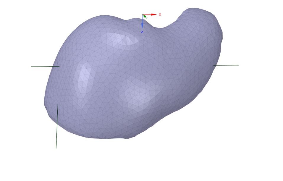

To elaborate on my problem - the object I'm working on is a STL file of an organ (image below). To implement the kinematic constraint I can need to give certain displacement constraints at a few nodes. These nodes are located depending on the way the mesh is created. Since I can only select nodes on the surface of the object - the likely hood that the points would form a 90-degree L-shape (rules of kinematic constraint) is highly unlikely. I tried to use the "skin surface" option on SpaceClaim to get split the entire object into 2 halves based on the lines drawn but no luck there (see image 2 - the lines are perpendicular and almost meet at the surface of the organ)
Is it possible to create a few points/nodes on the surface of the object about which the mesh is created?

Were you successful obtaining a skinned surface? That generally consists of more than one face. Please show that.

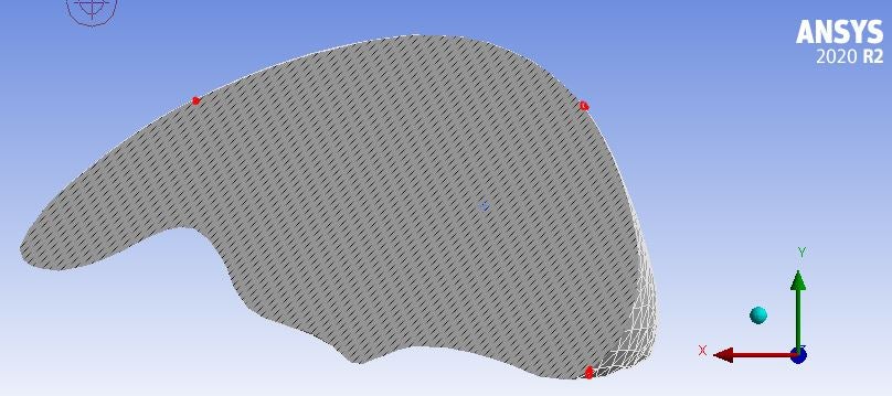

Regarding my implementation kinematic constraint: For example - Right now if I choose 3 non-colinear points as close to the XY plane (I can't get them to be exactly on the plane since the mesh won't create a node there exactly) there is a chance of artificial strain created due to the constraint-location mismatch i.e. if I give 0 displacement in Y and Z but the point is not exactly on the X axis w.r.t to the fixed point. I believe the easier option is to create a new coordinate system based on the 3 points selected and apply kinematic constraint based on the new coordinate system - this ensures "prefect" alignment. The same kinematic constraint will be implemented but in new directions. However, I don't know if it's possible - is it?
Regarding skinned surface - This method didn't work as I expected it to. I closed the sketch but it never created a new surface. Moreover, I'm not sure how this would be beneficial to what I'm trying to do.

SubscriberPick any three points on the body that are well separated, they define their own plane. The points don't have to be in the global XY plane. In the figure below, the point C does not have to be in any particular relationship to points A and B other that it can't be on the line AB. Point C can be anywhere. Create a local coordinate system using those three points. Point A is the origin, Point B is on the X axis and Point C defines the XY plane.
From thisreference. Figure 4 shows a 3-2-1 kinematic mount. The three constraints at point A prevent translations in X, Y, and Z, but do not preclude rotations about A. The additional constraints at B prevent rotations about Z and Y, and the constraint at C prevents rotations about X.
If the mounted object were to change its dimensions, due to differential thermal contraction with the base, or small machining errors, for example, point A would remain fixed, and points B and C would move freely towards or away from A along their unconstrained directions. It is this allowed free motion which is the key to making a mount kinematic. If another constraint were added, for example an additional X direction constraint at B, then the distance between points A and B would be fixed, and a dimension change in the object would produce a stress.
