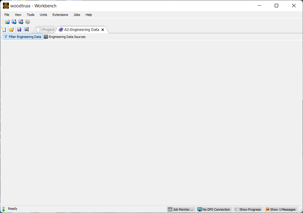

SubscriberDouble clicked or chose right click/edit on Engineering Data in Project Schematic. The Engineering Data tab is empty, with Toolbox and Outline and related subpanels all missing.

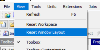

SubscriberAshish Reset Window Layout after clicking to edit Engineering Data did the trick. Thank you very much.
