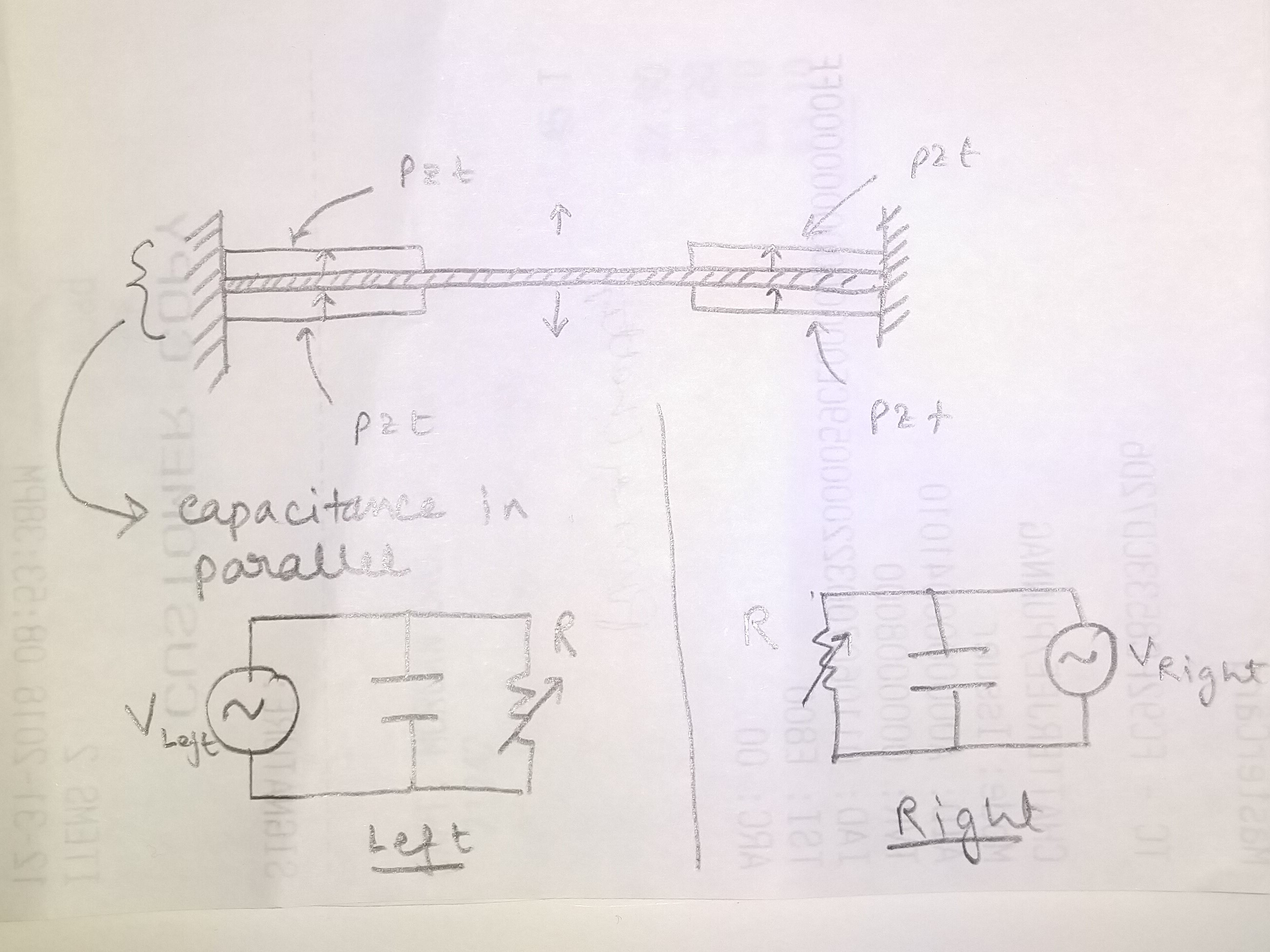

      I am trying to perform a nonlinear(large deformations)-structural transient analysis of a clamped-clamped beam with piezoelectric bimorphs on each of the clamped ends, for my university research. I have recently downloaded the MEMS ACT module.
      I am exciting the entire system with an acceleration [A*sin(wt)similar to base excitation]. So, potentially this excitation should result in the mechanical vibration of the system and an open circuit voltage development across the piezoelectric patches which I wish to tabulate as a function of time (attached schematic). However, I am finding it difficult to set it up in ANSYS workbench. There seems to be dearth of examples in the internet. Any help or pointing me towards examples would be very helpful.
      I have attached my project here, where I am able to extract the deformation/deflection of the system due to the imposed acceleration. However, I am unable to figure out how to extract the time vs voltage information across the bimorphs at either clamped ends.
      P.S. Any ideas of how to incorporate a resistor across the bimorphs and measure voltage across it would be greatly appreciated.

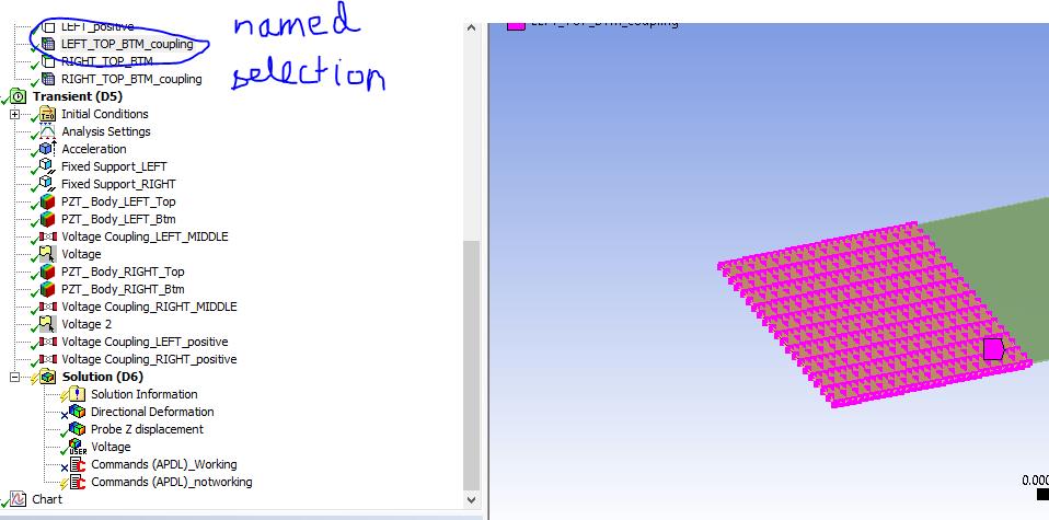

      Thanks for your direction to the link. I have been able to make the workbech model with PZT patches. However, I have run into a problem where I am trying to write a command snippet to write the cumulative voltage data to a text file.
      I have already been able to write a table where the rows are the time steps (transient analysis) and the column 1  is the time stamp, column 2 is the Z displacement and column 3 is the sum of the nodal voltages.
      I have a named selection of the mesh nodes whose voltage I want to be summed up at every time step. Snapshot below.

    • Punnag Chatterjee
      I have figured this out myself. Below is the complete/working command snippet.
      set,last
      *get, nsets,active,0,set,nset                                         !get the array/vector size from the 'last' time step index
      *dim, data_store,,nsets,3                                              !preallocate memory for creating a matrix/table of size (Row x column) = nsets x 3
      *get,ncount,node,LEFT_TOP_BTM_coupling,count    !get the array/vector size for the mesh node named selection 'LEFT_TOP_BTM_coupling'
      *dim, volt_nodes,,ncount,1                                           !used to save nodes No.
      *do,i,1,nsets
       set,nextnode
       *get,t,active,,set,time                    ! getting the current 'time' step and storing it in variable 't'
       data_store(i,1) = t                         ! storing this 'time' value in the 1st column of the matrix/table
       cmsel,s,Probe_pt                          ! selecting 'Probe_pt', which is a nodal point selected on the surface (after meshing) and is a named selection
       *get,node_id,node,0,num,max     ! getting the node id for the nodal point 'Probe_pt'
       *get,displ,node,node_id,UZ          ! Z displacement (UZ) at the nodal point 'Probe_pt'
       data_store(i,2) = displ                   ! storing this UZ value in the 2nd column of the matrix/table
       cmsel,s,LEFT_positive_coupling           ! selecting named selection 'LEFT_positive_coupling' which has mesh nodes
       *get,volt_node_id,node,0,num,max       ! selecting the mesh node id which has the highest value(could be any node within the selection)
       *get,nodal_volt,node,volt_node_id,volt  ! storing the voltage value from the selected node 'volt_node_id'
       data_store(i,3) = nodal_volt                   ! storing this voltage value in the 3rd column of the matrix/table
      *enddo
      *cfopen,Table_20_Hz,txt                                                      !name of output text file is 'Table_20_Hz.txt'
      *vwrite,data_store(1,1), data_store(1,2), data_store(1,3)
      %g,%g,%g
      *cfclos
      P.S. I have realized that in order to extract the open circuit (OC) voltage data from the Left piezo bimorph patch, I just need to track the nodal voltage of any one of the nodes within the named selection 'LEFT_TOP_BTM_coupling' and I DO NOT have to perform a summation of the voltages of all the nodes within this selection.

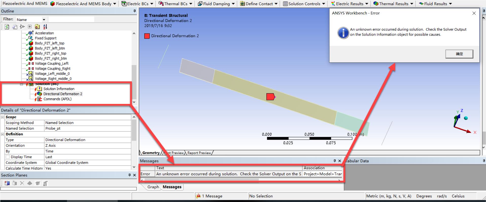

    • HeMeng
      Hi Punnag Chatterjee,
      I still can't solve the problem. The error result is as follows:
    • Punnag Chatterjee
      Hey, I have attached another file to my previous post (Workbench 18.1) give that a try and let me know.
    • Guoyang
      Hi, I have met this problem as well, have you solved it ?
    • HeMeng
      Hey, please find attached the 19.1 WB project file. Let me know if that resolves the issue.
      I still have problem. Can you write a word or ppt  step by step?
