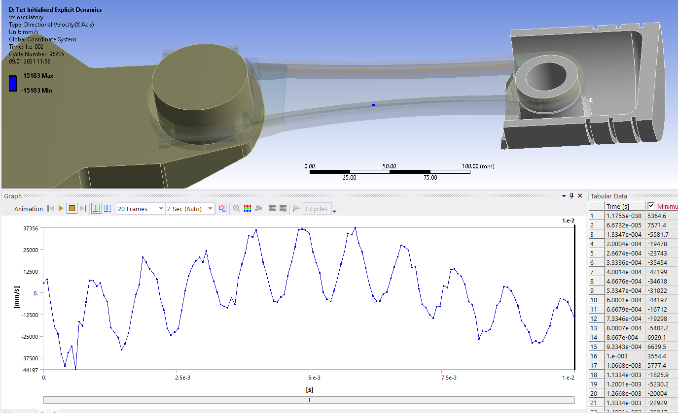

      I remeshed the model with Tet elements. To my suprise, the miniumum quality improved from 0.30 to 0.36. There is no hourglass energy now. I was taught that tetra is a trash element and can be used only as a filler. Am I mistaken ?.Anyway, the problem of oscillatory motion persists. It appeared when I changed the Maximum Offset to 0.2mm in the two bonded contacts (threads), because some elements on the thread were not involved in the contact, they were not detected. This Maximum Offset seems to be essential for proper contact enforcement.nArrayI thought the problem could be due to the other frictional contacts, however everything looks fine there, friction coefficient set to 0.05.nBoth the piston head and the crankshaft move smoothly, without oscillating.nAny ideas?n

      ArraynI took my time to (correctly I hope) initialise the case. Please take a look at that. These values were extracted from a Rigid Dynamics analysis, but that's the best we can do. The main coordinate system is placed in the same place and orientation in both RD and ED analyses.nWe start the simulation while the piston head is in the Top Dead Centre. The crankshaft rotatates counterclockwise, as can be seen on the last screenshot.nnThe real question is: why it worked previously but now it doesn't? In both cases, the bonded contact glued the two interfaces together, the only difference was that previously the glue was not distribued along the whole circumference (theta direction) of the thread.nnI'd be grateful if you could take a look at my project and see what could've gone wrong. Please find it attached below.nArrayn
    • bobsik641
      Array if you have any ideas, don't hesitate to share them with me nnI don't really know if there's any way of damping out this single frequency?nnIt's even more noticeable when the velocity is displayed.nnn
