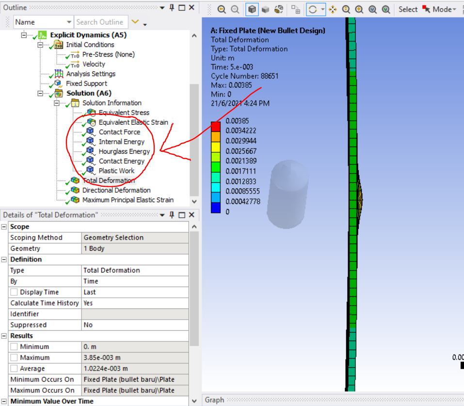

SubscriberWhich of this following results in the figure below is referring to Absorption Energy ?

To give you a quick answer I'll reiterate Sandeep's comment:
"In an ideal situation, All of the kinetic energy of the hammer should be transferred to the potential energy. Please look at the internal energy.
Internal energy is nothing but energy stored in bodies due to deformation. This includes both Plastic Work (material model) and Hourglass Energies (reduced order elements).
Useful section from the Help: Section 1 and Section 2 "
