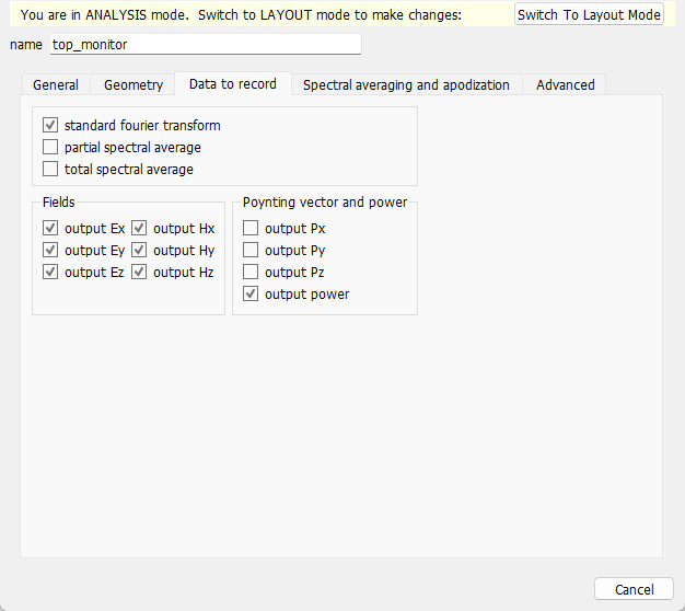

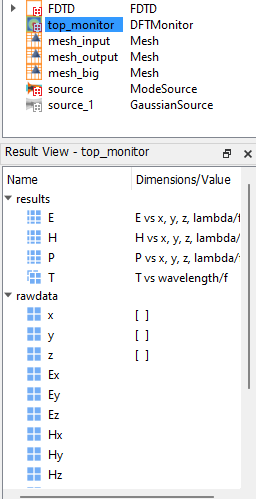

      I am very excited to see the newest Lumerical FDTD support GPU computation, which really speeds up the simulation process. However, after running the simulation, there is nothing in the DFT monitor. I cannot visualize the E field or other results.
      Would someone help me with this issue?
      Thank you very much!

    • h.senyue
      Hi, we figured it out finally. The name of the Lumerical file should not start with numbers. After I rename my file, I can see the saved results. I think this is a bug in the software backend.
    • Guilin Sun
      Thank you for this. Usually such file name should not be able to be saved.
