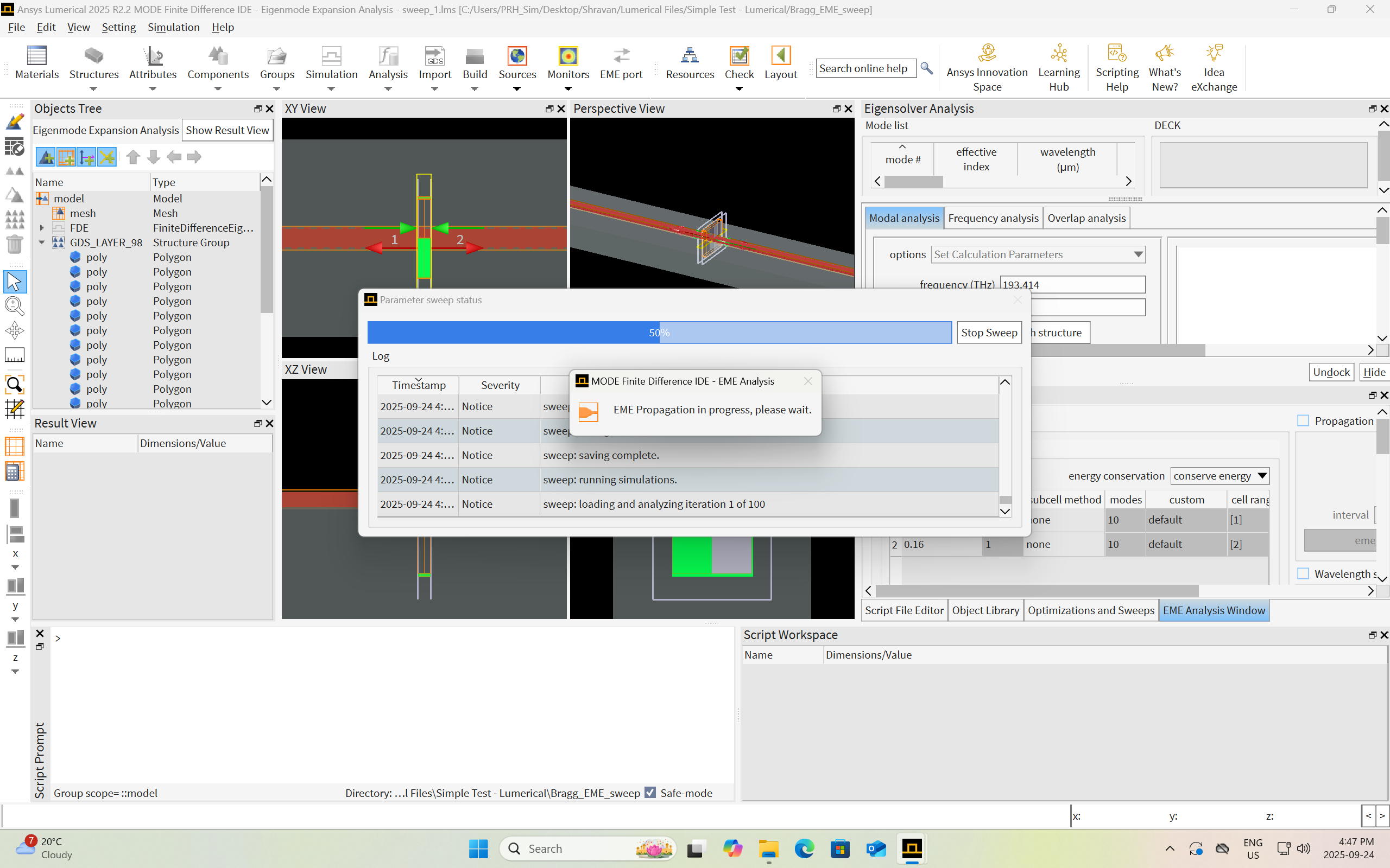

    • shravankruthick.sridhar
      Hi Lito,
      I tried what the simple Bragg grating example, and I’ve been seeing the following message with the status stuck at “loading and analyzing iteration 1 of 100” for over an hour. For reference, all 100 wavelength points finished simulating in 5 minutes, and the “EME propagation in progress” message does not show up in version 24.2.
      Edit: I let it run for 5+ hours and it was still stuck on the exact same screen as shown.

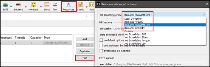

    • Lito
      Sorry, as mentioned we were unable to reproduce the issue on any of our machines. We can run the example simulation/sweep to completion as per the screenshot below.
      • Are you running third party antivirus/security software on your PCs? This could affect when running simulations with MPI.
      • Have you tried the options on my previous post/message?
      • Delete the MODE Solutions.ini file before running the sweeps/simulation? This is important especially if you are running/switching between different versions of Lumerical.
        • del %AppData%\Lumerical\"MODE Solutions.ini"
      • Try to run using "Local Computer" as the 'Job launching preset' or a different MPI as mentioned in the Knowledge Base (KB) FAQ >> Fixing Lumerical engine or run time errors – Ansys Optics
      Hi Lito,
      Thanks for the reply.
      I'm no longer facing the 0xc0000409 exit code error, and the Job Manager says that all 100 simulations run to completion, but Lumerical still gets stuck on the "EME propagation in progress" after this, when the Job Manager window closes and the "Parameter sweep status" window updates itself with "loading and analyzing iteration 1 of 100" (as shown on my previous reply's screenshot). As per your suggestions, I did all of the following before attempting to re-run the example:
      1. deleted %AppData%\Lumerical\MODE Solutions.ini
      2. rebooted my computer
      3. disabled the antivirus (Windows' default - Microsoft Defender)
      4. Switched to "Local Computer" for the "Job Launching Preset"
      After all these attempts, Lumerical still gets stuck at "EME propagation in progress" screen.
