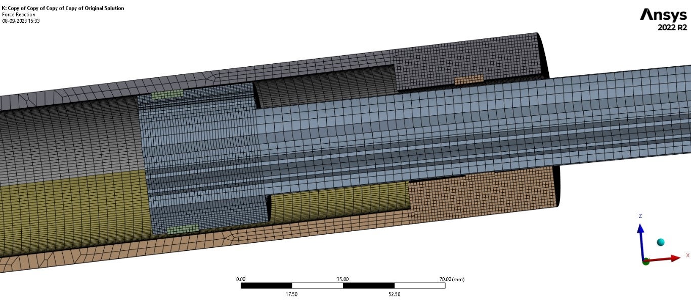

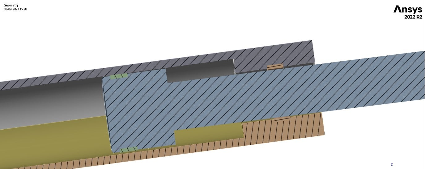

      An "element distortion error" is appeared in solver output when I am trying to solve large deformation problem of hydraulic cylinder (Nonlinear buckling) by introducing geometry and material nonlinearity in the static structure analysis. I have taken two different material in the analysis, one is polyamide for guide ring and other is steel (Structural) for rod and cylinder. The Isotropic material hardening properties are taken for the analysis.

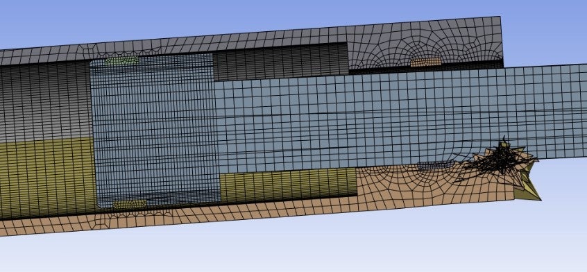

      When the rod is coming in contact with guide rings and gland of cylinder, the element becomes distorted every time.

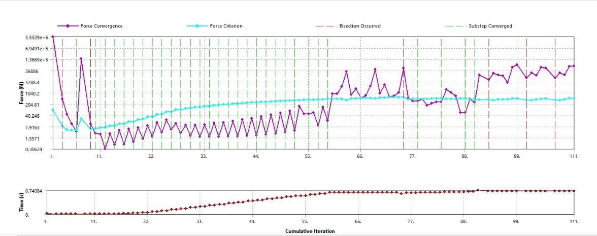

      I am unable to obtain the convergence.
      Can anyone please help me to get the solution?

      I have also tried to get best meshing quality, eventhough i am not getting the converged solution.

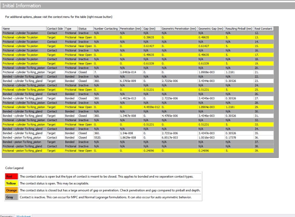

      Try using linear elements with a direct solver and make sure that your contact and target side are correctly selected.

      Here is one more problem arising i.e. penetration between two bodies, but i removed that problem by selecting the frictional conatct with contact treatment "Adjust to touch" option. (Does contact status also create element distortion? because I think there may be some mistake I am doing)

      You will need more details to correctly model the material which you are using.  Also, can you share the screenshot of the contact settings you are using? High penetration or continuous change in contact status(chattering) can create issues.

      Yes, I always recieve a warning of aprupt contact changes.
      "Contact element 569863 (real ID 15) status changes abruptly from no-contact -> contact (with target element 540864)."
      "Contact element 684247 (real ID 34) status changes abruptly from contact (with target element 685459) -> no-contact."
