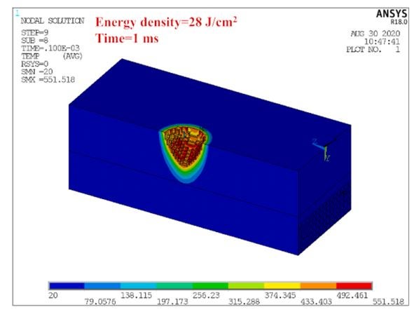

SubscriberWhat I want to do is this:
I have 3 different materials together with CFRP, epoxy resin and paint. There is resin on CFRP and paint on them. It is desired to apply 7,14,21,28,35 and 42 W energy with laser cleaning. This will also be simulated with the element death method. Modeling needs to be done via APDL. With the given laser energy, the paint on the surface will be removed. I will use this work in my doctoral study. But how can it be done? I do not know this. I would be very happy if you could help with this. In addition, I have mechanical properties related to 3 different materials. But I don't know how I can use some data. -

Ansys Employeehasanilkerceliker The link that Erik provided above shows how to do this, generally speaking, in MAPDL. There is one big thing to keep in mind: when running MAPDL in SMP parallel mode the results are kept in memory, while in DMP parallel they are not (until read in with the SET command during post processing).
So let's say your criteria for killing the elements is "A" (you've not yet defined that). Then some psuedo APDL to solve this would be:
/solu
*do,... loop over time in some time increments
apply load
solve
select nodes that meet "A", then elements attached to those selected nodes. Maybe unselect from this set the nodes/elements that have loads or boundary conditions applied if needed.
ekill elements
select everything
*enddo....close do loop
The node selection can be by result if running SMP parallel. Test out a simple model that uses same physics.

SubscriberNormally I have to give the laser intensity with the adiabatic boundary conditions and the formula you see in the picture. So where am I doing wrong?
/soluÂALPHAP=89000Âq=((2*(1-RP)*ALPHAP*EXP(-ALPHAP*Y)*EP*(-T^2/TAU^2))*(((-2*(X^2)+(Z^2))/RB^2))/(TAU*PI*RB^2)Â*do,ÂÂapply loadÂsolveÂekill elementsÂselect everythingÂ*enddo....close do loop
