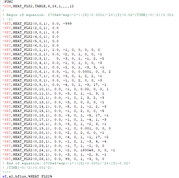

SubscriberHello, I am a doctoral student and one part of my dissertation thesis is to simulate LBW. For simulation I am using ANSYS 2021 R1 and for providing laser beam I am using commands from APDL console (image below). When I simulate processes and ANSYS solve it, there are temperatures above melting temperature (which is correct and fine) and also temperatures above vapouring temperature of the material (which is not correct). I am looking for a solution how  to turn off/kill nodes, which reaches temperatures above 2500 °C. This solution should solve problem to create keyhole welding. There are a few major problems. Since I am doing it in one continuous step - I cannot do it by elements birth and death provided by ANSYS - because it would turn it on/off for whole step. So It had to be performed simultaneously by movement of the laser beam. Every help would be appreciated.ÂThanks in advance!ÂMartin Hnilica -

My concern about using EKILL to deactivate elements whose temperature exceed 2500 C is that when elements are deactivated, the element loads applied to them are "zeroed out of the load vector". I'm pretty sure this includes surface heat flux loads. So if you deactivate elements on the surface where the heat flux is applied, some (possibly much or even all) of the net heat flux applied to the surface will no longer be applied to the model. This may be inconsistent with what actually happens in the physical system.
Have you defined an enthalpy material property? We use this to represent the latent heat associated with phase change. When one defines enthalpy, density and specific heat material properties are no longer used (the enthalpy material property replaces their combined effect of storing heat).
You could have two step (actually steep ramp) changes in enthalpy with temperature: one associated with transition from solid to liquid at the melting temperature and one associated with the transition from liquid to gas at the vaporization temperature. If you do this, your analysis might not predict such high temperatures, and if you don't deactivate elements, the net heat applied to the model will not be artificially reduced.

One other thing is that in ANSYS, enthalpy is defined in units of Joule/m^3, whereas outside of the ANSYS world, I always see latent heat defined in units of Joule/kg. As simple as it may seem, it can be easy to make a mistake in the conversion.
I hope this is helpful.
