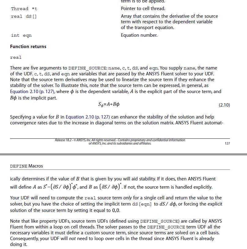

      Thanks Karthik, that could be a solution for my problem. Just two more question, how can I linearized those source terms? and wich macro I need to use for my UDF?
    • Karthik Remella
      Administrator
      Please have a look at the following screenshot from the Fluent Customization Manual I am embedding here. This is in the section on DEFINE_SOURCE in the manual, which is the UDF macro you will be using to define source terms in Fluent. This screenshot briefly discusses on source term linearization.
      I hope this helps.
