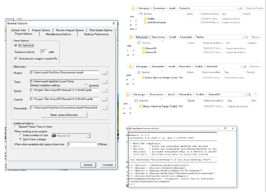

      I have some problems with the Electric Machines Design Toolkit - R16 installation. I followed de instruction in page 16 and 17 of the pdf. and after installation process I followed the open process described in pages 11 and 12. But when I try to define "User Defined Outputs" the probes window is empty and the following error appears:
      *Global - Messages
        [error] MissingMemberException: 'ADispatchWrapper' object has no attribute 'GetCoreLossEffectOnField'  Method: "_GetDesignProp" In file "C:Program FilesAnsysEMMaxwell16.0Win64syslibUserDefinedOutputsElectric Machines Solutions - R16Average and RMS Solutions.py", line 1033 ---- While calling "GetInputUDSParams(...)" on UDOExtension in "C:Program FilesAnsysEMMaxwell16.0Win64syslibUserDefinedOutputsElectric Machines Solutions - R16/Average and RMS Solutions.py"
      BLDC1.5KW (CUsers/yesid/OneDrive/Documentos/Ansoft/DoctoradoTEST/)
        [info] User Defined Primitive: SpanExt is modified from 0.1 to 31.7805 (2:02:50 p. m.  ene. 08, 2019)
      Also, if I try to run the toolkit this error appears: (But it could be caused because the user outputs have not been defined)
      "*Global - Messages
        [error] MissingMemberException: 'IDispatch' object has no attribute 'GetUserDefinedSolutionNames'  In file "CProgram Files/AnsysEM/Maxwell16.0/Win64/syslib/Toolkits/Maxwell2D/Electric Machines Design Toolkit - R16/Electric Machines Design Toolkit.py", line 11578 ---- While executing script: CProgram Files/AnsysEM/Maxwell16.0/Win64/syslib/Toolkits/Maxwell2D/Electric Machines Design Toolkit - R16/Electric Machines Design Toolkit.py"
      Please, I need help with this... I am using ANSYS Maxwell 16.0.2 over a PC i5 with Windows 10. I already tried with two versions of the toolkit.

    • Yesid901208bc
      I put it there because in my Win64 folder there is not any Maxwell folder:
      :S !!!

    • Yesid901208bc
      Good morning,
      I checked the folders, I didn't find something wrong.
      I placed the Toolkit and the UserDefinedOutputs in userlib and I tried to define "User Defined Outputs" with right click over "Maxwell2DDesign/Results/Create user defined solution/ElectricMachinesSolution - 16/Average and RMS solutions". I also tried to run the toolkit clicking over "Maxwell2D/Toolkit/Electric Design Machine Toolkit - 16/Electric machine design toolkit" but the errors mentioned in the first post apeared.
      I repeat the process but in the syslib and Personallib but the result was the same.
      When I tried to run the commands on the command window, the last command send me an error. "MissingMemberException: 'IDispatch' object has no attribute 'GetUserDefinedSolutionNames'".
      I'm going to send a PDF showing the results into a graphic way.
    • Yesid901208bc
      Here, the results previously explained are presented.Please... Help me..
    • mbeliaev
       the quality of image is very bad. but it seems that python throws you an error.
      Unfortunately it is very very old version of Maxwell and it is difficult to say what exactly is wrong. But from here I see that this commands are unsupported in this version.
      Please update to recent one version. In this version toolkit is preinstalled as ACT extension.

    • Yesid901208bc
      I apologize for the image quality, I didn't find how to upload a PDF. However, the text written in the post before the image describes the content of the image. I don't have a customer account, I just have a student software then I do not know how to login in the link you send me.
      https://support.ansys.com/AnsysCustomerPortal/en_us/Downloads/Current+Release
      But I can request the newest version to the laboratory. The version which has the Toolkit preinstalled is 19.0?
    • ANSYS_MMadore
      Yes, it's included with 19.0, also with 19.1 and 19.2.
