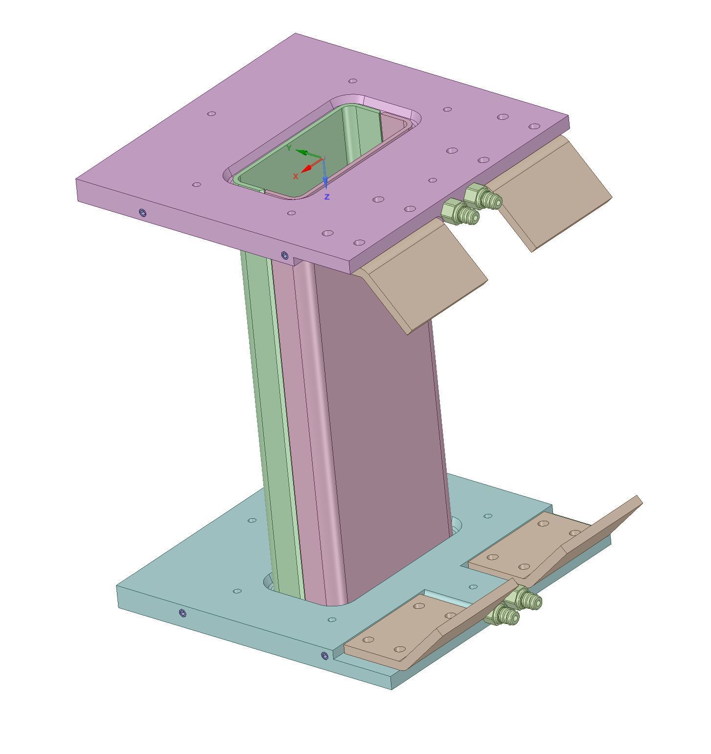

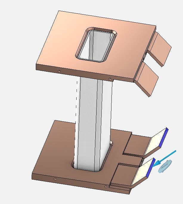

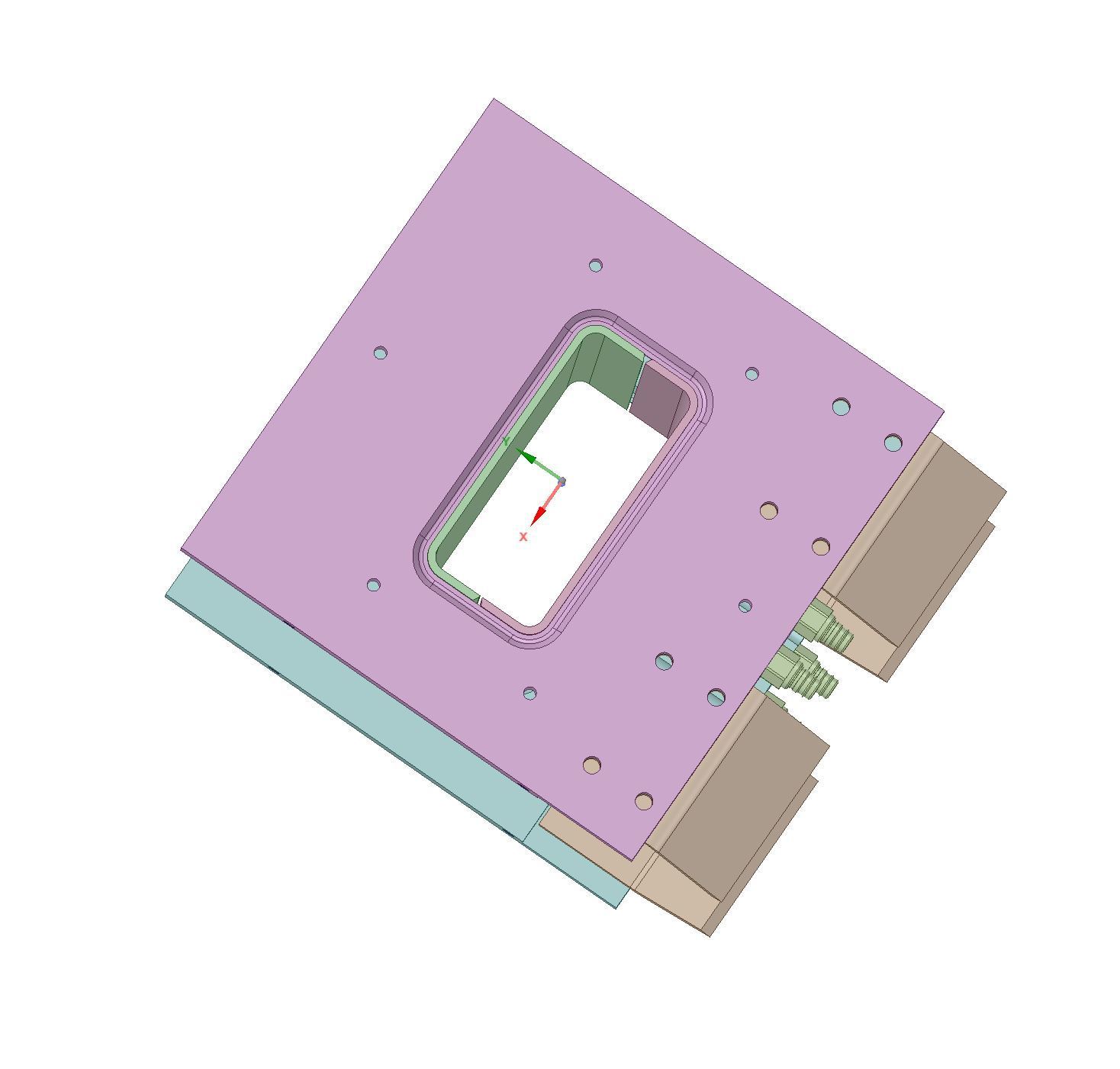

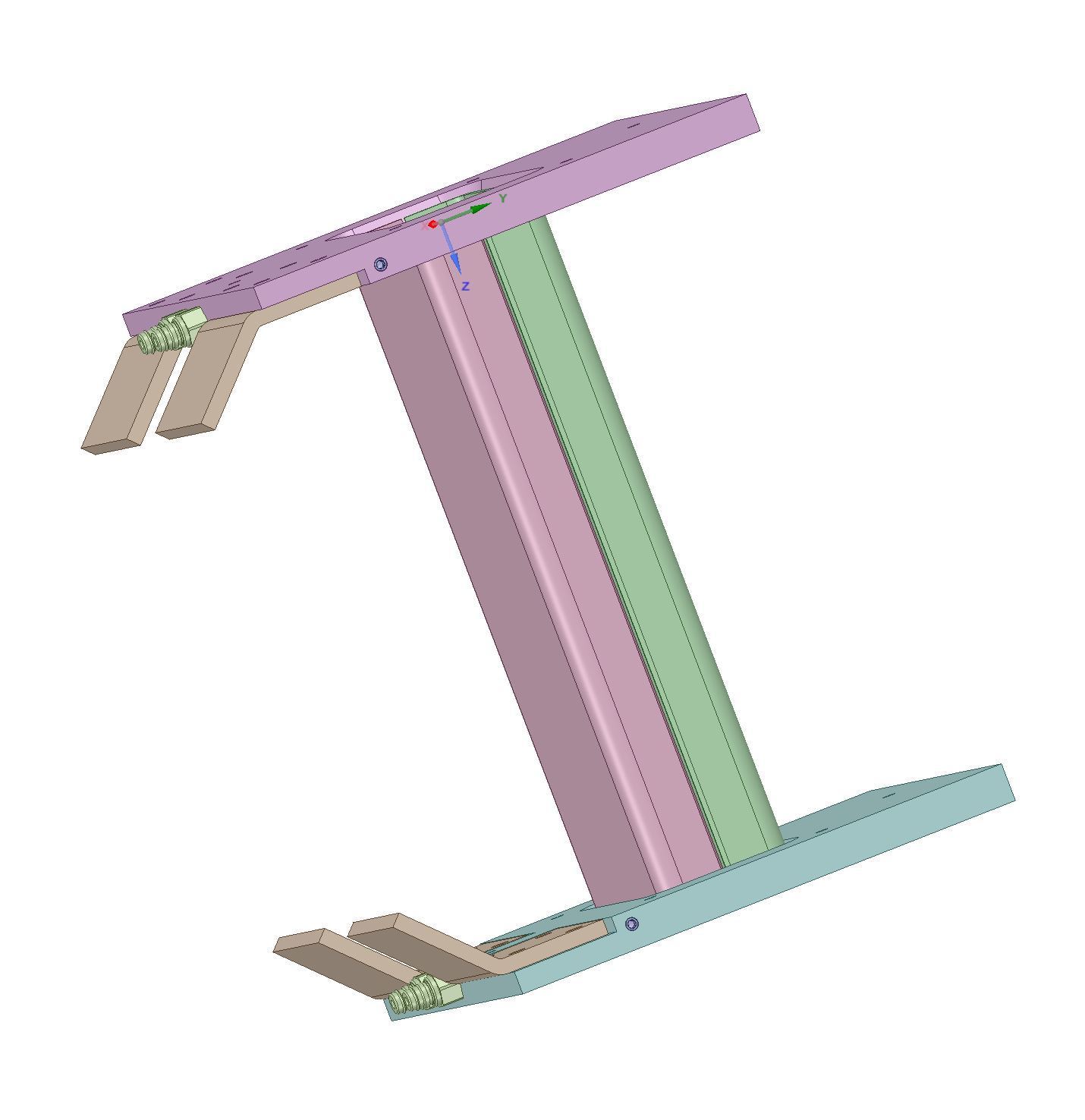

      Dear all,
      The following are the images of my product. The top and bottom are two copper plates and the four bent attachments are the electrical contacts and in the middle, there is a pipe which we want to heat.
      The problem description is as follows :
      Electrical heating: Current supplied: 6kA
                                       The voltage supplied: 2V
                                       Initial temperature: Room temperature.
      The two copper flanges are water-cooled (water cooling is neglected for now).
      I want to determine the temperature distribution on the middle pipe, due to electrical heating.
      I am not sure where I should give the voltage and current values while doing the simulation. Since it is not possible to give two conditions for a single face.
      What are the other boundary conditions I should give to simulate the problem?
      I am using Ansys AIM 2019 R1, a Thermal model with Electrical conduction. If I am able to give the boundary conditions in proper place I will be able to get the results and proceed further with my design optimization.
      It would be really helpful if someone could help me out simulating this problem.

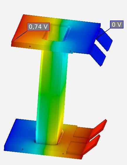

        Naresh Patre
        I gave the RMS Current value (after considering the losses) of 3285A as shown in the image above.
        I splitted the RMS Voltage of 1.48 V into two. I gave 0V to one end face of the bottom plate and 0.74V to the other end face of the bottom plate. I gave 0V and 0.74V to the top plate but in the opposite faces, as shown in figure below
        When I use this boundary condition, (i.e. I converted the AC current and voltage, to DC equivalent by considering the RMS values of current and voltage.), the temperature at the center pipe is around 1000°C, which seems good.
        But now I have a question, Are my boundary conditions correct? Does it make sense to split and give the voltage values like this? Is the total potential of 1.48V applied to the model?
        The answers looks promising, but I want to make sure that the boundary conditions are correct/making some sense.

    • Naresh Patre
      Hello Selva prakash
      Using either the RMS voltage or the RMS current should work for this case, but you should apply either a potential difference (0V and 0.74V) or apply the RMS current at one terminal (3285 A) and ground (0V) the other terminal.  If you apply both the current and the voltage to the same surface, the voltage boundary condition will override the applied current.
